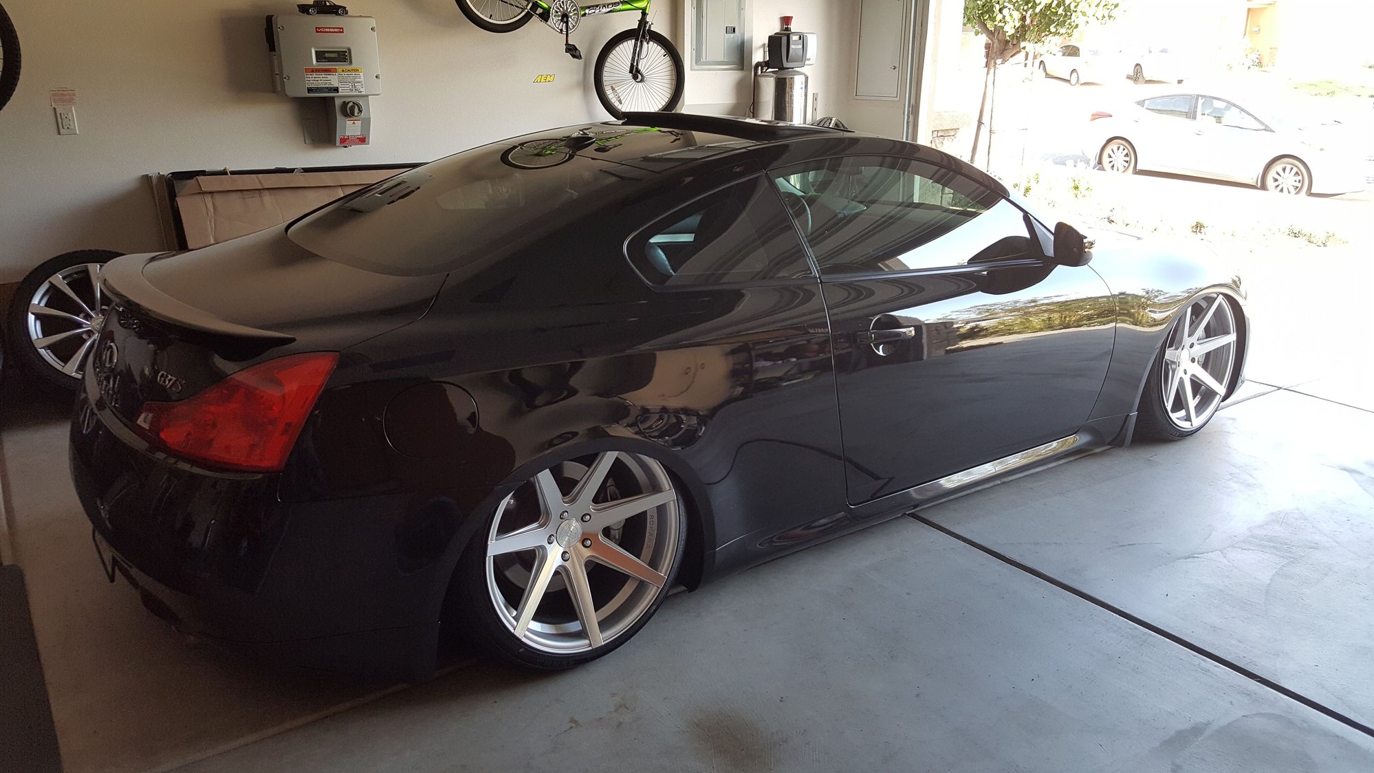

My car is not AWD but I'm running Rohana RC7's. I have 20x10 in the front and 20x11 in the rear on 245/3520 and 275/30/20. It's just a pretty mild stretch and nothing even close to crazy. I'm on air suspension so for my drive height I did have to shave off the rear bumper brackets and roll my front fenders only because my drive height is pretty low.

Always liked those shots of your G^^^^What offsets are you running and what camber are you at during drive height?
You have a great looking G, those wheels are dope! although I dont plan on dropping it that low, maybe F:1.9 R:1.6.. but I need a setup without tires stretched. im on the Northeastern where you can go swimming in potholes and the sidewall looks iffy.
