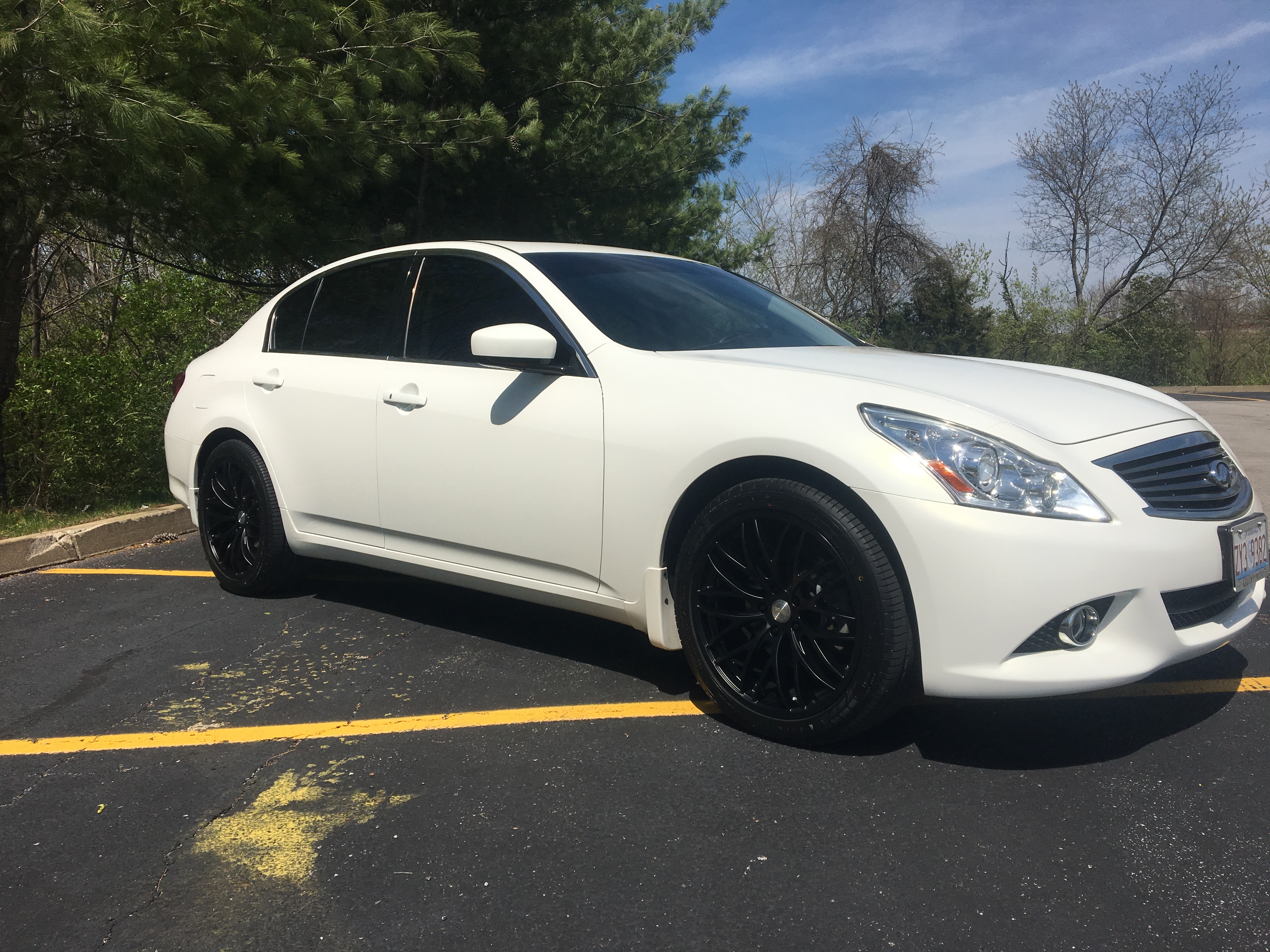

Old Apr 8, 2017 | 03:59 PM
Mark Smith827's Avatar
Mark Smith827
Joined: Dec 2016
Posts: 6
I think they fit nicely!!!
Cleaned it up today. Been raining since I put them on Thursday!!!
