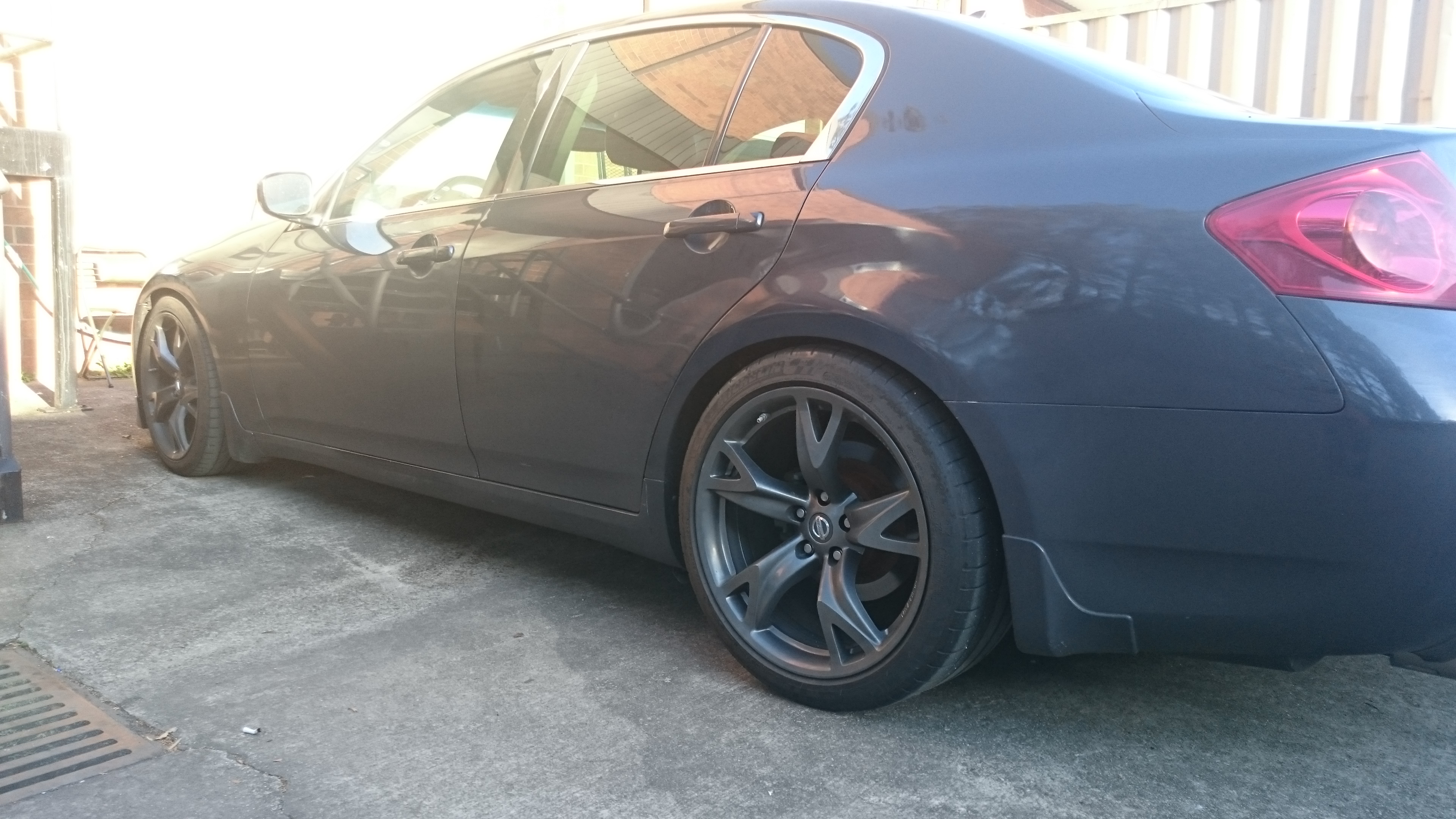

Old Mar 17, 2016 | 09:38 AM
zer099's Avatar
zer099
Posts: 425
Likes: 91
From: North GA
I forgot I told someone I would post a fitment pic as well. Wheel and alignment spec here, or just scroll up. And now a quick and dirty lens flare picture to hide dirtiness of car:
Please excuse the very dirty car parked outside my even dirtier place of employment. Also in dirty car defense I would like to add it is tree bukkake season, and fighting the pollen is futile.
