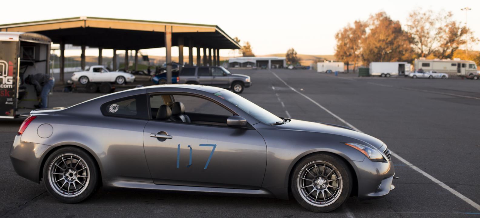

This is probably the only photo I have of my car, side on.
I sold the wheels a while back because 1. I disliked how I had to run a spacer for it to clear the front brakes, and 2. because I wanted to go wider. I love the design, price point, and weight/strength of these wheels (honestly, for the dollar you spend, they're almost as light and almost as strong as a TE37 or equivalent forged wheel). Gonna try to stuff the 18x10.5 +30 NT03s in there when I have a chance.
As for the center caps, from what I understand, the TC105N center caps are inserted from the back of the wheel when unmounted. And they take up the space that would otherwise be taken up by the centering ring around the hub bore.
You could measure the hole in the front and try to find something that would friction/tab fit in there, but other than that I really have no experience otherwise since I don't actually run hub caps on any of my wheels...
