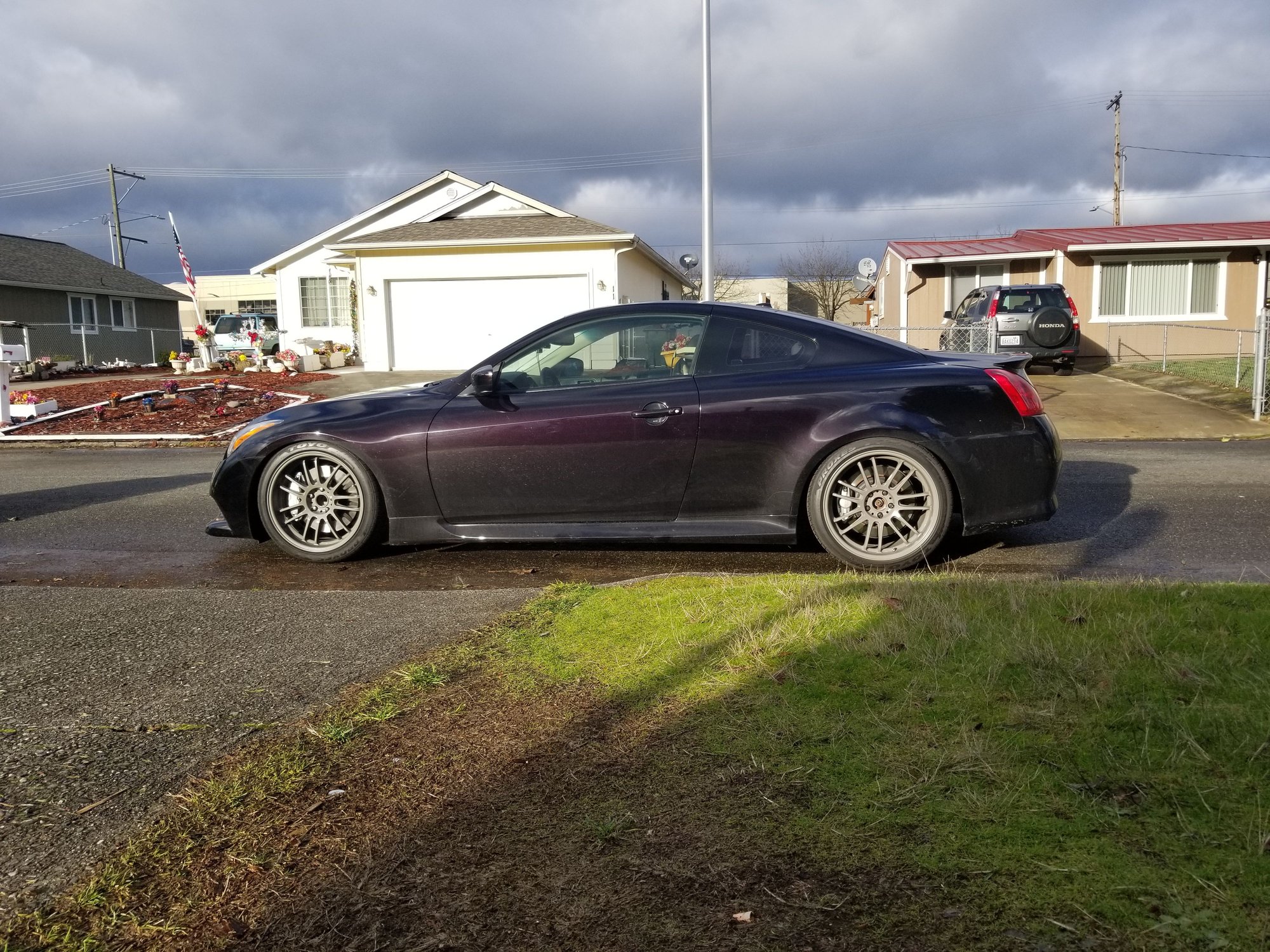

Old Jan 8, 2018 | 11:24 AM
PNW_IPL's Avatar
PNW_IPL
Joined: Mar 2016
Posts: 3,050
Likes: 547
Here is my 295 30 with -1 camber. As you can see it stick out. This is +20. With your +28 You'll get 4mm further in then add another degree or degree and a half you should avoid rubbing and bring it in flush.

Old Jan 8, 2018 | 02:36 PM
PNW_IPL's Avatar
PNW_IPL
Joined: Mar 2016
Posts: 3,050
Likes: 547
Originally Posted by garayvaz
thank you for the info, sounds good but, would you think going 20x10 in the rear would fit better and more flush or go aggressive with more camber, for me I like to have the car to have a sports car look instead of a full negative camber car
does this look like racecar to you?
only neg 2.5 camber.
your choice. This car can handle an 11 easy.
Old Jan 8, 2018 | 07:12 PM
garayvaz's Avatar
garayvaz
Joined: Jan 2018
Posts: 3
From: pasadena CA
that looks badass, what are the specs though? so maybe a little camber is not to bad
Old Jan 8, 2018 | 07:23 PM
PNW_IPL's Avatar
PNW_IPL
Joined: Mar 2016
Posts: 3,050
Likes: 547
19x10 +30 255 40
19x11 +20 275 35
