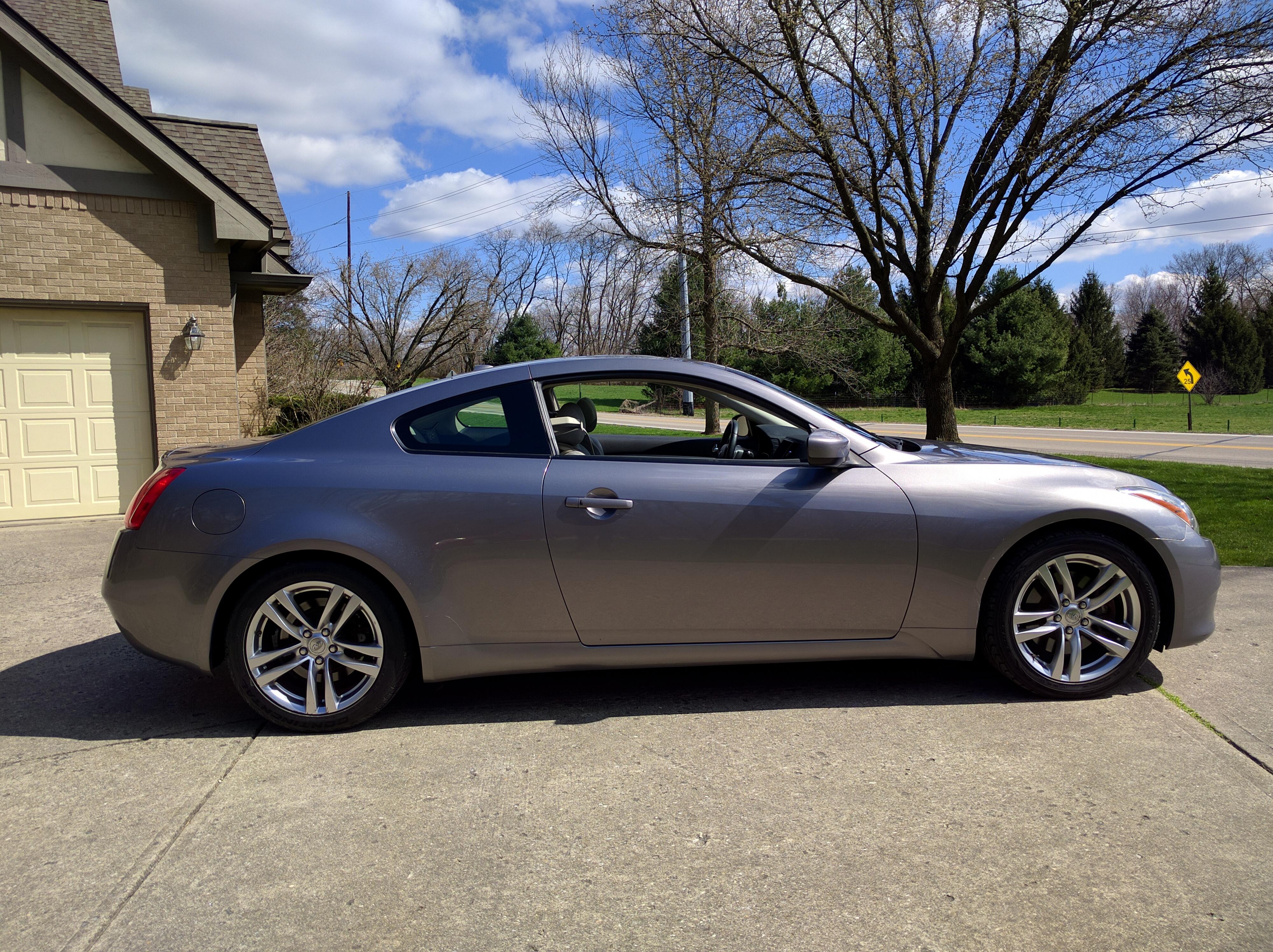

(Obligatory pic of the car)
08 G37 Coupe Journey - Wheel/Tire/Springs Fitment-img_20160320_145159.jpg
