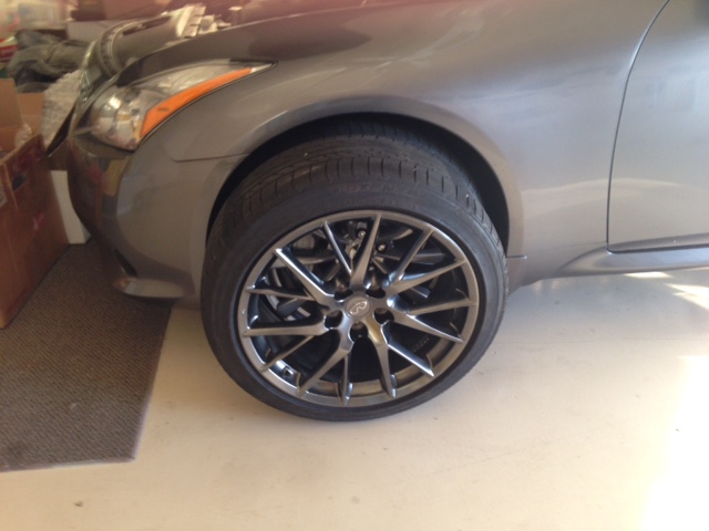

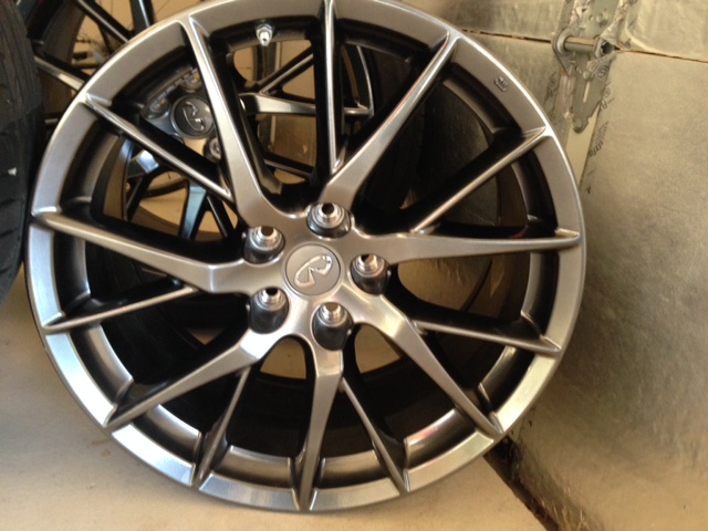

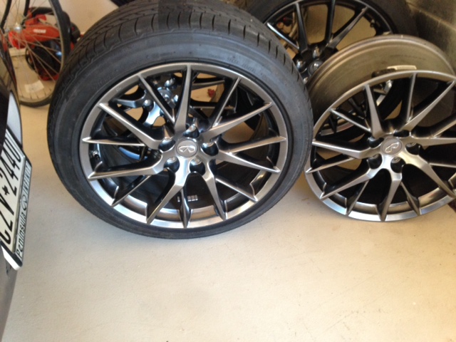

Found a set of IPL's last week and they are in transit to me now! Will post pics when I get them. I will need to buy rear tires though. The rears are 9.0" width, can I fit 275/19 on the rear?
Old Nov 25, 2014 | 09:04 PM
miketyler's Avatar
miketyler
Posts: 106
Got them today and was very pleased! $1150 delivered to my door and the two front tires have lots of tread.

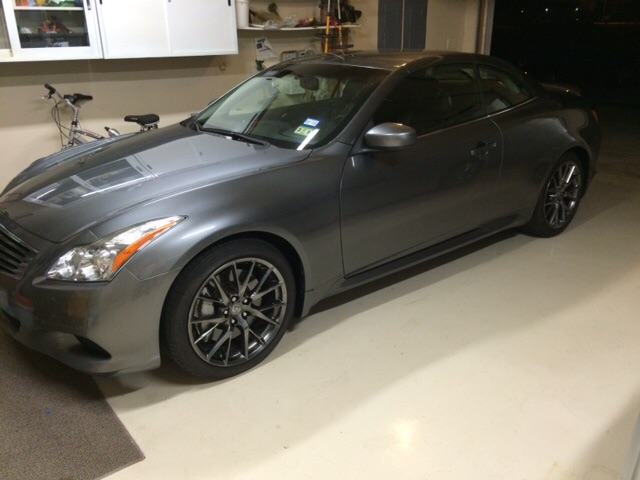

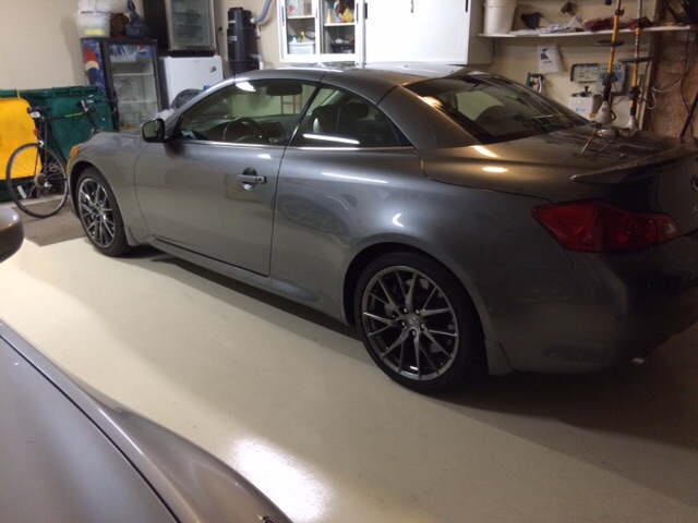

Old Dec 3, 2014 | 07:29 PM
miketyler's Avatar
miketyler
Posts: 106
And Babam!
Old Dec 3, 2014 | 07:31 PM
miketyler's Avatar
miketyler
Posts: 106
Babam! (again)
Old Dec 4, 2014 | 09:00 PM
Likes: 4,952
9" rims are the narrowest recommended rims for a 275/35/19, so they'll fit
BTW, great deal on those wheels, looks good too!
