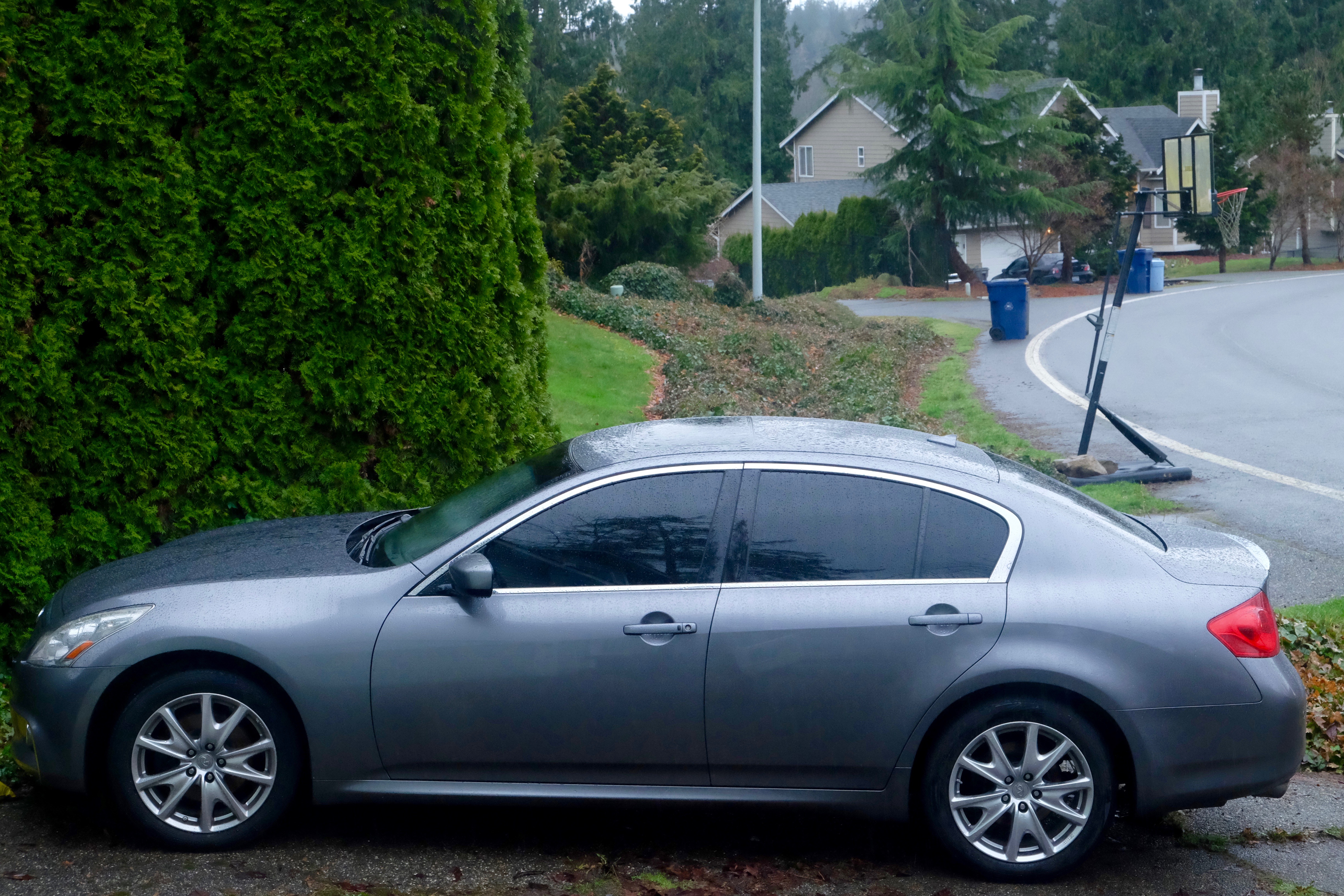

here's my car w/ it's duckfeet wheels, which here in Seattle is appropriate but I'd like to begin modifying w/ wheels/tires and later with a Stance coilover/Swift upgrade

Those specs should be fine, when lowered you'll have plenty of room at the fender. I think you will be able to fit a 245/40 up front and 275/35 in the rear like I mentioned. Those will be on the meatier, if you want a more snug fit look you could choose 225/45 front and 255/40 rear. You have some freedom to choose the best sizes for you, take a look at blnewt's link for some more options.
Thank you.
By "more snug fit" with the F:225/45 R:255/40 do you mean after the coilover install when the car is lowered? "Snug" meaning a closer fit to the fender vertically?
Sorry, but I'm very mechanically challenged - But I know what I like when I see it!

I meant snug as in not as wide of a tire on the wheel. It won't be stretched, though.
