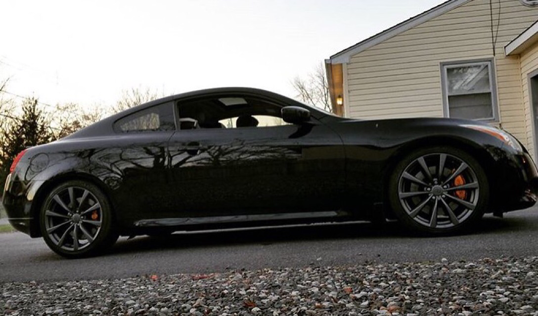

Here are my plasti dipped wheels. I'd recommend it. I did it because I personally like the stock wheels and can't afford new expensive ones.
That looks phenomenal!
I have a feeling that those expressing a dislike for dipping wheels aren't aware that many of the great looking set ups they've seen use it.
Not only are many achieving a great look, they're protecting the wheels in the process. It's important to mention that the process is 100% reversible in minutes.
