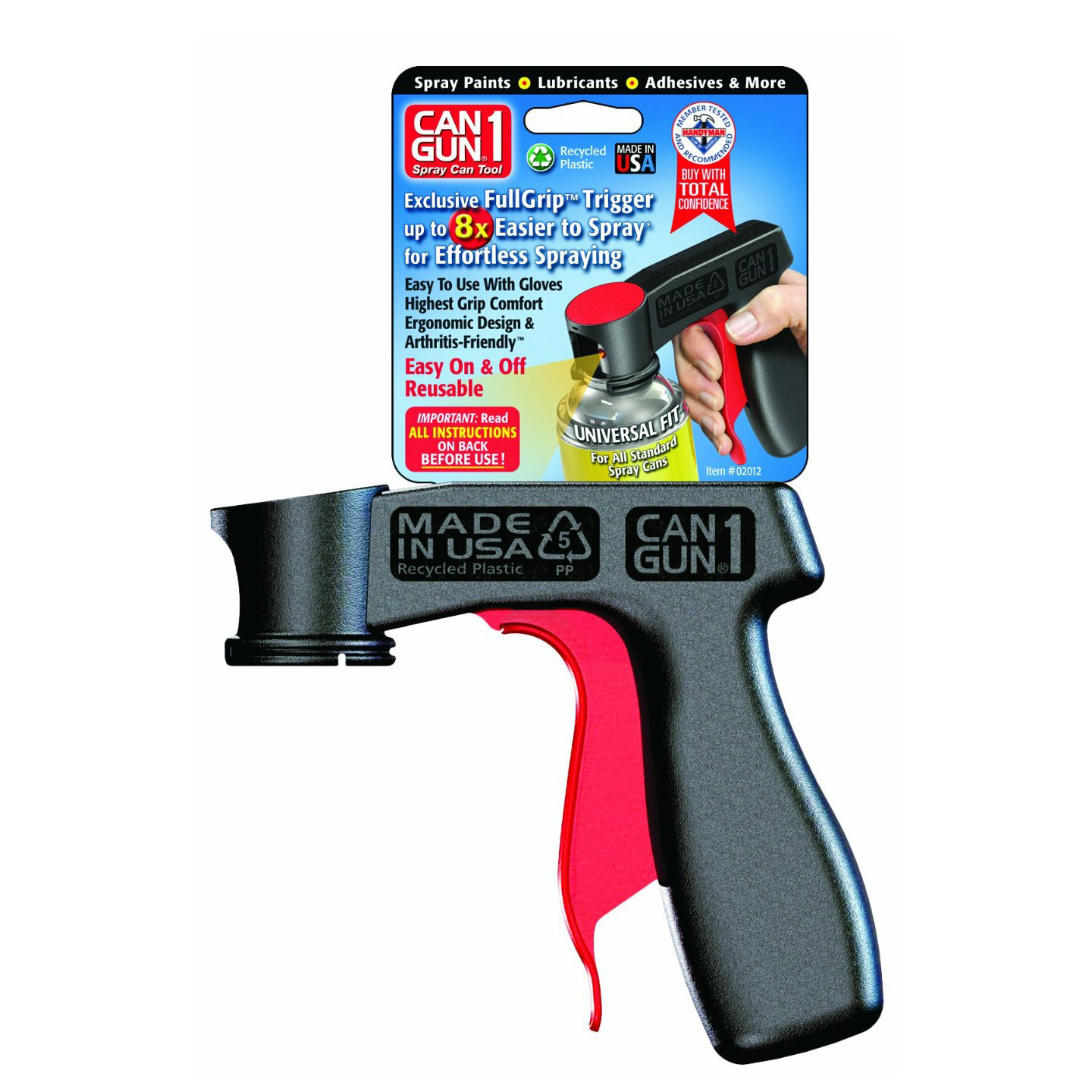

Jumbo (or anyone interested for that matter), I also picked up a spray gun can adapter thing. It makes a huge difference in allowing more natural, sweeping spray motions. Picked this up on Amazon for under $6 (prime).
It allows for 4 finger points of contact. This is a big advantage over other models. I wouldn't rattle-can without one now.
Search by name for it: Can-Gun1 2012 Premium Can Tool
Good tip and thanks for the other info. I have some experience with plastidip so I know what to expect going in. My experience had been on my old 01 Firebird when only matte black was available. Really cool to see the color combos you can get now.

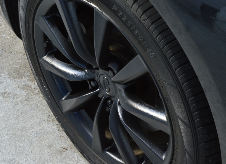

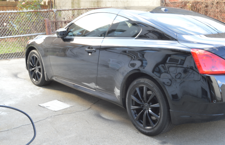

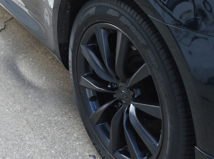

Definitely not smooth but I guess I can live with it until I get through winter this year and redo in the spring. It was pretty windy + cold yesterday. Rather than the dip coming in regular spray format, some of it was in chunks. Not to mention one can clogged up and dip started flooding out of the nozzle.
I used almost one can of glossifer on all 4 wheels. Should I do another coat? It has shine to it but not too much which I like.
