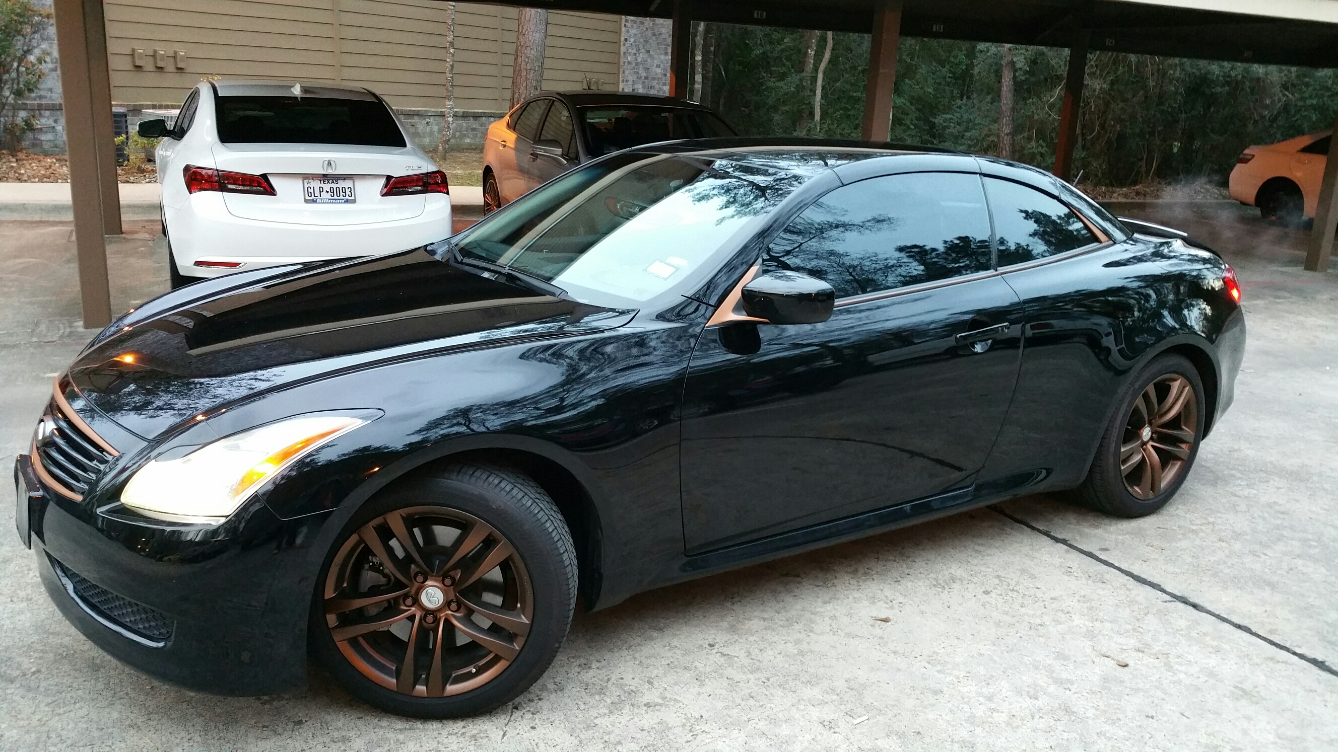

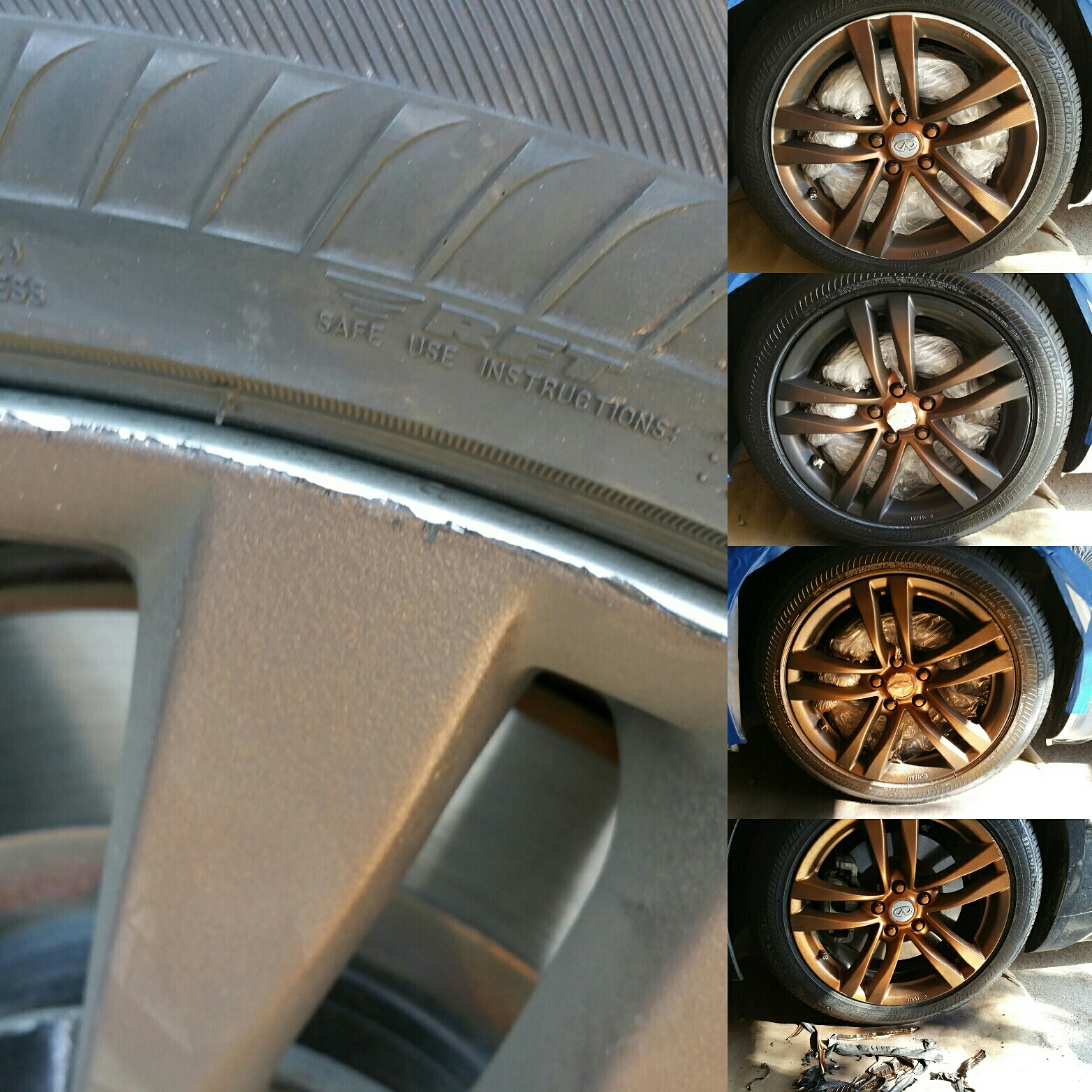

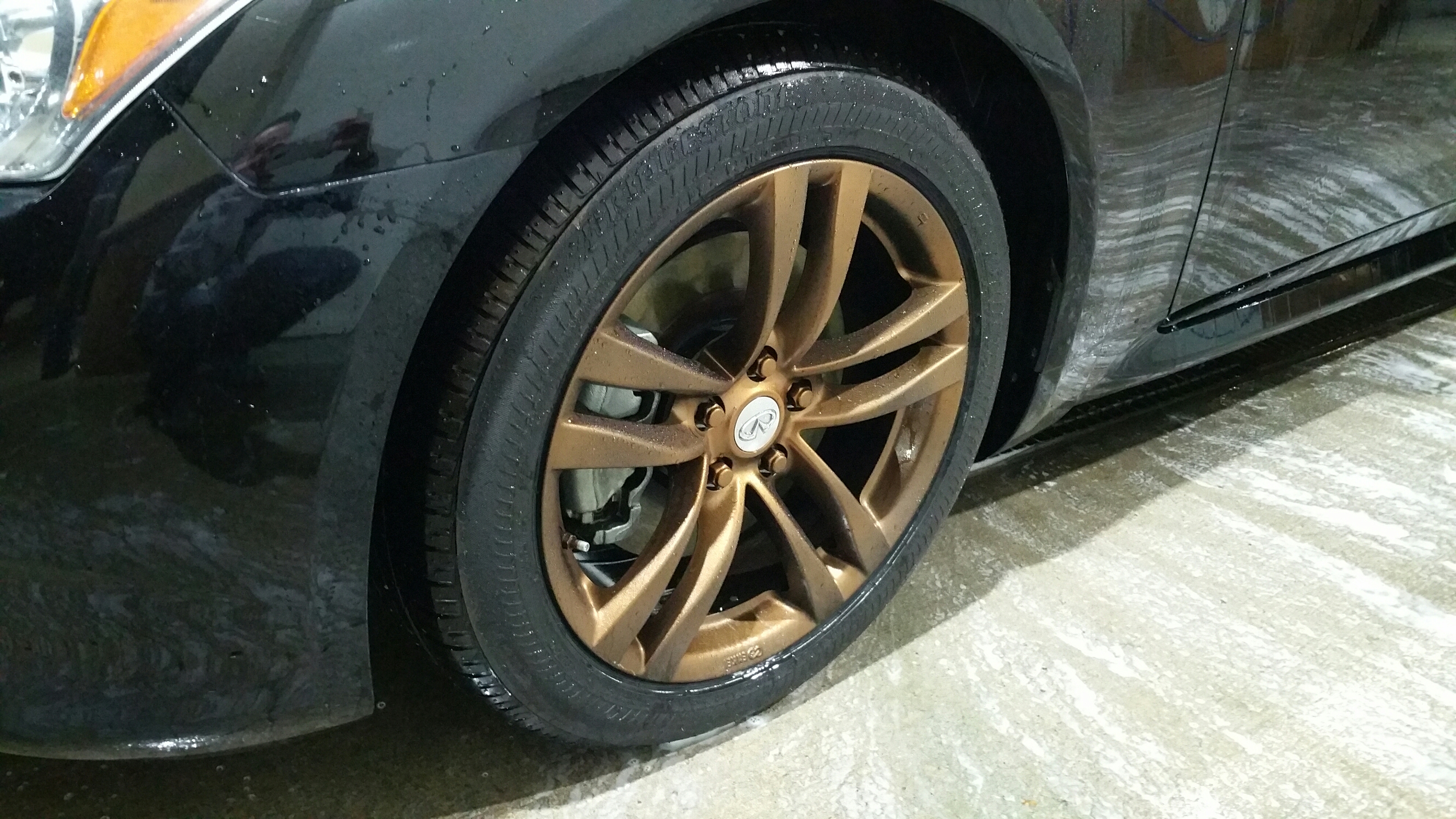

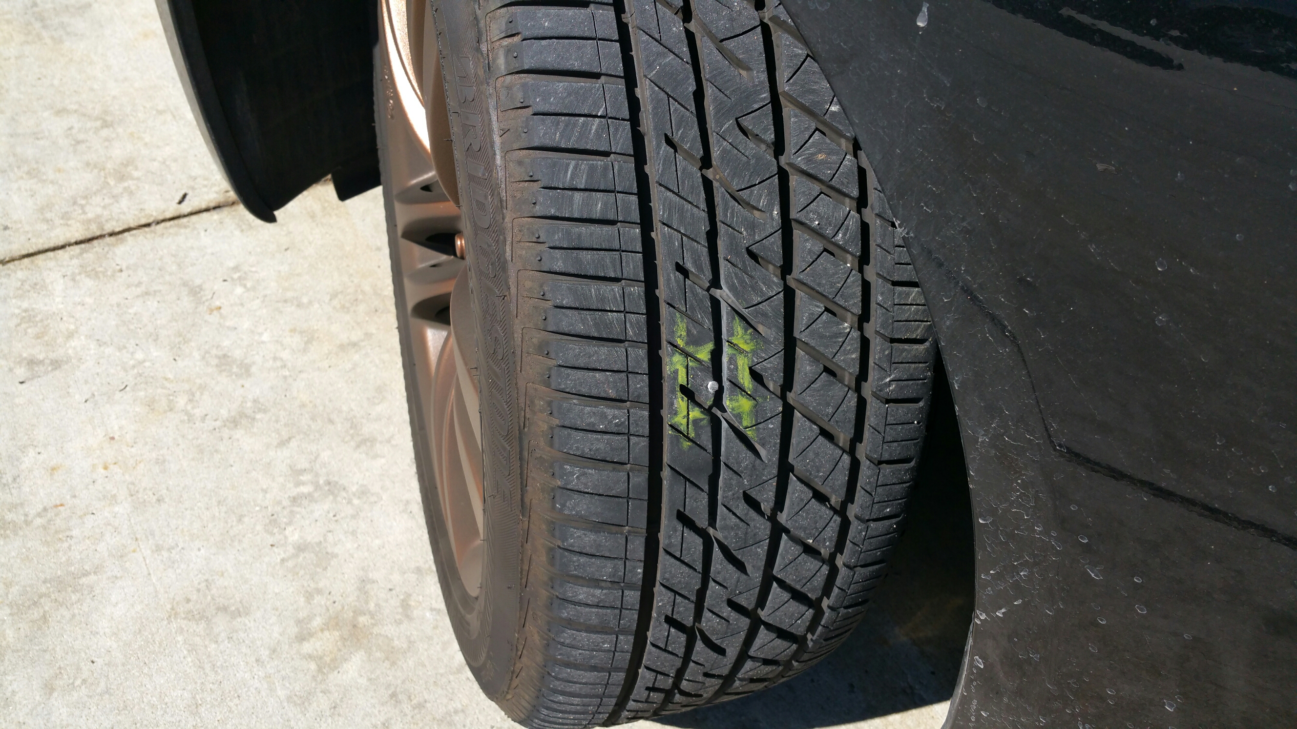

So, I had a nail in a tire today. Machine peeled dip around the circumference while they fixed it. Otherwise, all other dip held up nicely.
I razored well below the peel line and removed the peeled dip. Cleaned the wheel, taped it off, bagged the brakes, and resprayed matte black base then copper metalizer over top. Good as... well, bronze.

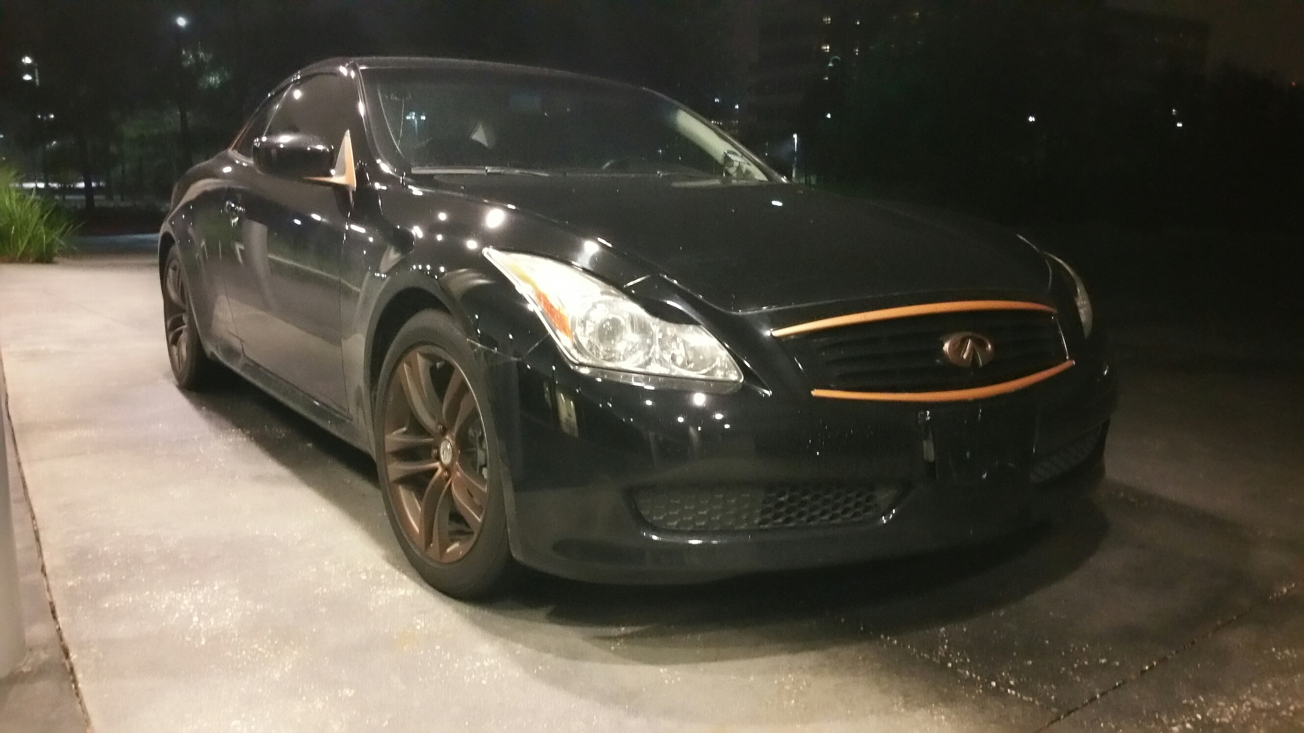

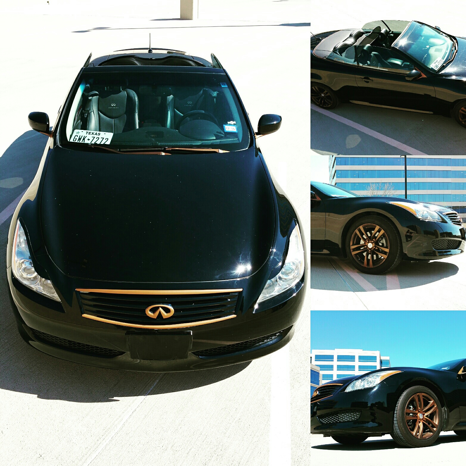

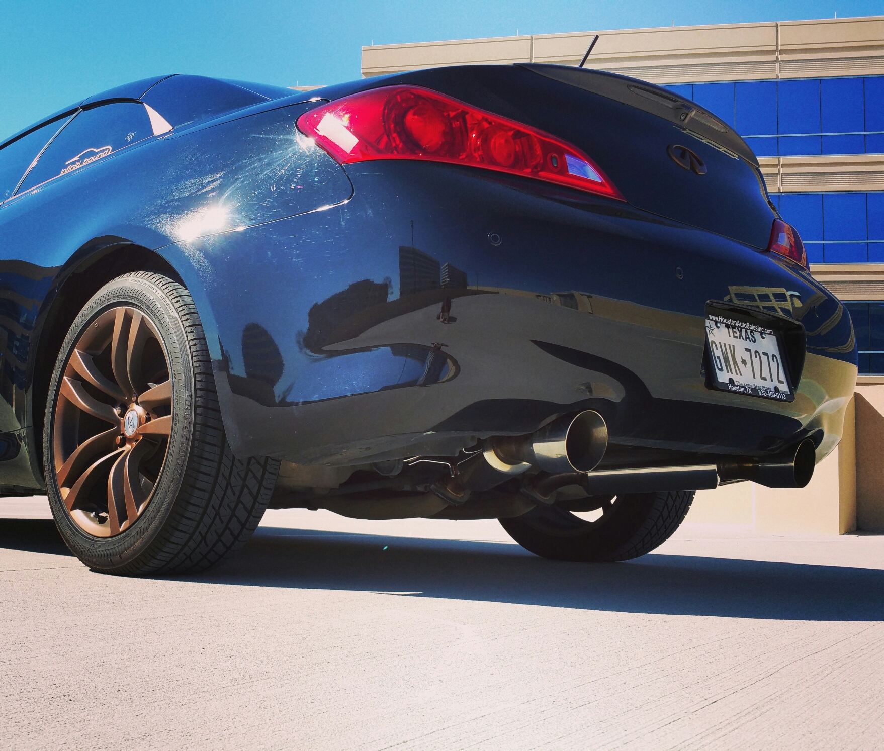

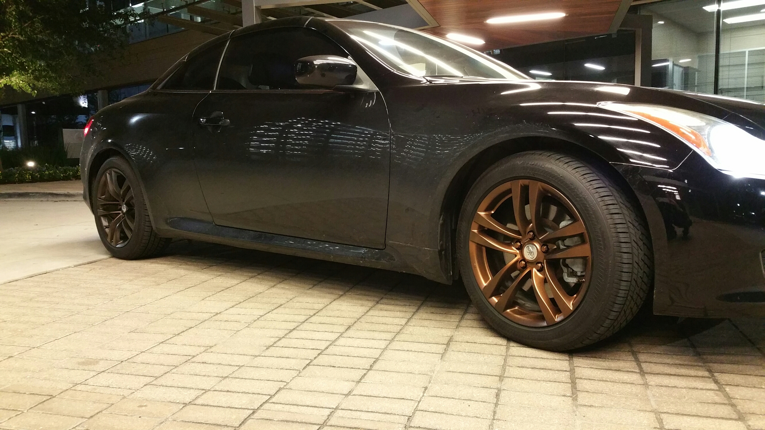

@timc00k Yep. Black vert. I'll post a few pictures. No professional shots yet. Car's a few weeks from completion.

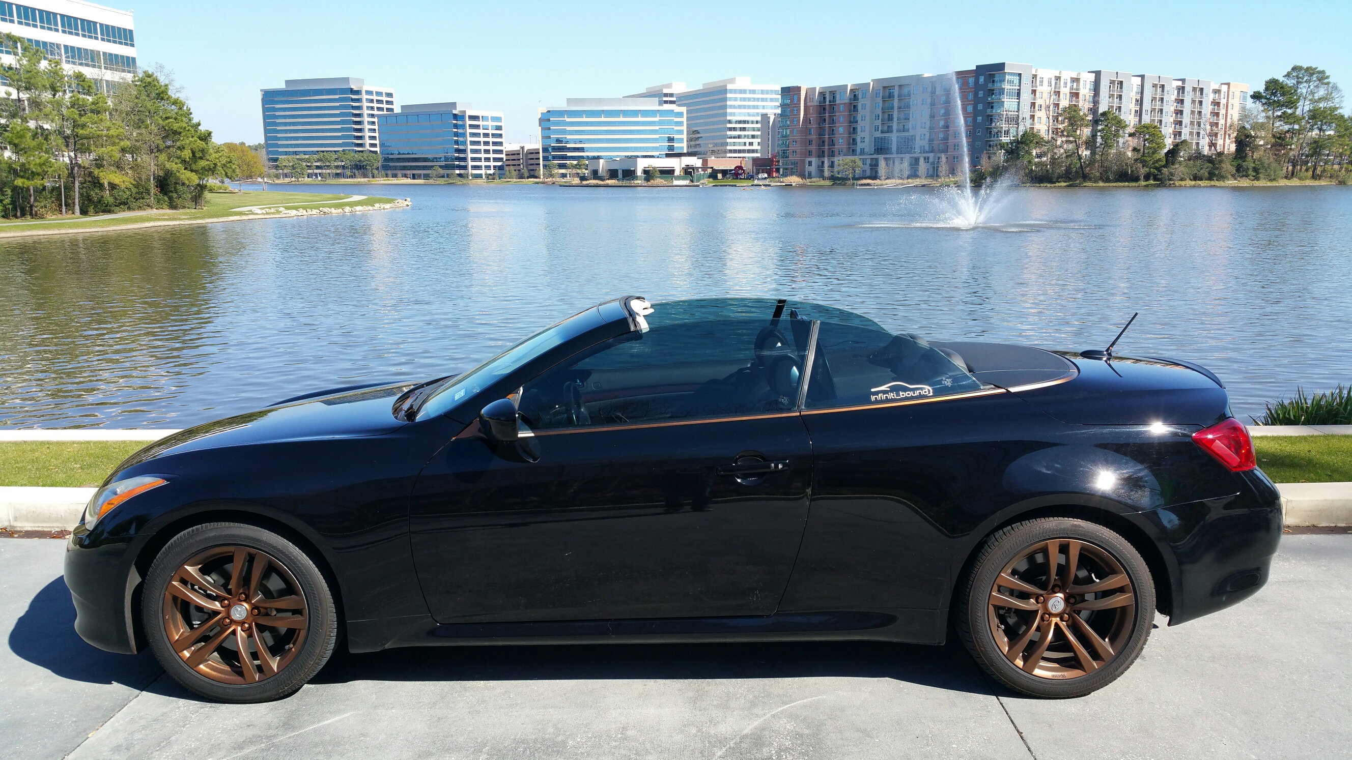

You can really see the light play in those shots. Without direct light the bronze appear black. In cool light or florescent light they appear more gold. In low, natural light, more copper. But, they look great all the time.
I was reassured recently when asked what wheel color I was running by a brand new m4 owner at a gas station. He said, "wow, that's exactly the color I want to put on this. But, I don't know where to order it." He honestly didn't believe me when I told him it was dip.

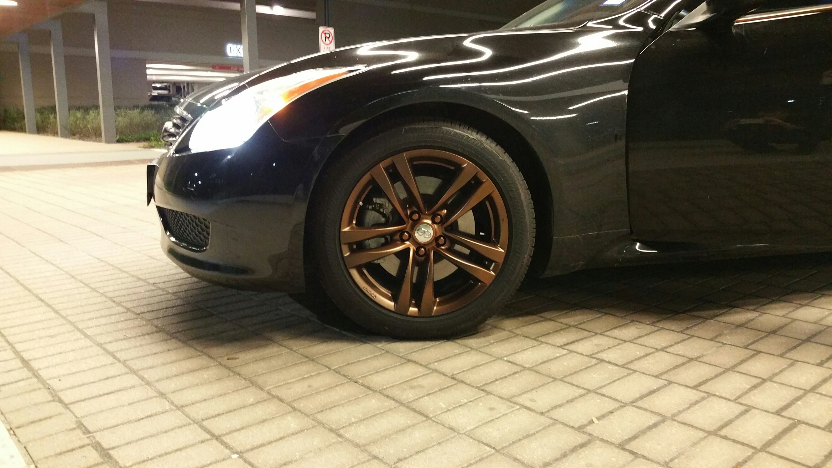

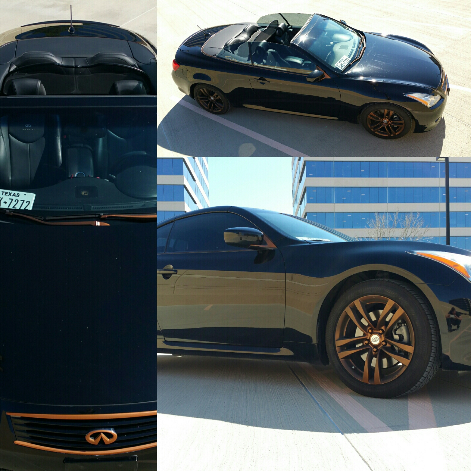

Here are some shots showing the wheels from this afternoon...

Very nice. How many coats of metalizer did you put?

6 coats of matte black base and 3 coats of copper metalizer.
Next dip will be a white base with copper metalizer. Going to go for copper. Probably 4-5 months from now.

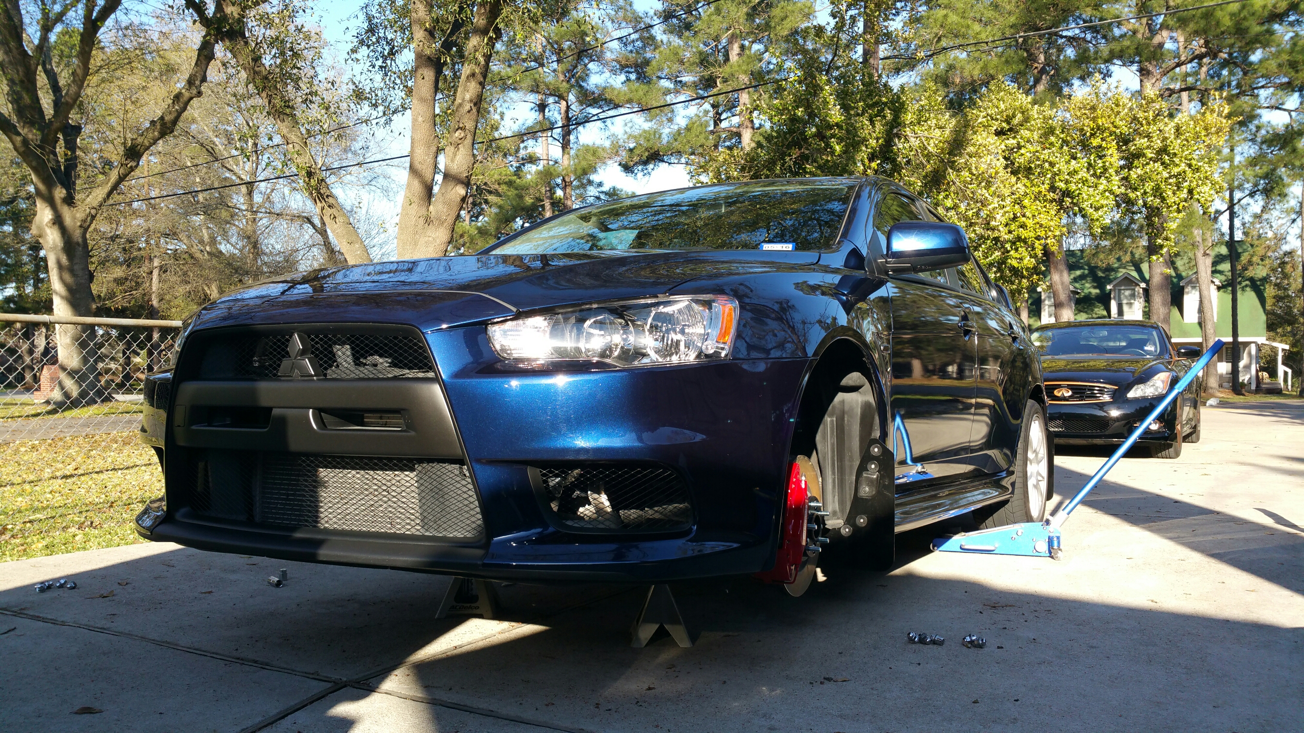

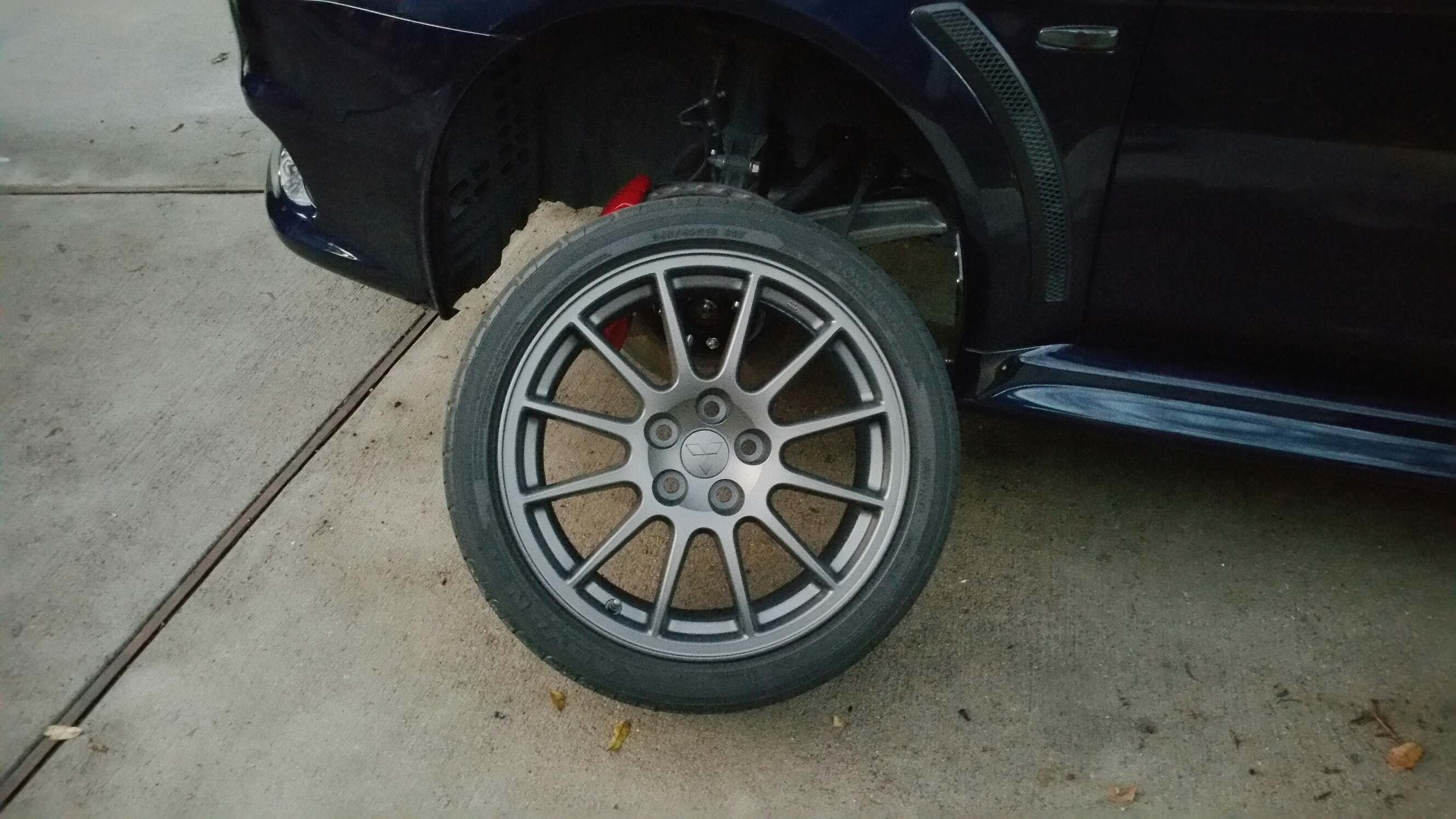

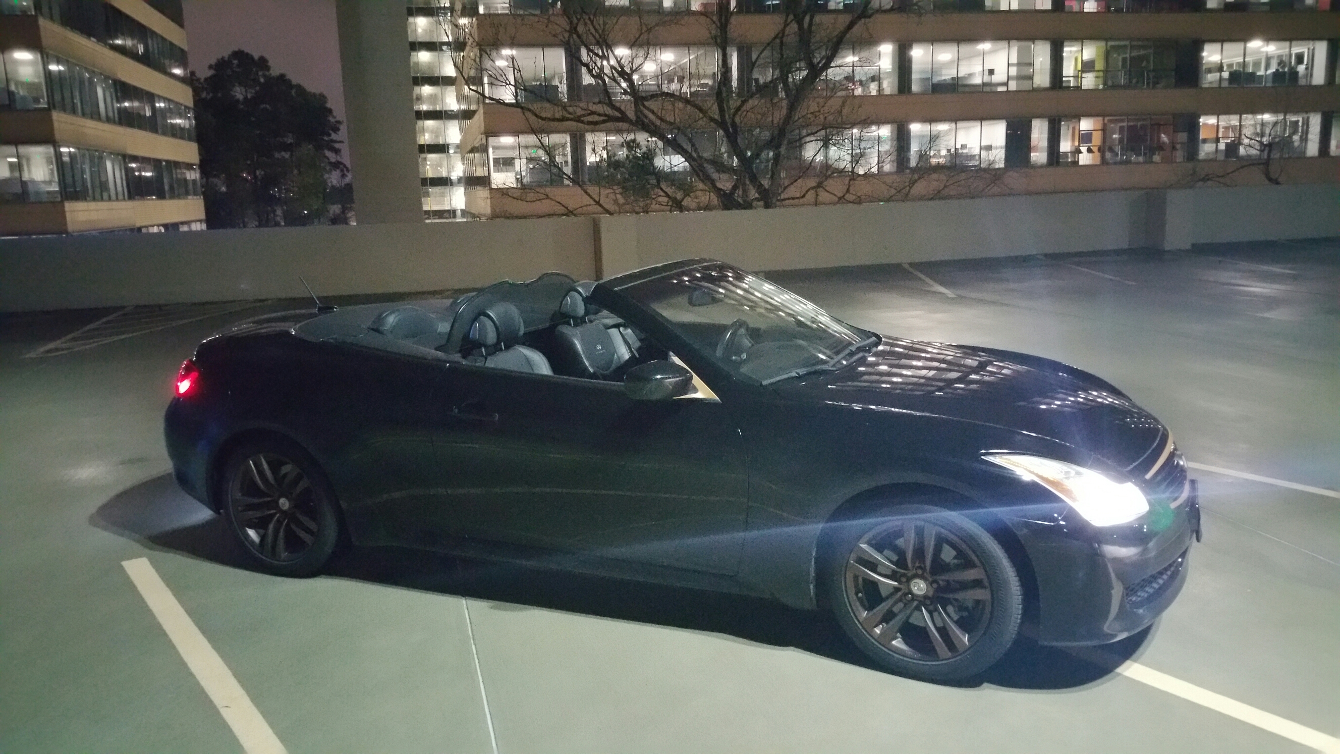

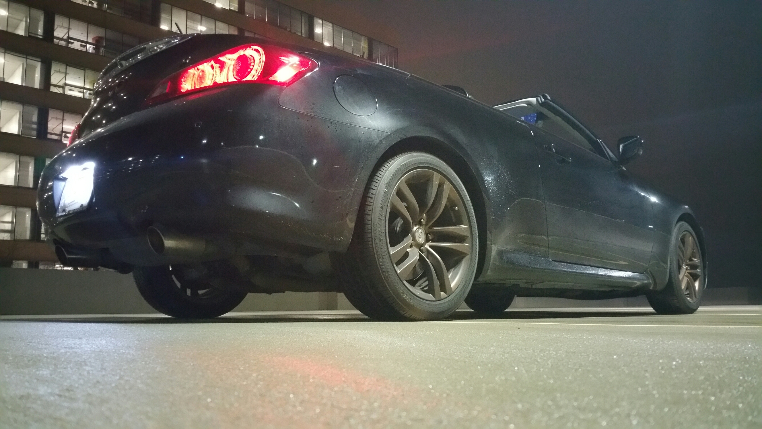

Alright. Total change in the works. Toy mod day brought on Anthracite Grey for the evo. Too good not to do on the G.
So, bronze deleting everything and going Anthracite.
