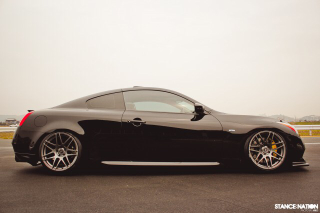

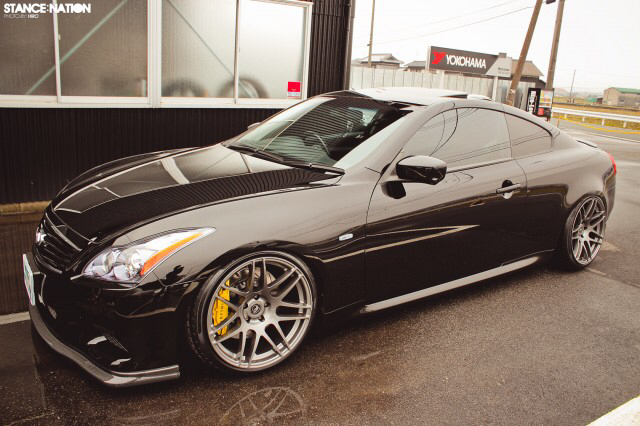

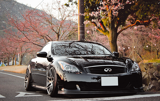

What offset would you recommend for the forgestar f14s deep concave 19x9.5 front and 19x10.5 rear? Saw this g and loved the look. Mines a 08 g37s coupe if that matters. Lowering & need to kno Wats a good size rim for it thanks-photo227.jpgLowering & need to kno Wats a good size rim for it thanks-photo918.jpgLowering & need to kno Wats a good size rim for it thanks-photo877.jpg
Old Nov 24, 2015 | 10:23 PM
Originally Posted by GariepyVQ
What offset would you recommend for the forgestar f14s deep concave 19x9.5 front and 19x10.5 rear? Saw this g and loved the look. Mines a 08 g37s coupe if that matters. Attachment 116367Attachment 116366Attachment 116365
If you want to go real aggressive as far as tires I'd run a 19x9.5 +23 front on 255/40/19 and 19x11 +35 on 285/35/19 or 19x11 +40 on 295/35/19s
Here's a X coupe running 10.5 +25 all around on 275s so that would be a similar fit at the fender in back as those 11 +35s, the 11s will be in about 3mm from those for a bit more room for error
https://www.myg37.com/forums/brakes-...ml#post3891573
With those specs I listed you won't have to run that heavy camber like the black G you posted. If you want that exact look of that black G you can go more aggressive w/ the offsets but it won't be near as good for daily driving.
