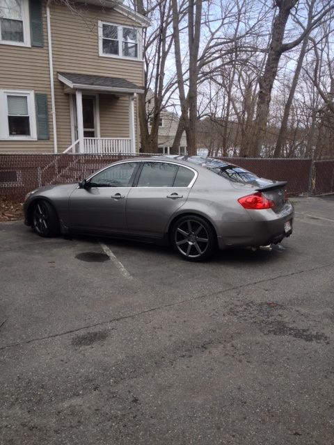

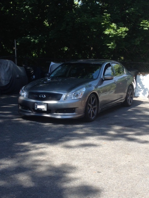

Attached Thumbnails 19" Rays on a G37x Sedan-sunny-day-shade.jpg   19" Rays on a G37x Sedan-carwash-side.jpg
