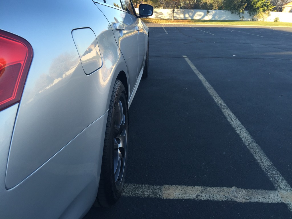

Just from that pic:
...your fronts look perfectly flush at OEM height. Once dropped, the camber kit will allow you to go back to OEM spec on front camber. If that's what you want to do, then it will continue to be flush. However, if you intentionally put some negative camber in the front, then yes... 5mm or 10mm spacers.
AFAIK, you can add up to 5mm of wheel spacer with the OEM lugs. At 10mm, you'll need extended lugs. And at 15+, you can use wheel spacer adapters, which have their own lugs integrated into the spacer. As for the rears... and again, just from this one pic, it looks like you'll be nicely flush if you drop it with -2* camber. I very highly doubt the need for rear spacers.
Either way, and IMO, the car needs to be lowered for a consistent-ish gap around the wheel wells. At least, that's the look I prefer. Everybody is different. Newt likes zero gap to the top-of-tire. And some people like tucking the tire as much as possible. However, my advice is to go for a consistent look, so your profile looks normal.
I think the one thing we can all agree on is that OEM height doesn't look normal unless you have OEM 18" sport rims. And even then, LOL.
Even the 5mm spacers come with extended lugs (I'm currently running a set in the rear). The lugs go up in size every 10 mm of spacer. So 5 & 10 are the same length lugs, 15 & 20, etc.
