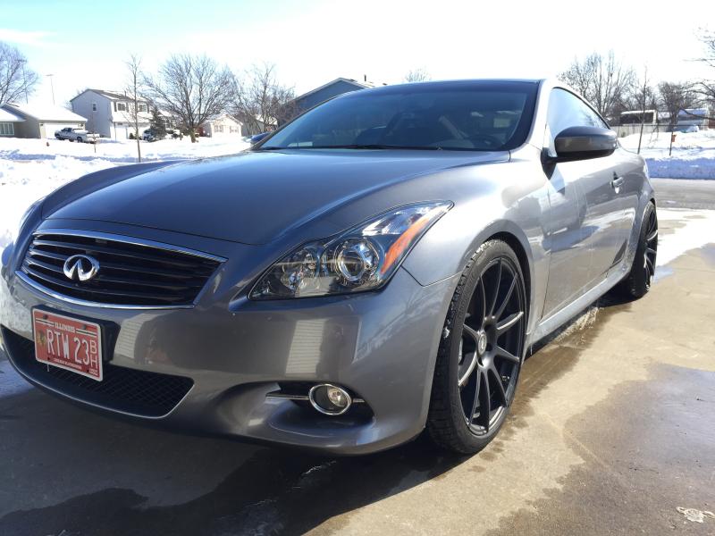

255/35R20 all around and my rear wheels are 10.5"

The sidewall is about a 1/4" taller, that makes the overall height (or diameter) of the tire a 1/2" taller. If you look at the tire and visualize adding a 1/4" to the top of the tire and a 1/4" to the bottom it should become clear, or maybe it was just a misunderstanding of what measurement was being talked about
And Ryne's coupe is a great example of what a light stretch does to the rolling diameter, very minimal effect.
