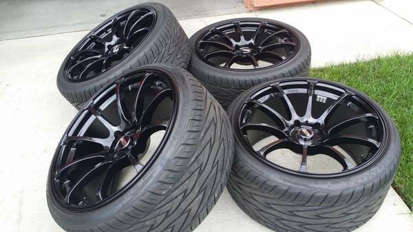

Would you do it? I currently have -2 camber all around. What about design wise?
Attached Thumbnails Will 10.5 +35 with 265/35/19 fit and look right in the back?-00o0o_froh3py1uip_600x450.jpg   Will 10.5 +35 with 265/35/19 fit and look right in the back?-01212_1gxjcrrwbnw_600x450.jpg   Will 10.5 +35 with 265/35/19 fit and look right in the back?-00l0l_ixzxjzle2hb_600x450.jpg   Will 10.5 +35 with 265/35/19 fit and look right in the back?-00w0w_b0lwigijjtd_600x450.jpg

Here are the pics of the stretch on back.
Attached Thumbnails Will 10.5 +35 with 265/35/19 fit and look right in the back?-20140827_112353.jpg   Will 10.5 +35 with 265/35/19 fit and look right in the back?-20140827_112504.jpg
Old Aug 27, 2014 | 07:23 PM
Wheels are a nice design for your G and have a decent concavity to them.
As far as fit, I put the numbers out there for you, just add 11mm to your current fit and that should give you an idea of the look w/ those wheels/tires. Tires can vary in widths from brand to brand so always best to have a little extra room available to allow for that.
