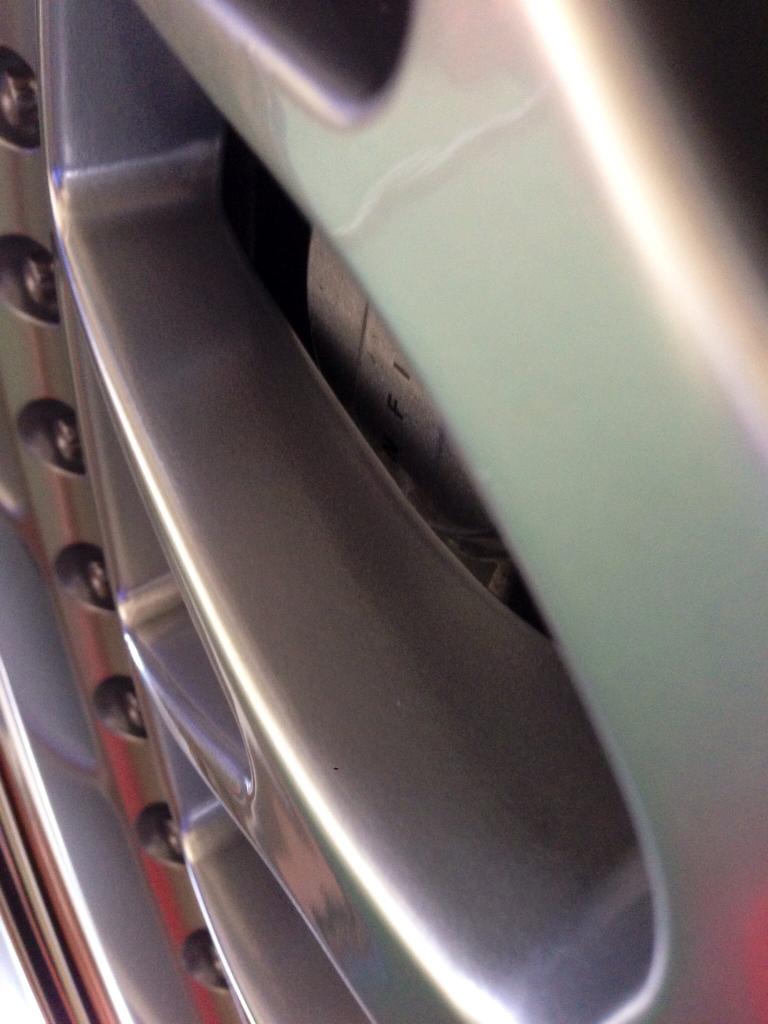

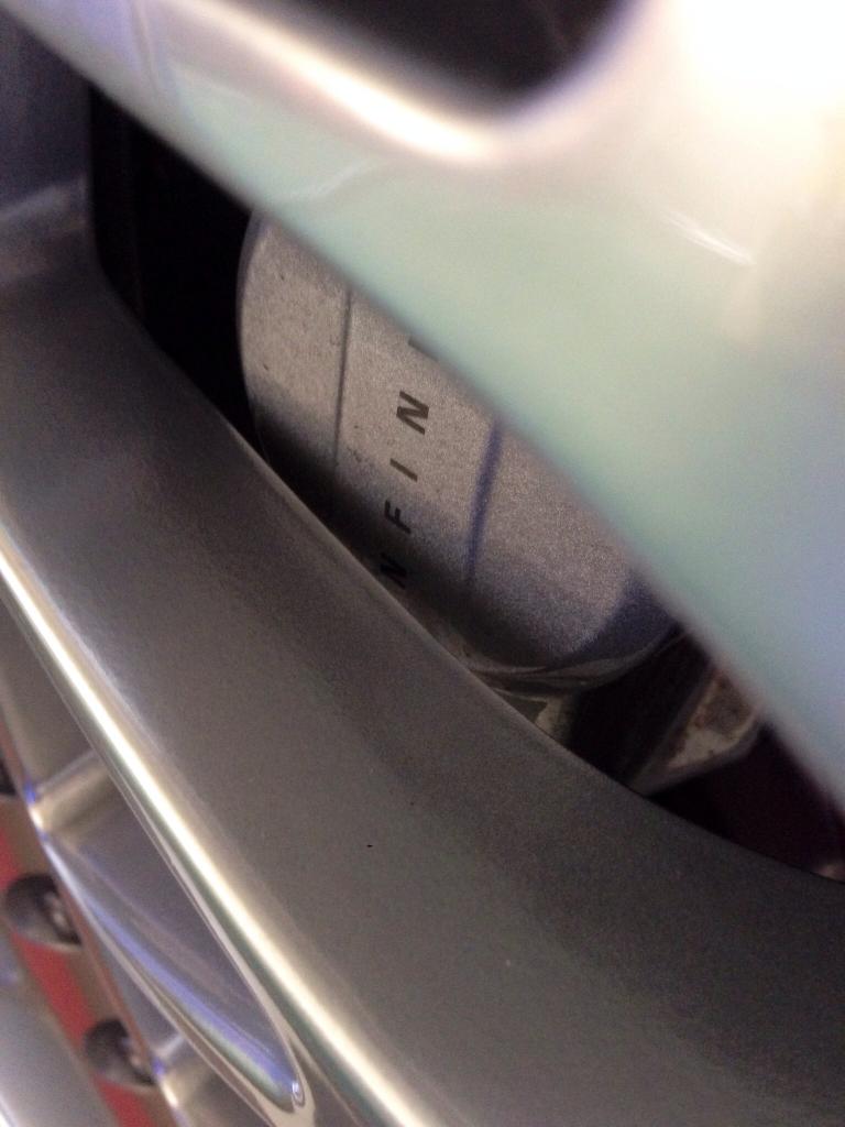

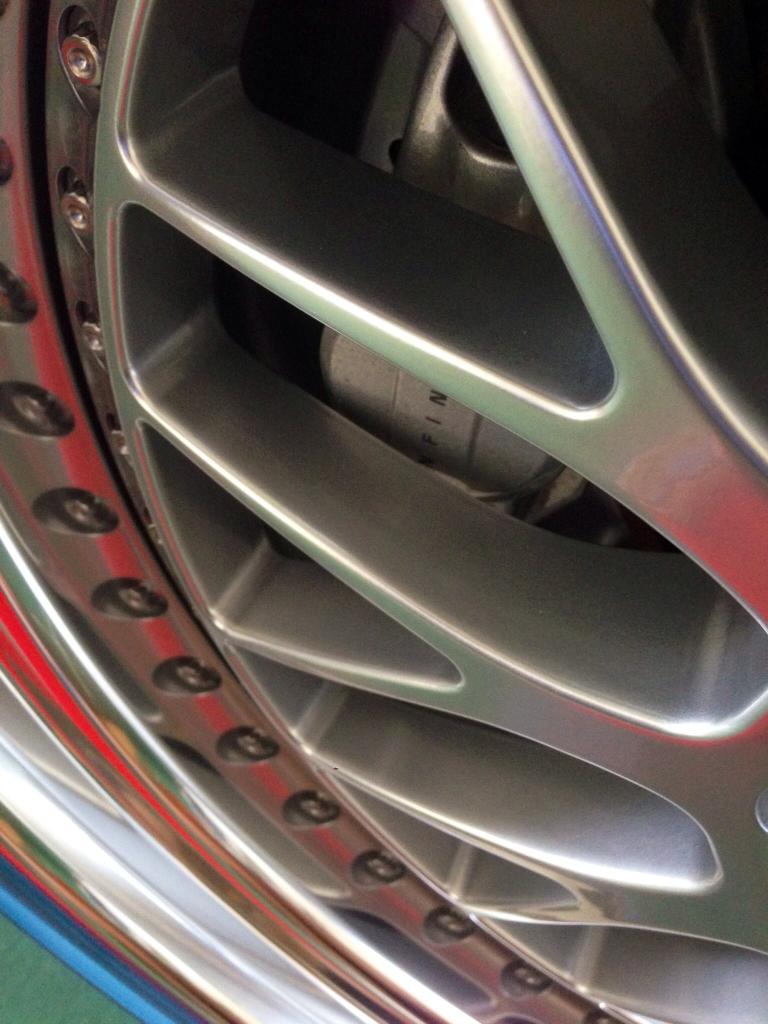

I'm getting ready to mount my rear 20x10.5 Work VS-XX step rim wheels on my SEDAN with Akebono, but I need a little feedback regarding brake clearance.
I have a 10mm spacer installed in these pics. Quick background as to what I'm trying to accomplish:
Wheels are 20x10.5 O-disk +42 offset (with no spacer).
As pictured, I'd be running a +32 offset on my SEDAN.
I'm trying to use the smallest spacer possible to avoid going aggresive.
I'm coming from a 20x10.5 +25, which was a bit too aggresive for me.
I don't want to do a fender pull.
I tried a 5mm, and it doesn't clear the caliper.
Based on the pictures, can I get away with an 8mm spacer?

Old Aug 17, 2014 | 01:35 PM
lippstuh's Avatar
lippstuh
Joined: Jul 2009
Posts: 133
Simply measure the shortest distance from the caliper to the rim. You will need some clearance between the two to be safe.

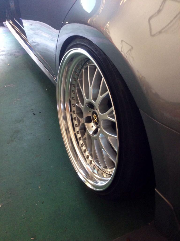

Old Aug 25, 2014 | 10:48 PM
JC-RH's Avatar
JC-RH
Joined: Dec 2005
Posts: 362
Likes: 25
From: Miami, FL
Had to reorder new studs, but this is what things look like so far.
Old Aug 25, 2014 | 11:53 PM
So I assume that's w/ the 8mm spacer installed? Looks real aggressive but those wheels are beautiful
Not usually a fan of stretched/cambered setups just because of the compromises in the drive, but when done right it can really look nice. Looks like you're well on your way.
BTW, what wheel specs are you running up front to clear those monster calipers?
Look forward to more pics and specs
Old Aug 26, 2014 | 12:11 AM
JC-RH's Avatar
JC-RH
Joined: Dec 2005
Posts: 362
Likes: 25
From: Miami, FL
Actually, that's with the 20mm spacers (+22 effective) on a +42 10.5 wheel and quite a bit of camber. I'll swap out the spacer for 8mm and install my extended studs later this week. Once I do, I'll be able to dial some positive camber to about -3 since I'll be running a +34 offset.
The fronts will be +28 with a 5mm spacer (+23 effective) on a 9.5 wheel.
I can't wait.
