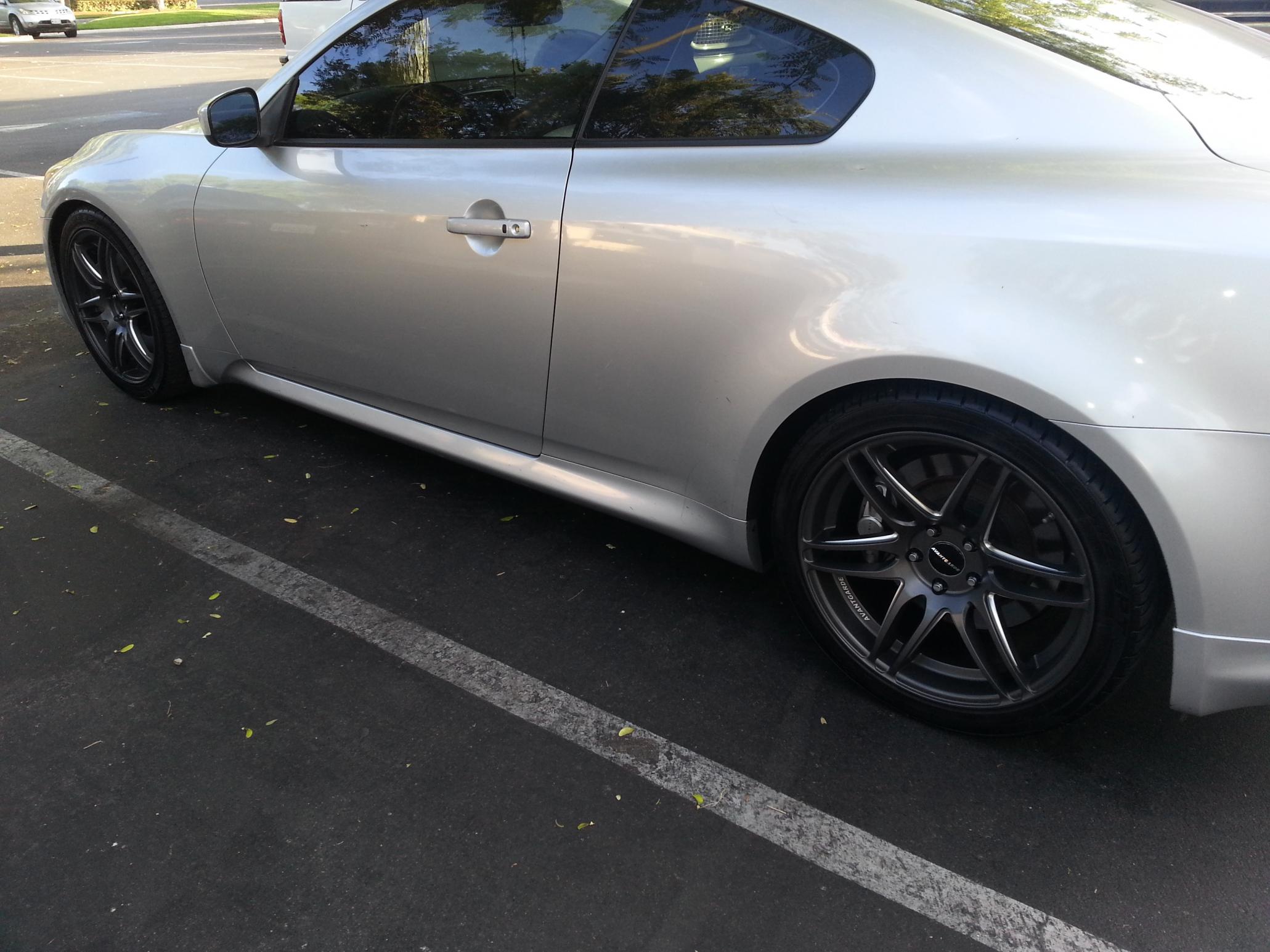

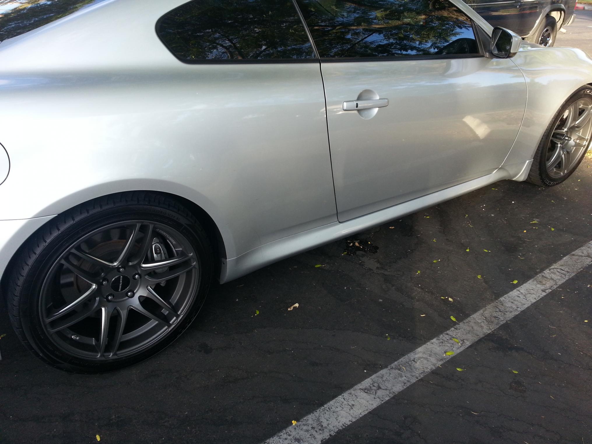

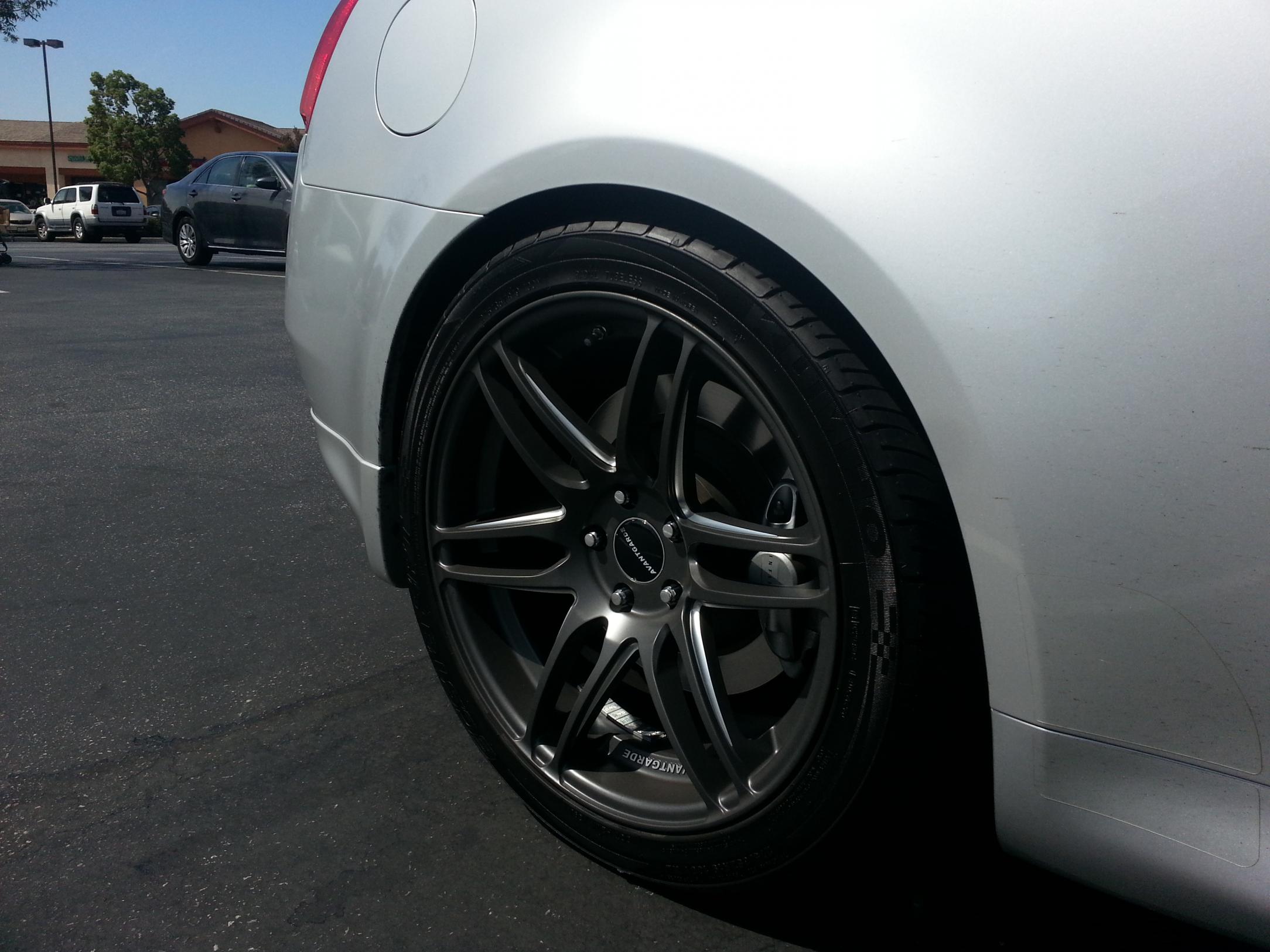

Avant Garde installed
Just wanted to share.
Finally installed them.
Avant Garde M368
Dolphin Grey
19x8.5 245/40
19x9.5 275/35
I didn't go with 20s because I wanted to keep the smoother ride.
Dropped on Eibach with front and rear camber
I will be posting my sport coupe 2008 rims for sale soon.

Looks reall cleannn. Offsets? Need control arms for front or rear for this setup??

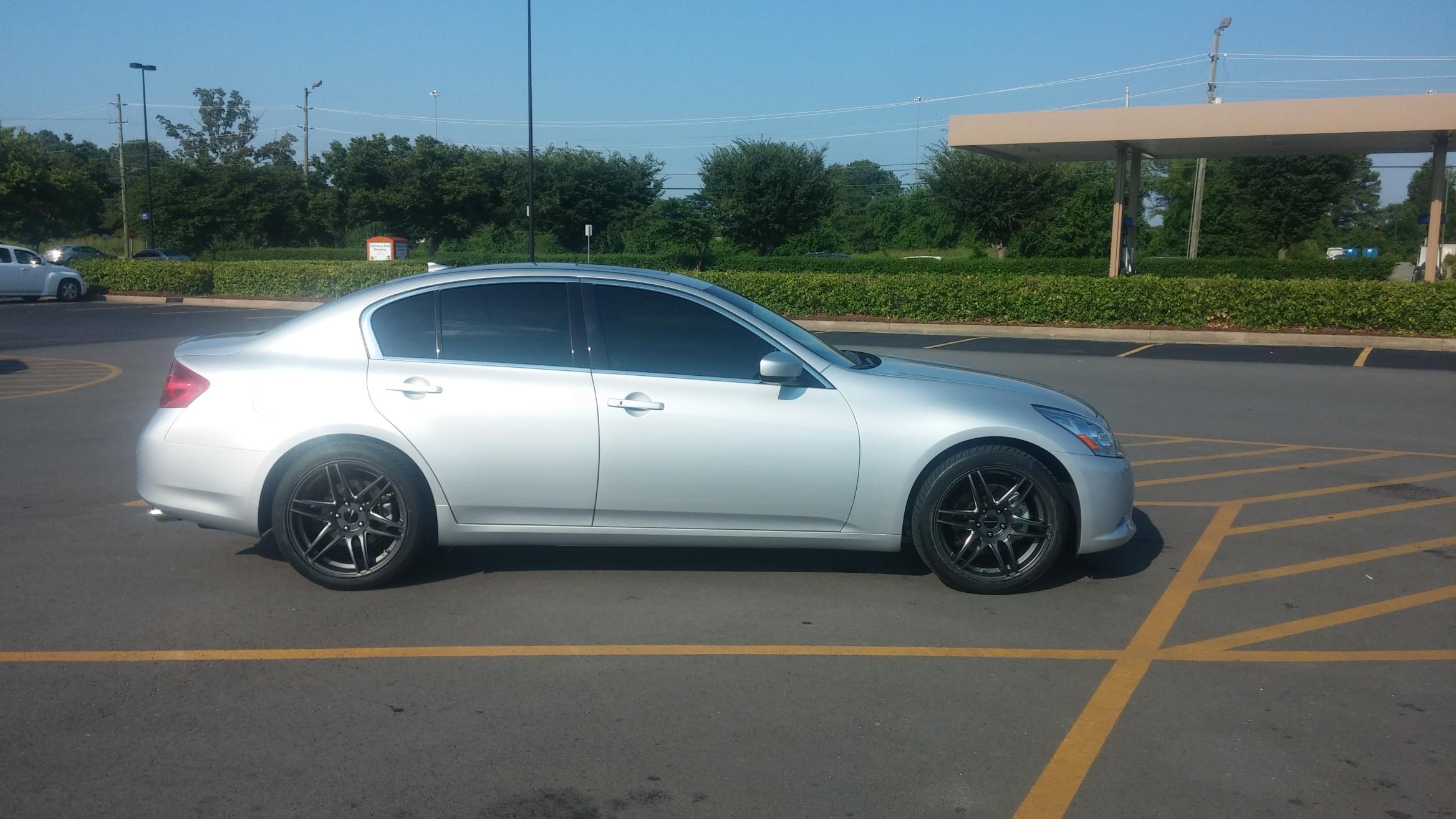

Looks great. Here is a quick pick I did of mine. My offsets are +35 front +40 rear.

Offsets are 35 and 40 respectively. I did a lot a research and I wanted to do it right, some members said that for the mild drop then just the front was necessary and the back would be back at specs but I try to do everything right the first time so I did back and front.

Yours looks great too, I love how these wheels makes the car look a lot more aggressive.

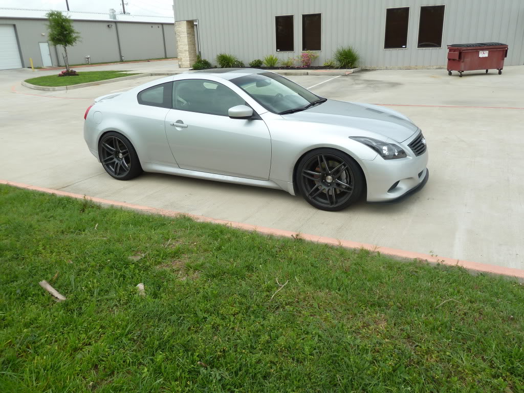

Definitely a good looking wheel. The weight on them are actually not too bad for a cast wheel. Here's how they 20's looked on my old coupe. Not really a fan of 20's but on the G they don't look too bad as long as they aren't blingy.

I agree, actually your car inspired me. I hope you don't mind me copying it. The ARK exhaust is next then I'm looking at the Stillen splitter and I am also looking for a diffuser.
