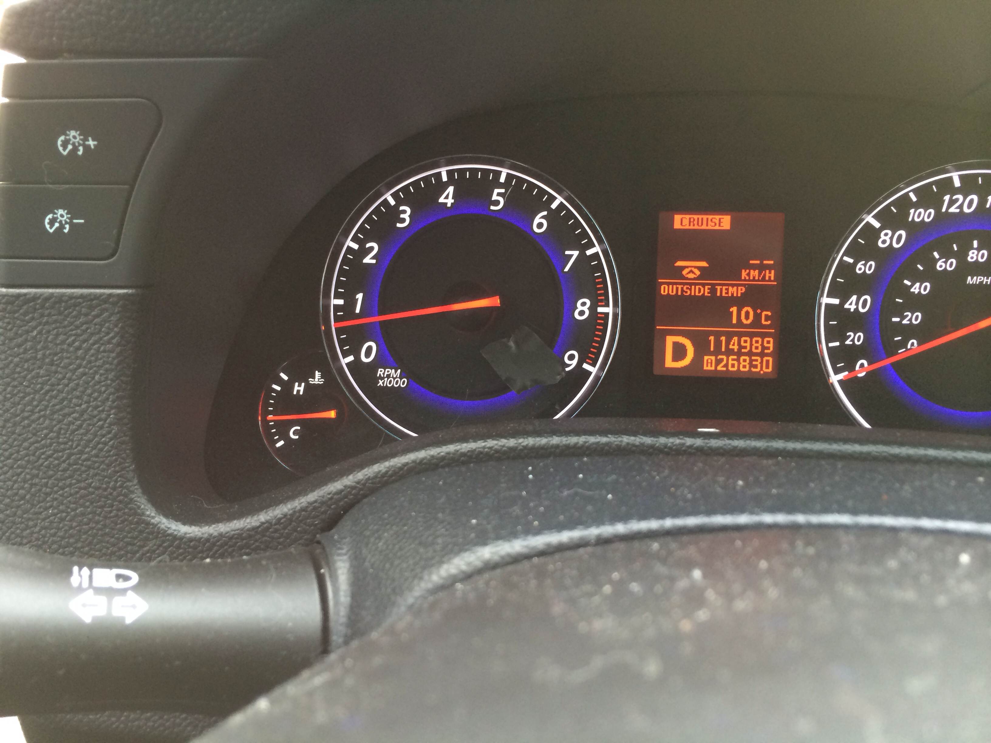

Originally Posted by Bournano
get that annoying TPMS light off.
NEED ADVICE! TPMS -- Recently got new wheels/tires...-zysogvp.jpg
That's the trick I use I did cut the tape nice & square though.
