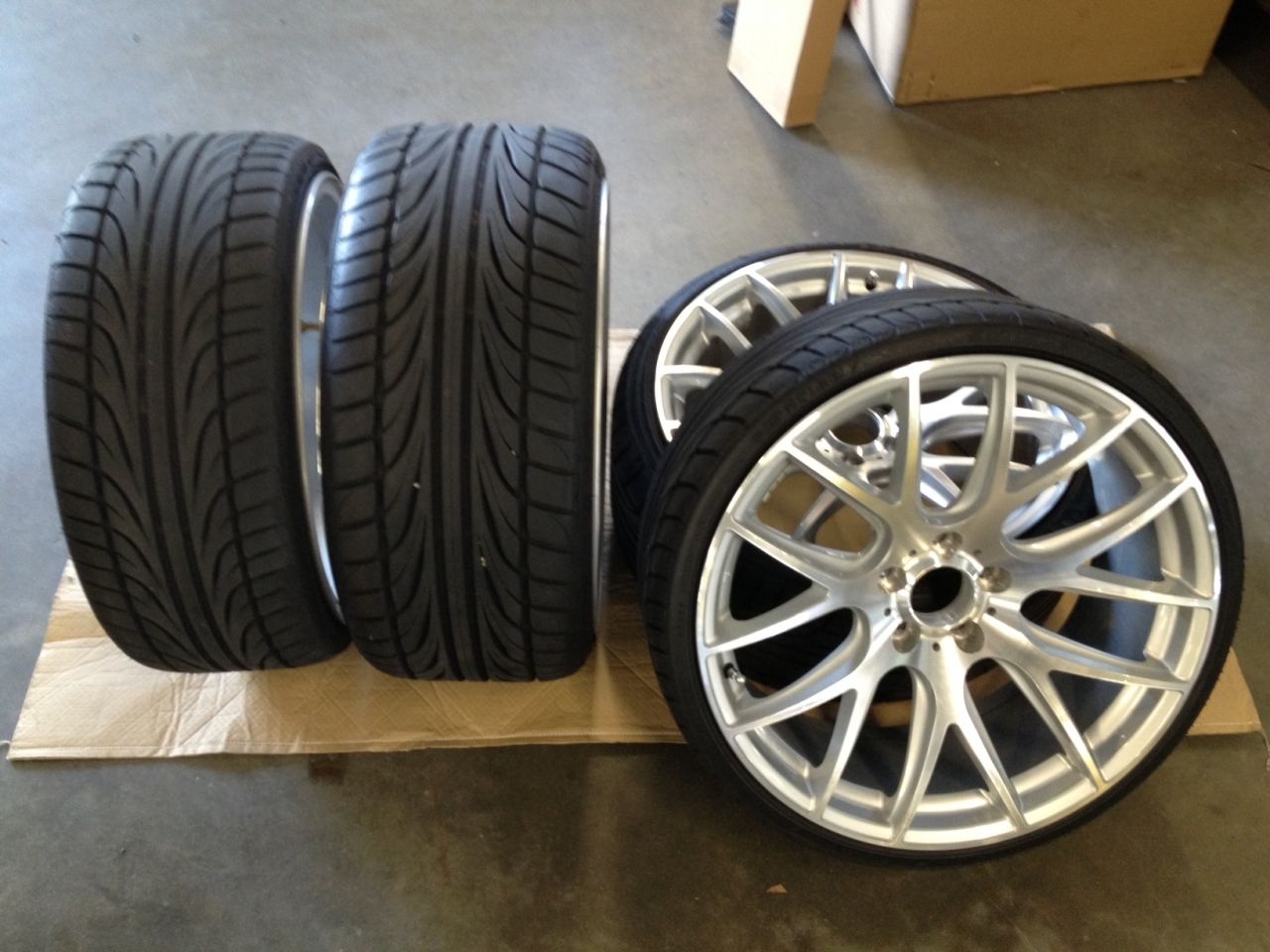

What's up guys. I'm looking into grabbing a set of 20" Miro 111 wheels for my X sedan at a pretty good price but I have a couple concerns..
First, the guy selling these said that these were given to the previous owner as blanks (no bolt pattern) and drilled to 5x114.3. After a little research, these wheels are most common for euro applications and come from the factory with a 5x120 so these wheels with a 5x114.3 would have to have been redrilled. If these were in fact redrilled, does this pose any issues I should be worried about?
Second, these are 20x9.5 +18 all around and I'm not sure about fitment. Per my calculations, i think these will fit nice and flush in the rear but I'm think these may be too aggressive in the front. I'm not opposed to running staggered tire sizes in order to make the fronts fit but I know I need to stay within 3% rolling diameter for the awd. FWIW I will be dropped on Swift springs for now.. Any thoughts?
But man these look nice...
Attachment 102577
Attachment 102578
Attachment 102579

Great looking wheels, unfortunately those offsets are way aggressive for a sedan w/ a traditional drop and stance. If you were slammed, running heavy camber, rolled front fenders, stretched tire sizing it's possible but a lot of work.

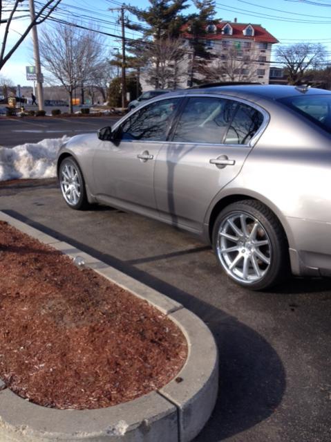

As blnewt said, the +18 wont work. Front 20X8.5 +24. Rear 20X10.5+45. are what I'm running there very tight.

No Rennan C10's 20's just bought them from a member on here and installed them yesterday . The look GOOD , dropped will look super

Glad you got them on, that was a nice deal if I remember correctly. Look forward to some dropped pics, BTW what tire sizes are you running?
It was , the 245/35/ZR20 and Rear- 275/30/ZR20.
, Didn't change anything. Cant wait for the drop either LOL
