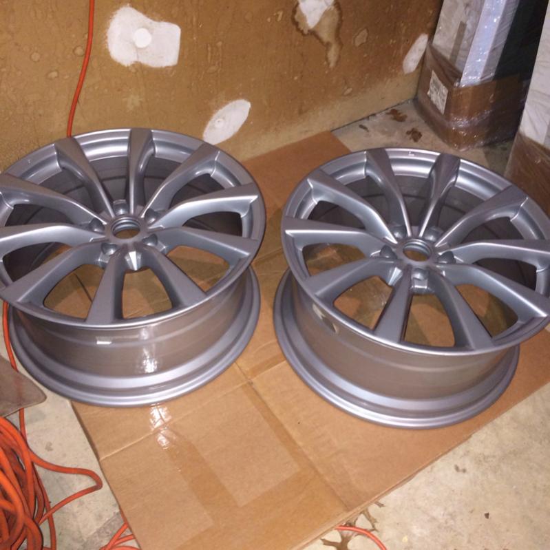

Correction - you cannot use staggered setup right from the IPL coupe without purchasing new tires for either the front or rear. The tire sizes that come standard on the staggered coupe wheels will cause so many issues with the AWD system, braking, traction, etc. review what Brad said above.
I have the regular staggered coupe 19s and plan to run a 245/40/19 as Brad mentioned. This size tire will minimally effect the driving systems that the G uses, and won't cause any issues. Just wanted to correct you before OP goes and gets wheels and throws them on.
I refinished these and picked them up from powdercoat today - turned out really nice.
