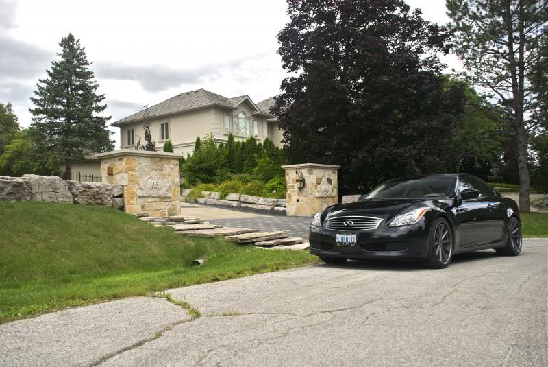

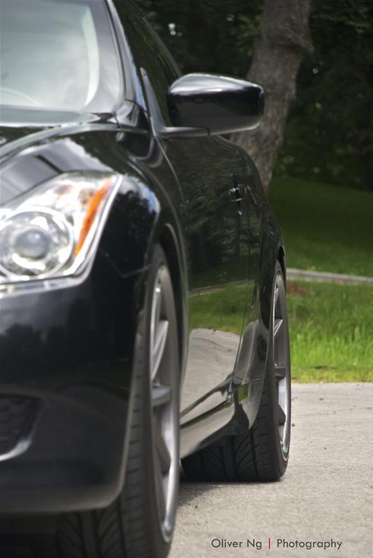

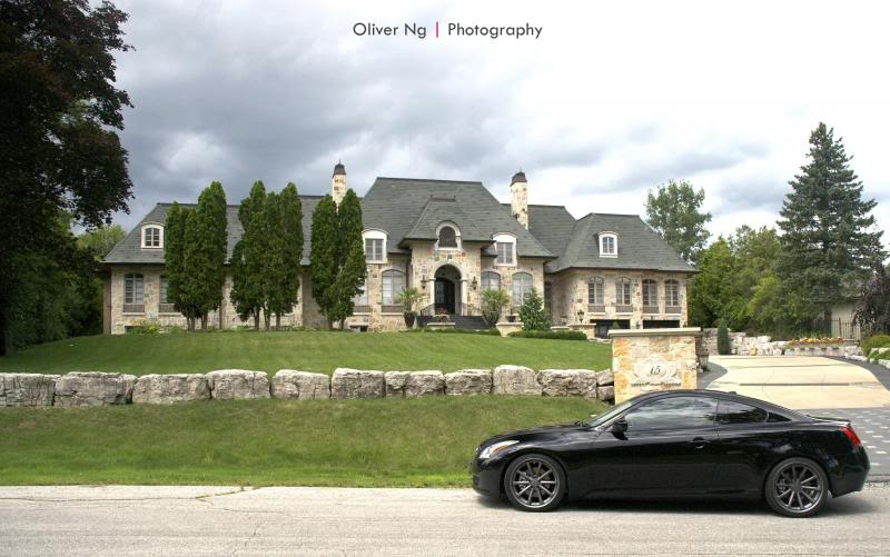

Hey Everyone. So before I dropped and choose wheel fitment I searched this forum thoroughly and couldn't find much useful info for x's out there.
Just thought I would share this to help others looking for some info.
Lowered on Eibach Prokit
The drop achieved is pretty significant and still OK for winter driving. I think, haven't drove on em through the winter yet. It's obviously a little more stiff than stock and you can definitely feel the road more, being almost 1.5-2" closer to the ground. Way less roll on turns, like off ramps on the highway. The handling has improved 10 fold. No joke.
Wheel Fitment and Tires
I chose the Vossen CV1 wheels in matte graphite and Hankook v12 tires
20x9+32 245/35 Front
20*10.5 +42 285/30 Rears
I didn't have to disconnect the AWD system for those who are curious. If you go online and find a wheel diameter calculator the rolling diameter of both front and rear are within 3% of each other and both within 3% of the stock rolling diameter therefore it does not mess with your AWD system.
I do not have the camber kit and found out after that I probably should have purchased it for the rear (at least). My front camber is maxed out at about -1.6 and rear is about -2.6. The alignment shop suggested that I get the rear kit at least or my tires are gonna wear out quickly. I am looking to get the rear kit asap. After speaking with a few people they all insist that this amount of camber is still OK, but with soft summer tires I don't really want to risk wearing them out quickly and I am also going to buy new winter tires and want those to last as well.
These wheels are a bit heavy and I noticed that my power from start is not as good as with the stock wheels. I'm not a race car driver, although sometimes I behave like I am, soo its still OK for daily driver. If I had to choose again, I would probably go with lighter wheels. Don't get me wrong, it still looks sexy... hehehe but looks aren't everything are they??
Hope that info is helpful for some of you that are looking for guidance before lowering your AWD coupe.
Feel free to leave your questions/comments.
Some after photos....

I don't forsee any issue being low in the winter. I'm not slammed. The ride height if you can see in the pics still is about .5" wheel gap in front and rear.
