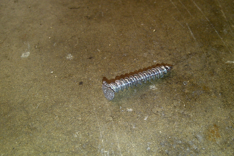

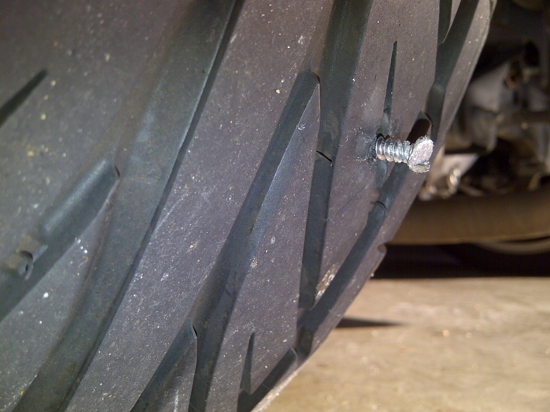

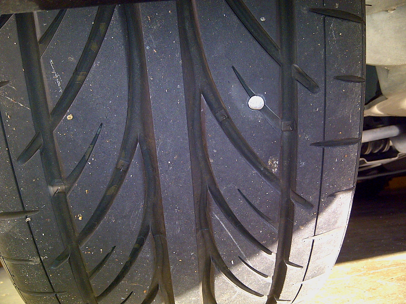

A few weeks ago the tire pressure sensor showed low tire pressure. Today, after washing the G I decided to inspect the tire because the low tire pressure was on again.....Surprise

Dang that looks like a new tire...

Looks like a New Tire...yet thats good that it was towards the Center of the Tire rather than by the side wall...plug and shave then have them put a flat patch will do the job..most just plug I like doubling up...

Actually, a few minutes later the tire was fixed just with my handy tire fix kit

You shouldn't have done this. What did you do with the tire fix kit? You really should have brought it to discount tire. They dismount the tire, plug the tire, and than patch it from the inside.
I know the same nail feeling. I bought brand new tires and not even 50 miles / a week and I had 2 nails in the same tire, on two different occasions.
