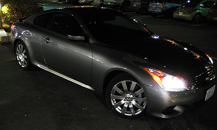

I have a 2008 G37S Coupe (My summer oem setup is 225/45/19 fronts and 245/40/19 rears). I had been running a winter set up with an 18 inch rim with 225/45/18 on the front and 245/45/18 on the rears - just wondering if you would recommend another staggered setup. I know a lot of people run 225/50/18 all around - but then you loose that staggered setup. Winter set up below.
Last edited by Loki123; Nov 28, 2012 at 11:34 AM. Reason: wanted to post a pic of the setup

The fronts are a little short, but do make load. Seems that set up has been working ok for you. I'd keep it as is or in the future move into a 225/50-18 up front.
