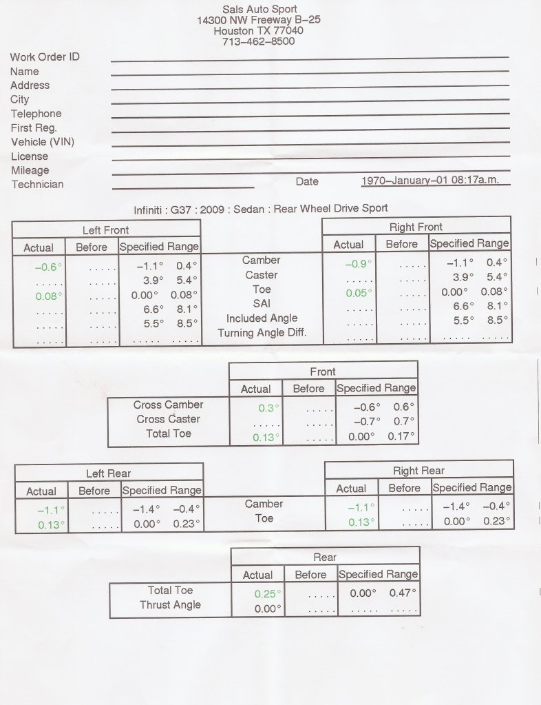

Here's the printout from my alignment couple months ago. Does it make a difference that it shows the vehicle as non-sport when I do have the sport model? Let me know what you think...

That looks fine. I meant to check it now and post where it is currently.

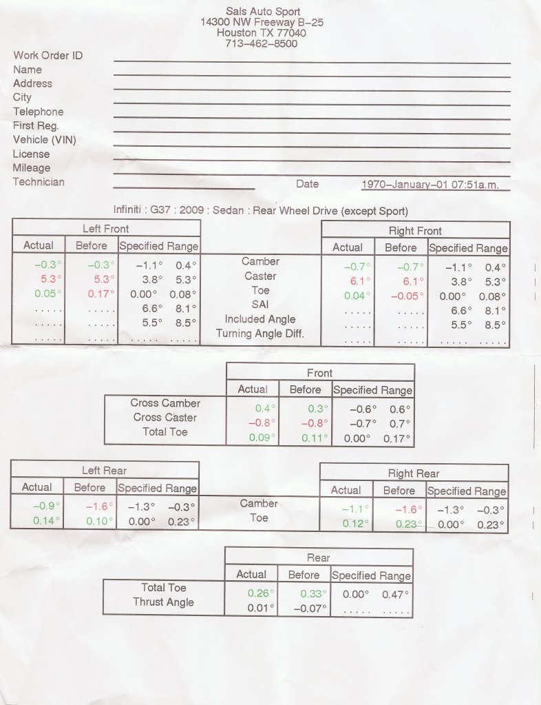

Okay just got another alignment today. Sal said he was going to add a little more camber to get the toe better in the rear. Thanks again for your help!
