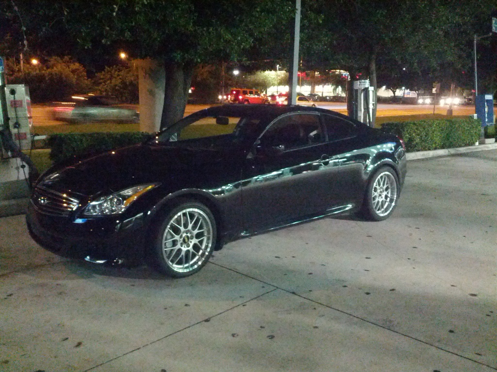

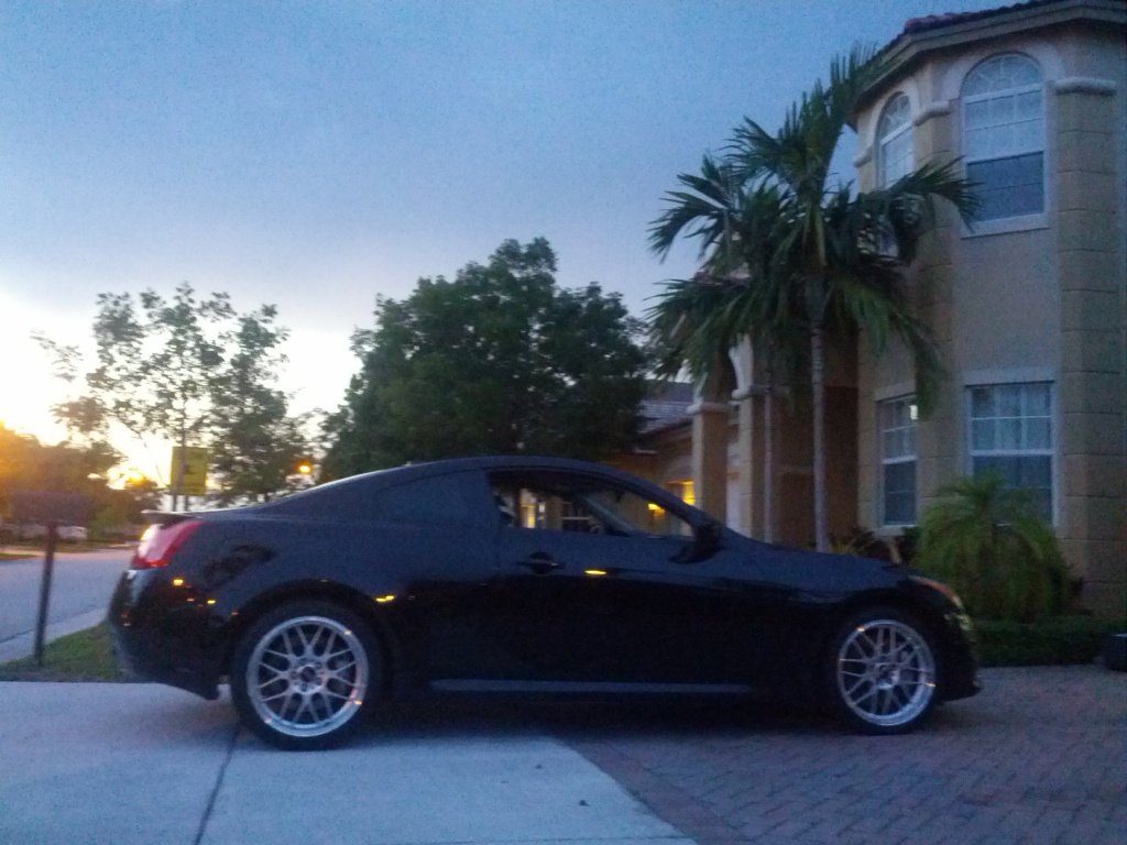

Hi guys, I finally had some time this weekend to start modding my G37 after owing it for 2 month. I installed the Eibach front sway bar (didn´t have enough time for the rear one), some led interior lighting, led reverse lights, PIAA fog and parking lights, and the most important thing I put on the wheels that I had on my previous G35 coupe, BBS RGR 19"

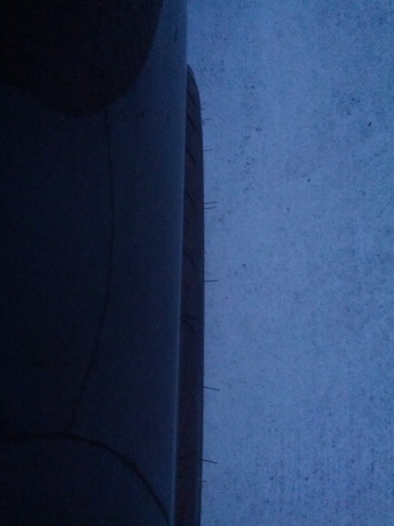

I really like the way the wheels look on the car, maybe the look a little to small but I´m still happy with them. Now the bad part is that I´m having rubbing issues and not even lowered (yet). What should I do, should I buy thinner tires and stretch them or should I pull my fenders out?
My set up is
Front 19x8.5 +18 with 245/35/19
Rear 19x9.5 +22 with 275/35/19
I only have bad cellphone pics right now, I will try to take better ones this week

Rear fender
What do you recommend me?

I bet it would work if you don't mind putting some work into it. Like lower it which will camber in then trim your bumper bracket and fender liner. Worse case is you can run 255-35 rear and 225-35 front

Tires are a bit on the fatter side for how wide the wheels are. I'd start with the tire recommendation Weiboy posted, lower some more and then trim the bracket if needed. You can also look in a camber kit.

Is it too risky to pull the fenders?
