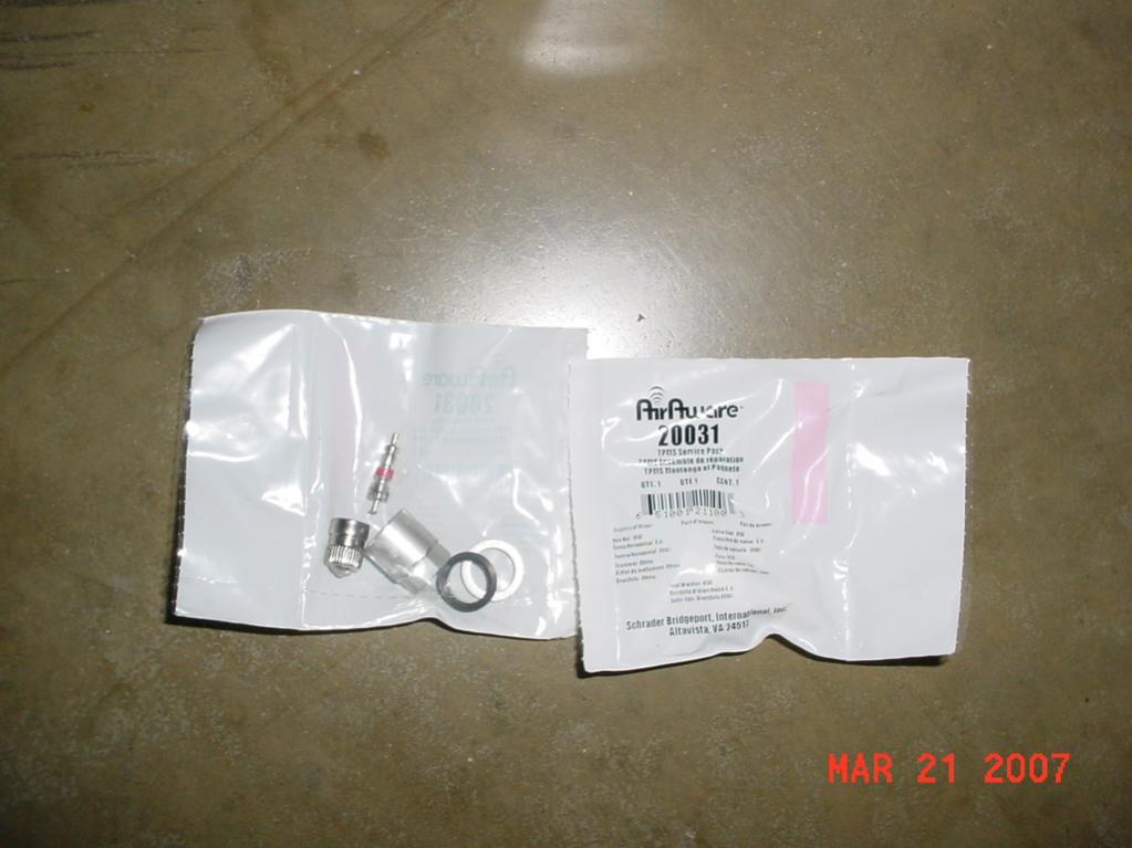

Yup, tire will need to come off the wheel to take out the sensors, then remounted/balanced. Don't forget to buy a new gasket kit so they don't leak after moving them to the new wheels. Once the original gaskets are compressed they will leak if not replaced. We sell the kits if interested.

Oh, I didn't know about the gasket kit requirement, what do those do exactly and is this something most installers know about but just don't mention when they swap tpms?

It will look similar to the attached photo. New gaskets, core, sleeve and cap. We sell them for $3 ea + shipping. Will need qty 4/one per wheel.
