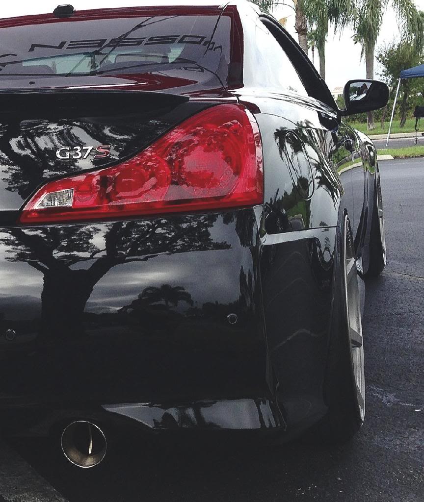

My 20x10.5 +15 with 255/30/20s

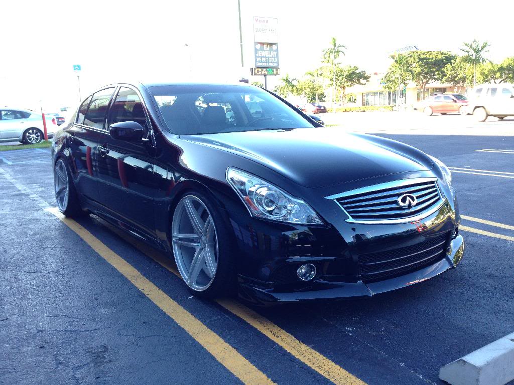

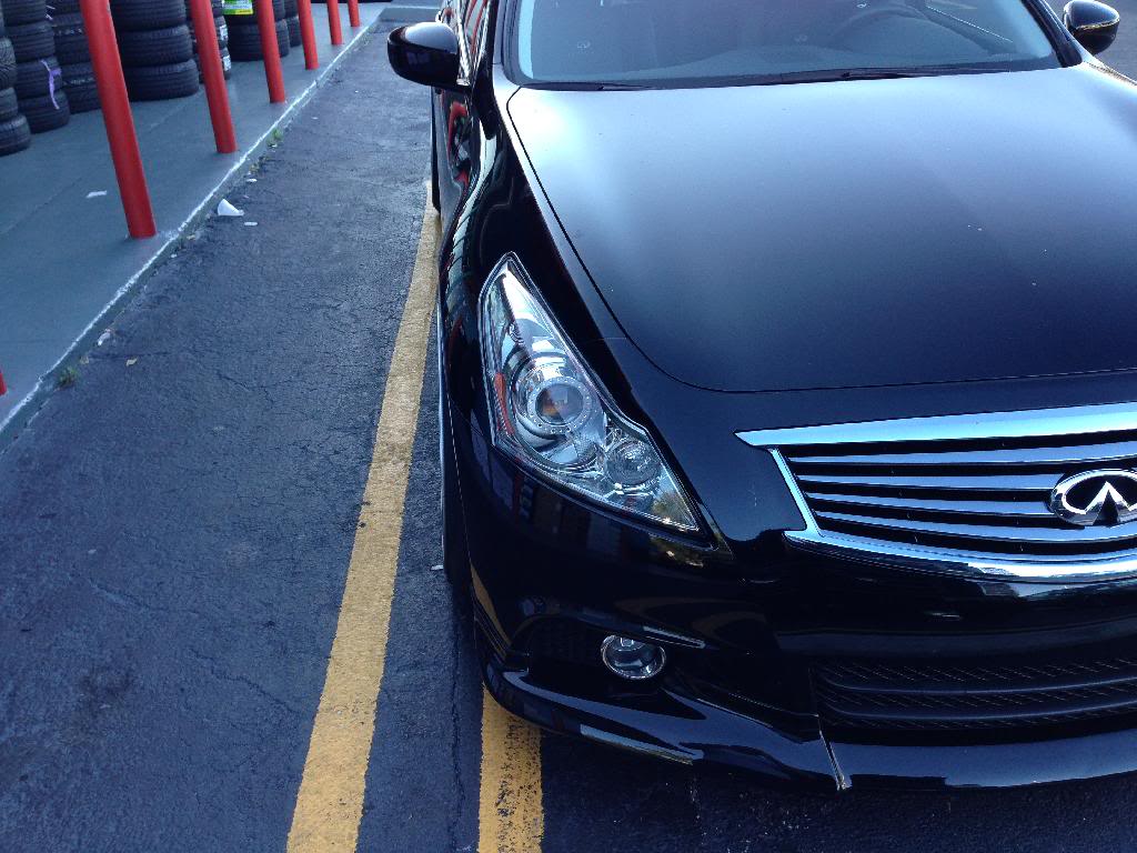

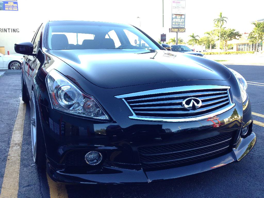

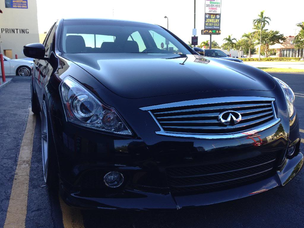

Here is a 2013 G37 Sport 6MT Sedan with 20x10.5 +25 up front and 255/30/20. No fender roll, but it is very close already. A taller 255/35 would have certainly rubbed and fender rolling may have been needed. Rear is poking out a tad with our +45 but we added a 12MM Akata spacer with a 255/30/20 tire now sitting at +33 and sits pretty aggressive. A +25 rear offset would be rubbing and sticking out way to far in my opinion.
Dropped on RS*R Coilovers
Very CLEAN!!
Overall, this sedan pulled it off just right. Yes it did need stretched tires and poked out but with a low stance everything sits very beautiful.
