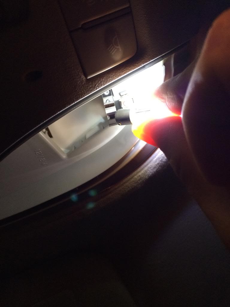

You nailed it!
Its reverse polarity. As you can see in the picture, I put the bulb "backwards" essentially, and reversed the polarity.. and it lit up like a xmas tree. Now.... to find a reverse polarity Ba9......

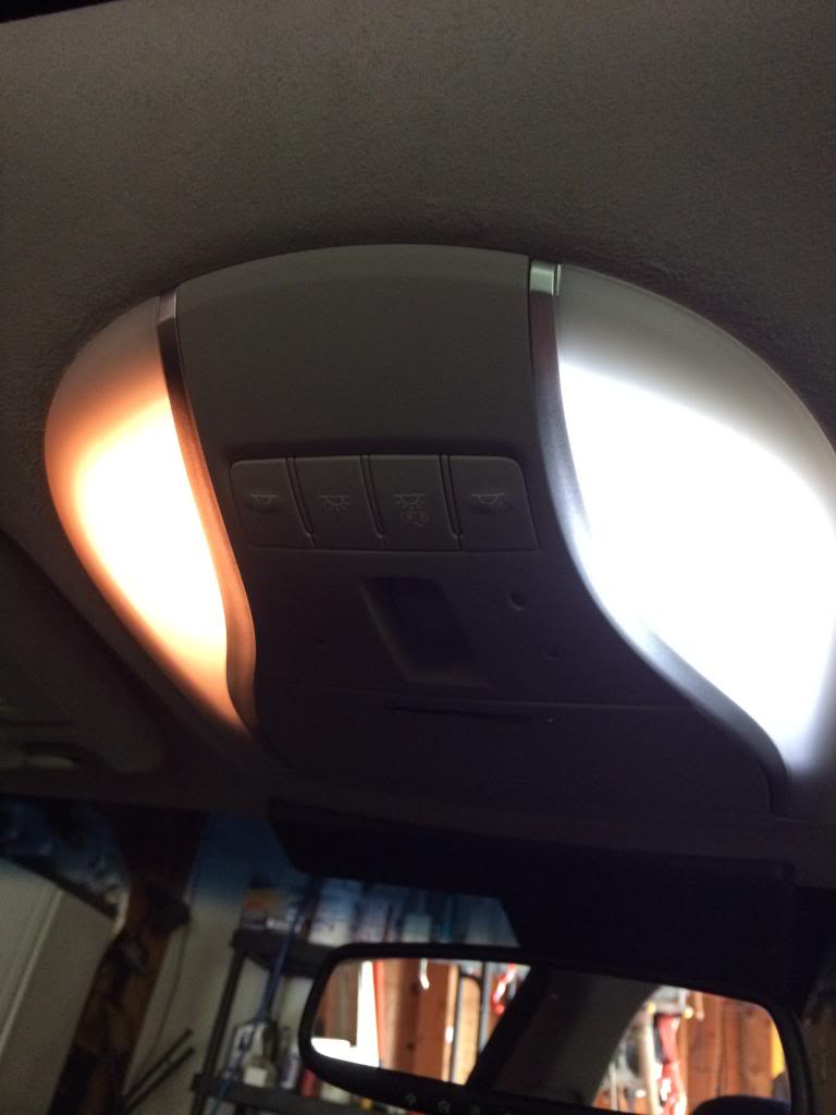

The above link to the LED worked great!! Bottom line, you need a BA9S no polarity or reverse polarity LED. The LED that I bought (BAX9S) had nubs at 150 degrees as apposed to 180 degrees, but it still works. You can buy them anywhere... just make sure they are reverse polarity. I bought the 9-LED bulb, but you can also get the adapter mentioned above and then get a 9 or 12 LED panel. I think the 9 LED bulb is nice, but a panel would be just as nice and bright.

Definitely brighter, but my interior also doesn't look like a Monday night football game either. As you can tell from the picture, the white takes up a lot more of the lens cover than the stock bulb. The ones I installed were a 9 LED bulb.... I would say its about 50% brighter than stock. Check the website that I got them from, you might be able to compare the lumens to that of your VLEDs, this way you don't have to experiment with your money.
