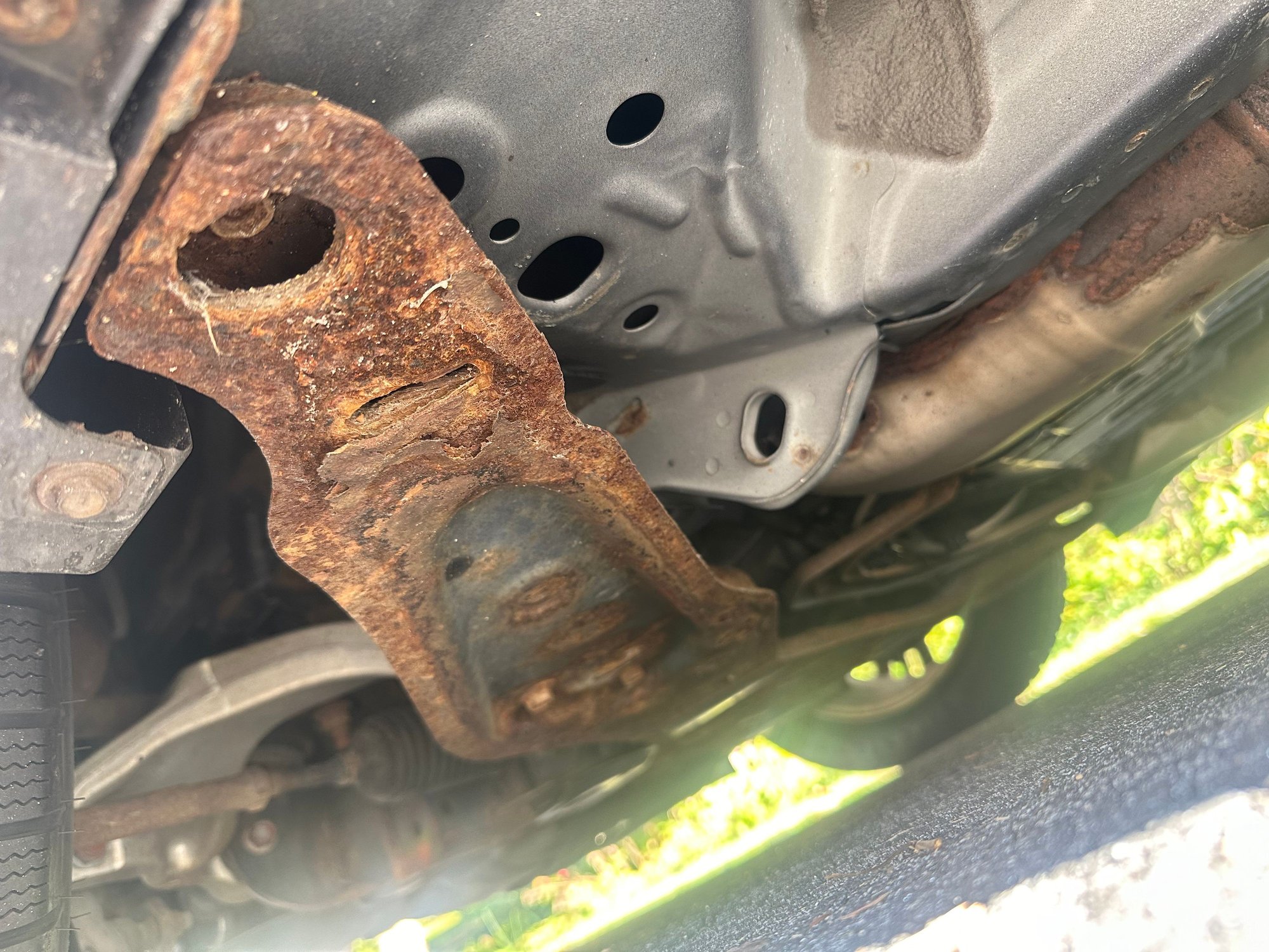

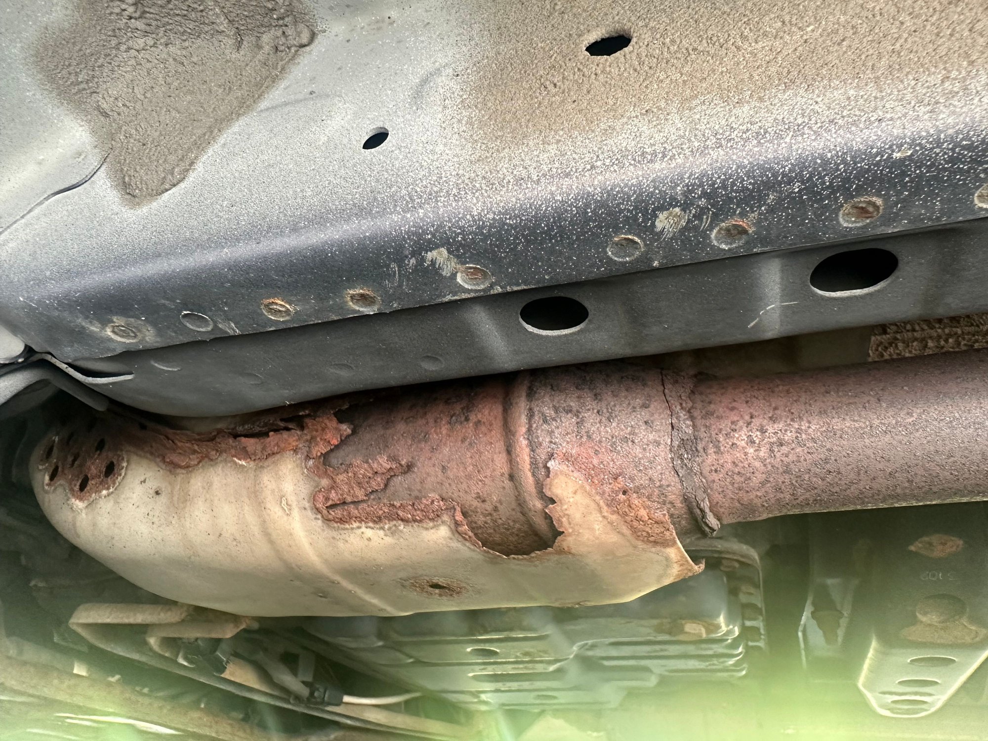

Hello 2013 g37 sedan shakes when I’m braking I’m so bad with cars so have no idea what’s going on just got new tires but looked under my car and see a significant amount of rust what could be causing my car to shake when at a light or just on break. My only vehicle and not much $$ please help on where to begin with this problem.

Shaking when stopped at a light? Could be worn out motor mounts, or the engine misfiring because of old plugs... IDK just spit-balling. But a rusty heat shield over your cats sure isn't it. And that cradle brace in your pic is a lot stronger than it looks, rust notwithstanding. Time to take your car to a trusted repair shop. If they come back at you with a laundry list of problems that blow out your budget, then work with them to prioritize repairs over time.
