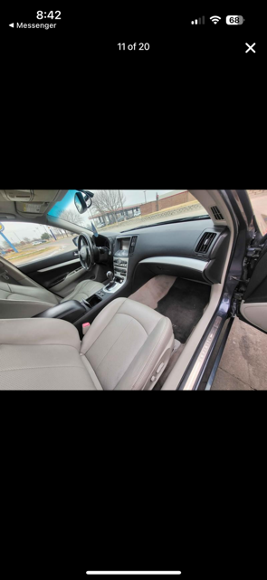

First you’d need to identify what needs to be replaced, swapped over, repaired, etc. Are the jacking points rotted out? Then you’ll have to make sure you have all the tools and time to do it. Then there’s the matter of actually taking everything off the car. Rust, wear, improper maintenance almost guarantees you are going to break something. And then assuming everything went well and you got everything swapped over to the new chassis you’ll need all new fluids, have to recharge the A/C, an alignment.
I once had an old 07 Nissan maxima that needed the works. All new suspension joints, a pleathora of assorted engine sensors, a new transmission. The dealer quoted me $16k to get it back to running like ‘new’ and instead tried to sell me a car. They would have made more money off of the repairs! But they knew and I knew it wasn’t worth it. The time I would be without the car, the logistics to obtain the parts, the hassle and the time the techs would have to spend taking the car apart, and the likelihood the vehicle will still have problems isn’t worth it.
The interior of your sedan looks nice and well maintained. If the frame rails are rotted out though, then parting it out is something to consider. It will take a while but at least you will be able to recoup some of your money if not make a profit depending how you play your cards.
