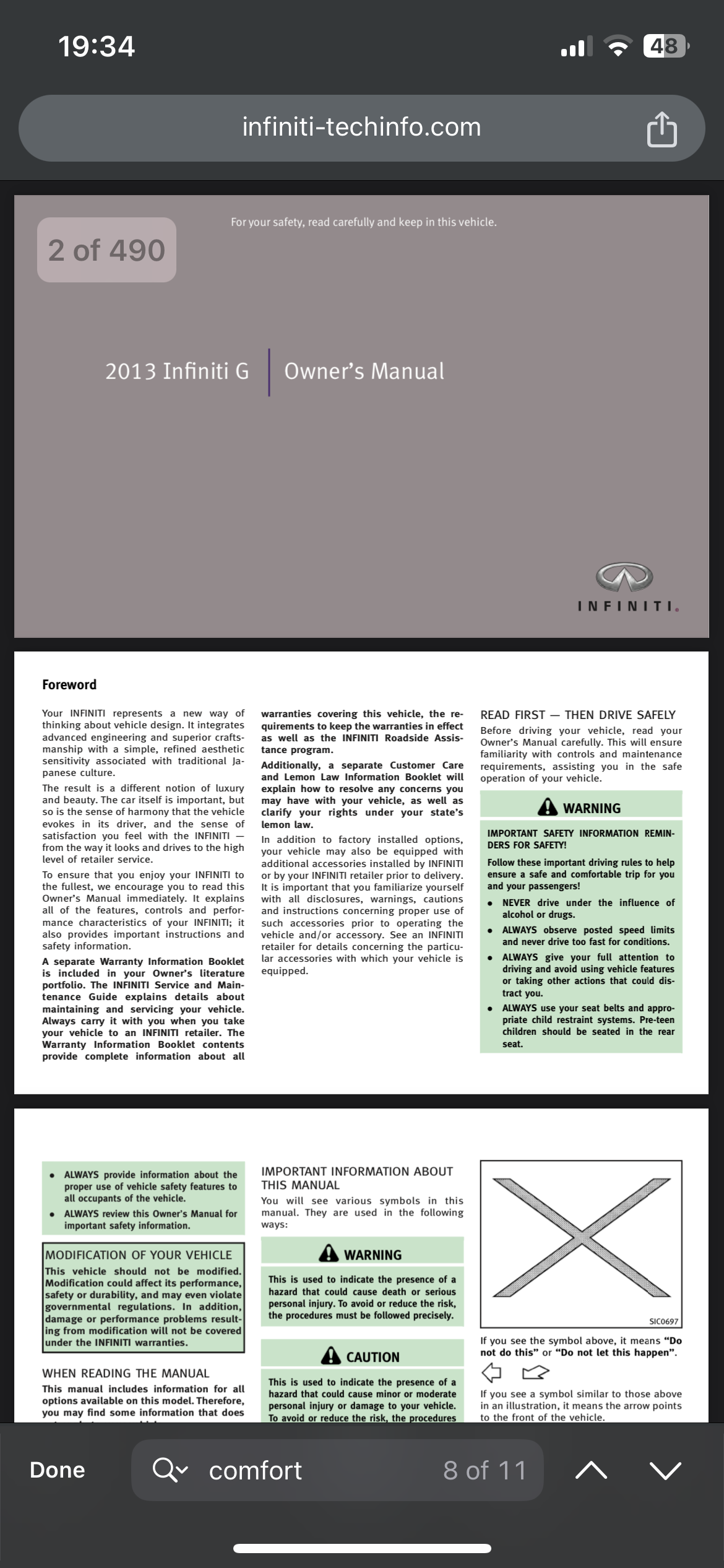

Hello everyone. I'm here asking questions about consult 3 plus due to me losing my settings due to playing around with my hidden diag settings and checking if I can have my car reverted back to normal? I could really use help from a technician that has experience and doesn't just tell me no and that my car doesn't bring the features at the dealership when I ask for help. I have a 2013 INFINITI G37 Sedan Journey with premium features non-nav model and my friends in the video I showed is a 2009 model journey as well. I understand I get what I deserve for messing in hidden settings but I recall correctly in a forum before posting this one they can reprogram it but they just don't want to due to laziness.
