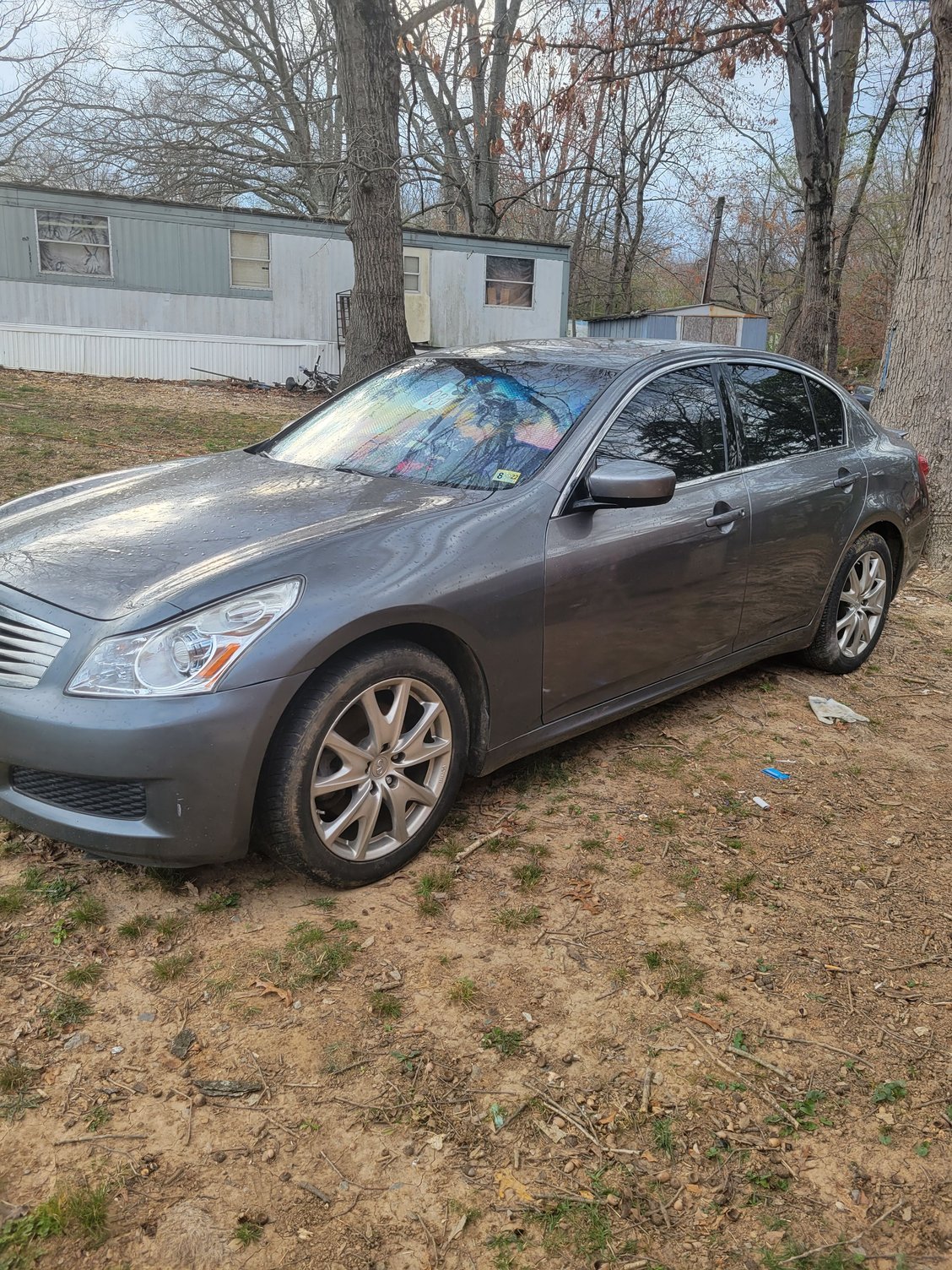

HELLO,I Just Purchased An '10 G37xs woman got crazy man try bypass wire harness so her husband took it too nissan and now the car won't come back on I've read lots these threads like I do see dampness on passenger side,the start of her problems was no dash lights no heated seat and I think radio was working.now the car key won't recognize locks or the manual slot she brought a new key guy couldn't get it programed? Am I making any sense sorry any suggestions would help thanks everyone

IDX whether this matters, but that's a 2009.
title says 2010 ?

Originally Posted by Mxrobey19
title says 2010 ?
Well, that's not a 2010 front end. I bet you it has a 2009 rear end, too.
Put your VIN into the decoder: https://www.myg37.com/forums/vindecoder.php
You know, the driver's side fender paint doesn't match the driver's door at all, so maybe there was a repair job at some point, and they went all frankencar on replacement parts?
I've asked her teenage daughter backed her car into her mom's and they couldn't find a bumper with kind-of same paint so they went that! Thanks chief something else I can work on in future gett8ng right kit and repainting!
You'd need 2010+ headlights as well, making that a very expensive project.
Good luck.
