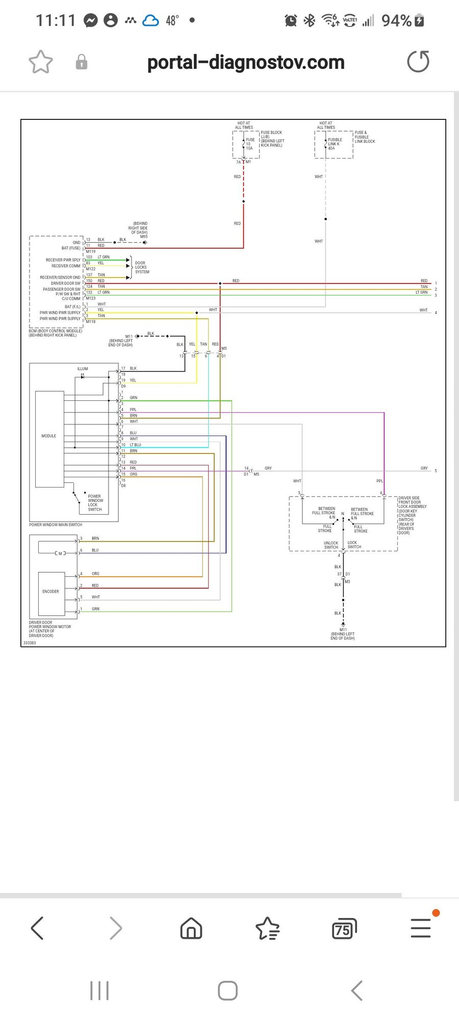

exactly I should've done bit more research but car was fine until clusters and Nissan old man re did wire harness HOPEFULLY I can figure it man !
is this the correct wiring ?

I don't know what that ⇑ is.... It's not clear for me to make out.
Just go here, navigate to your car, and download section PWC (Power Window Control System). This will have everything you need to figure out the windows.
I would take some time and download the whole manual as it will prove invaluable when working on these cars.
