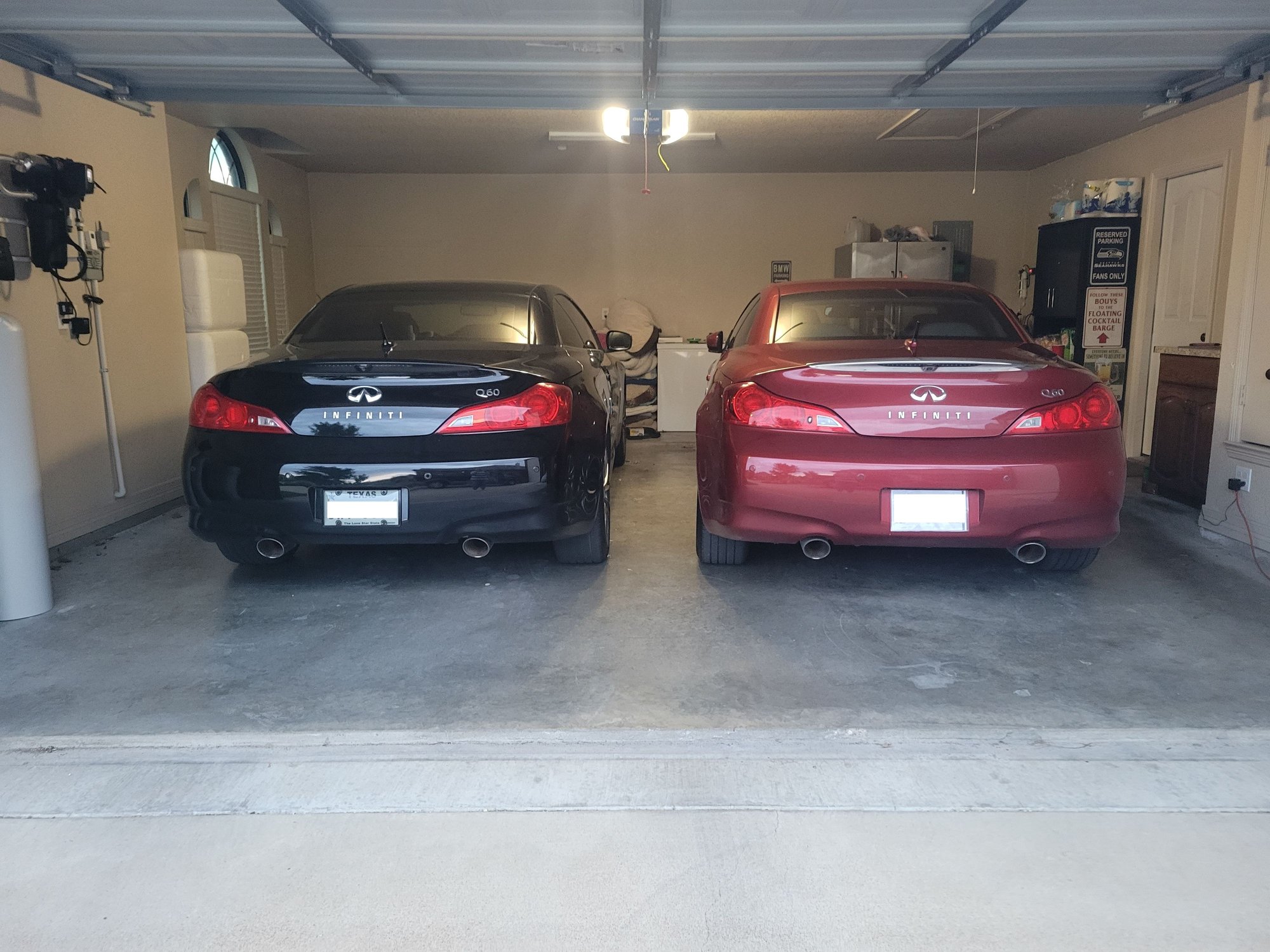

2015 Q60 Verts
Hi all, I have 2-2015 (yes 2!) I bought mine and made the mistake of letting my wife drive it! Now we have 2! Love the cars. battled a non-working top on her Red Q60, SCREW Infiniti! They are crazy about their $$$$ costs. I replaced the water soaked pump and relays and it almost works perfectly! For1/500th of the $ Infiniti wanted!! They quoted $10K USD!!! for just the pump and it was really the 4 relays!! Still having issues with the windshield latches missing, but working on it. Any advice to get alignment correctly, much appreciated!
Love driving these!
Real reason for joining the forum was to get knowledge from real people! I know that Infiniti uses consult3+ for diagnosis and programming. No dealership near by and Nissan dealership is weak on Infiniti. I need top relearning as well as other diagnosis programming capabilities!
Any recommendations on OBD2 pass through/software combos that are the most robust for the $$. I found a SCVI-ING China interface but all obsolete. I am willing to spend the $$ to not spend the $$$$$$$$ to Infiniti, but need y'all smart people's input to get the most for the $$.
Please share your knowledge with a fledgling wanna-be vert modder! Thanks!
Ken
The twins, one's a ginger!
