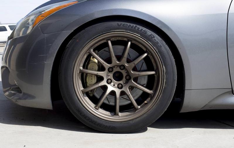

On the last lap of my last session I was trying to chase down a ZL1 Camaro and was catching him in the corners, but he was pulling away from me in the straights. Coming into turn 5 at about 140+ I braked a touch later to make up some ground, but the brake pedal got soft and I had to pull off. 1st time I have ever cooked Motul RBF600 fluid. The front calipers are also a nice shade of bronze now. Guess I won't have to worry about painting them anymore.
Heat did that? What color were they before? I don't remember.
And your front rotors... didn't you just get those last year? The discoloration on the rotor is disturbing. Track days sure do a number on your brakes.

The front brakes are about the same color as GT-R brakes now. They were more of a champagne gold color, which is what the rear brakes look like now. The rotors are fine. You are just seeing a bit of surface rust because it rained that day.
Rear brakes now
Oh jeez, you really cooked those things. I've never seen them that shade of bronze before. Mine were discolored from heat too (multiple 120 >50mph braking zones at Autoclub) and mine don't even look like that.
