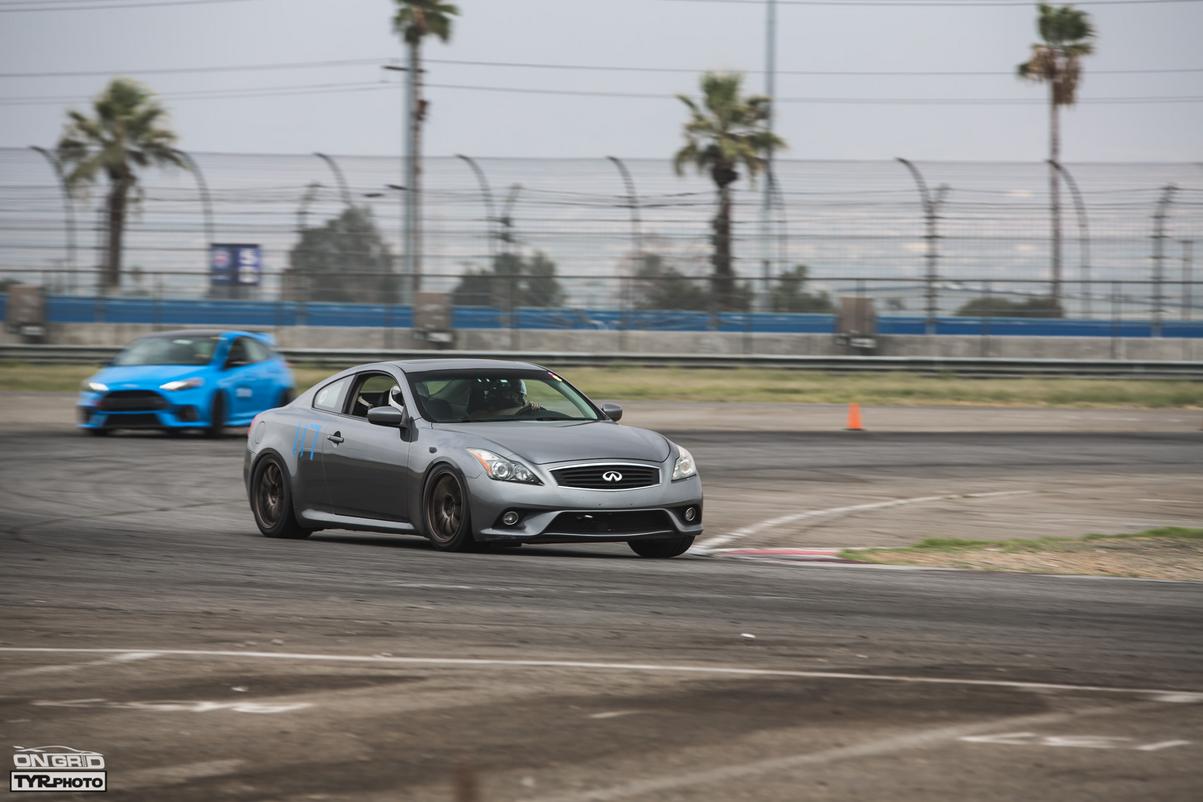

Ran another two days, this time at Auto Club Speedway in Fontana. To be entirely fair, it's a bit of a boring track, even in Roval configuration. It's fast, and that's about it, so you just point and go and point and go. I was too scared to take the banking full tilt, and consequently only hit about 125mph at the front straight before I lifted.

Hey, even a boring track day is better than "good" work day most times.

Car looks great at speed bpChaos. I run the banking at Homestead and always fight the urge to lift. Even with a cage and full safety equipment.
