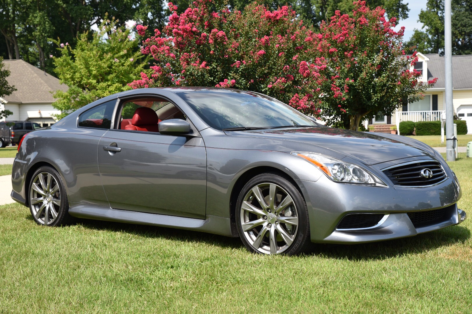

So you probably race people I know out there from NC. They drive 335's. I might come out there one night in my sedan.
I run with VDC off. Only advice practice especially on the road/track you run on.
DS mode short shifts to me which why I said shift between 7300-7500 since your not tuned to speed up your shifts.
Mods as of now
Ported upper and lower manifolds
GTR injectors
JWT Cams
ATI crank pulley
PPE longtube headers
EPS throttle bodies
3in intakes
Aluminum driveshaft
Z1 motor mounts
FI CF exhaust
Have not ran this setup yet too cold out.
Mods for the 12.7 runs.
Z1 upper manifold
NST pulleys
AAM intakes
EPS throttle bodies
eBay resonated test pipes (beluga)
eBay exhaust (beluga)
3.7 final drive
Ecutek tune by Seb at specialtyz
