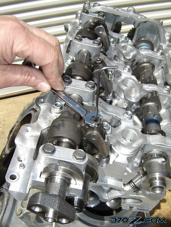

I wish Uprev or anyone would crack the VVEL ECU. That's when the true N/A street power of this powerplant will be availible to mere mortals. If they could the results would be similar to the tuning response of the VK56. With Uprev it produced a felt response to every single mod. From my first intake all the way through to JWT cams and a 90mm LS7 throttle body. The independant VVEL ECU and that "Magic Screw" ( Like a free set of cams minus the labor ) are the keys to the Bolt on "12 seconds" kingdom.
Attached Thumbnails Dynod my car and almost got a Uprev tune-magic-screw.jpg
