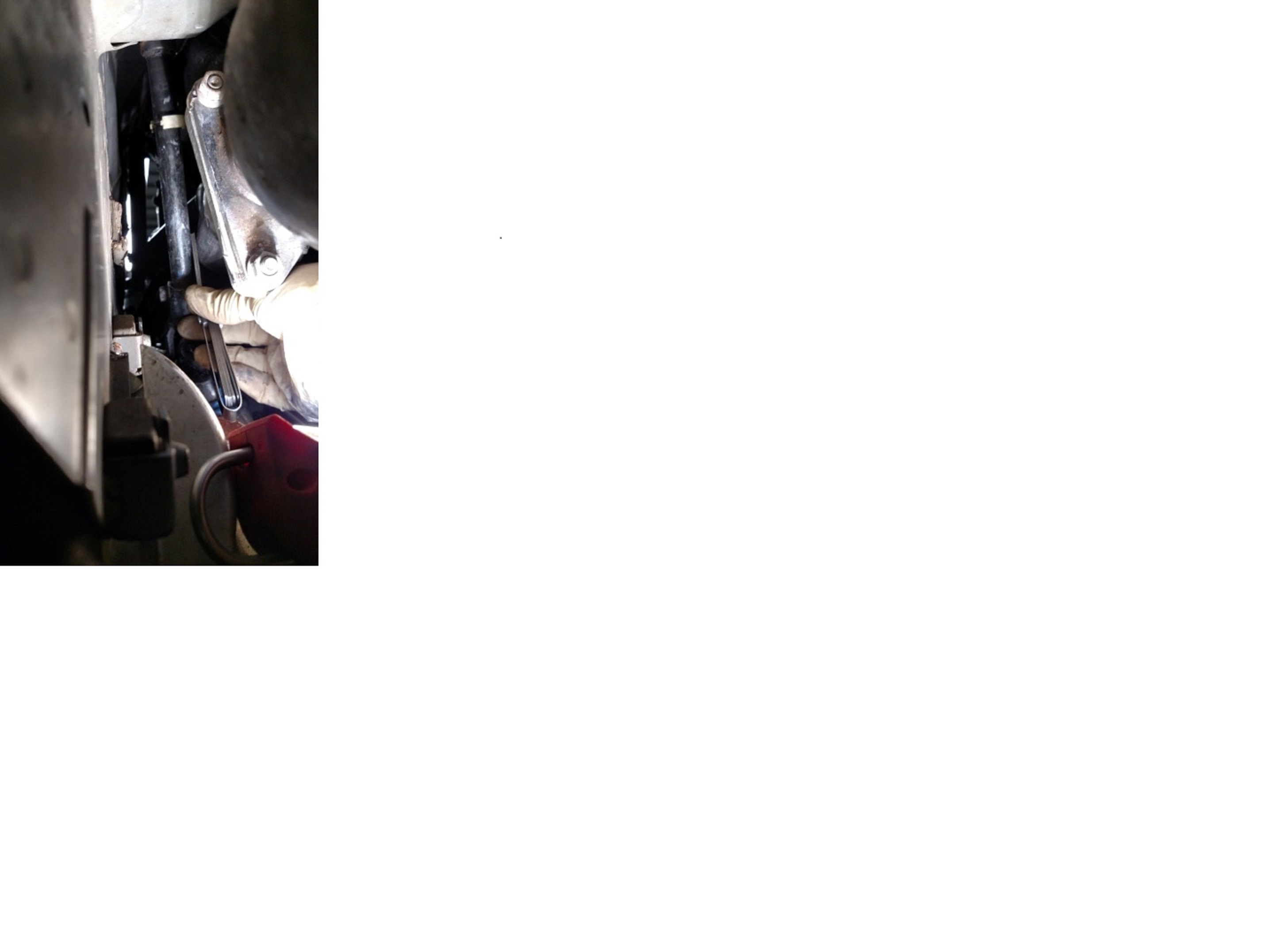

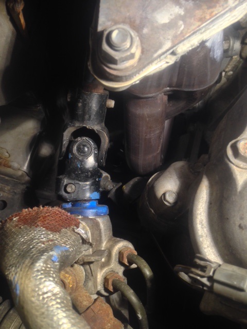

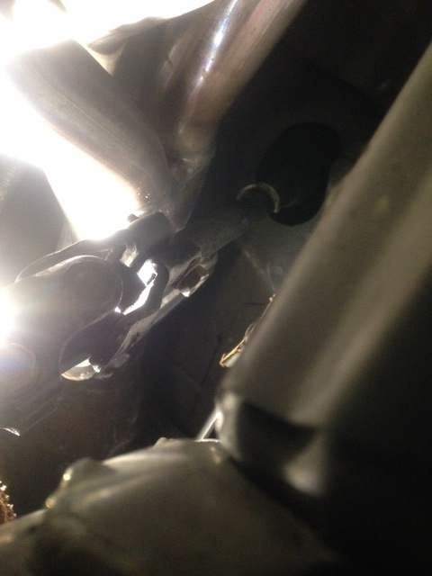

The vibration is bad but again only when "banking" the car right. Yes when they are "hot" the gap is smaller.I don't drive the car cold some cant tell "if" its cold it touches. I wanted to try to track the car once this summer. Here are a few pics. Remember guys this isn't touching under normal driving. An its hitting the collector part of the header

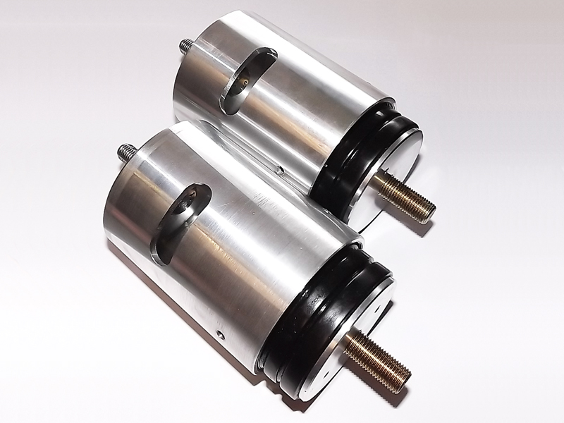

I am ! Order then this morning I like the fact there adjustable also

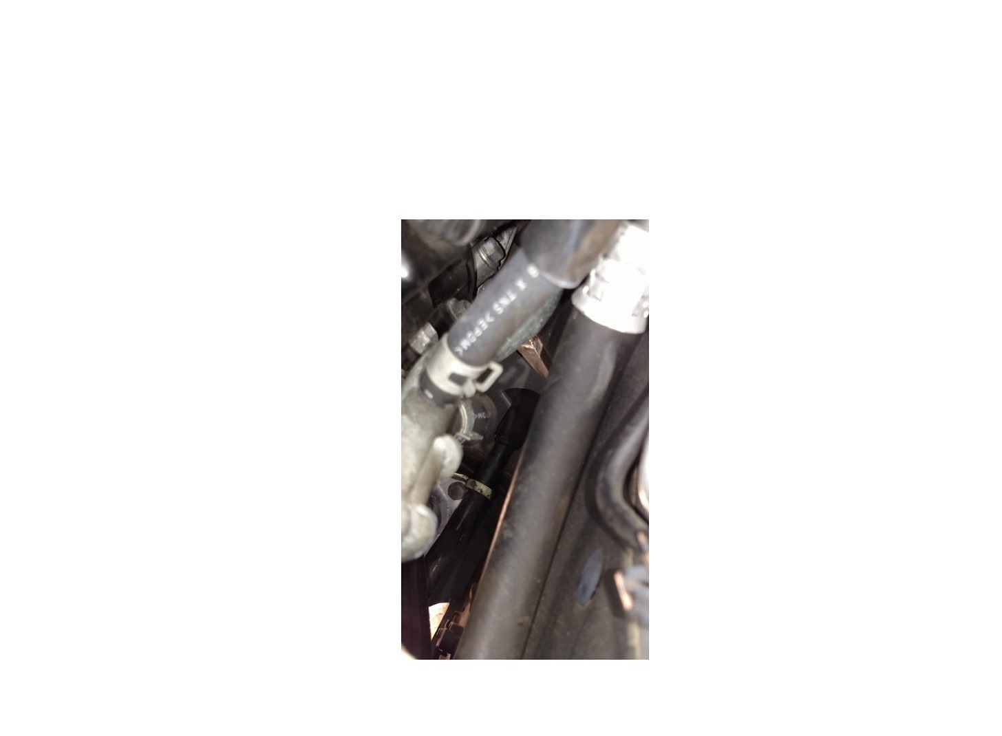

Just a few more we had,

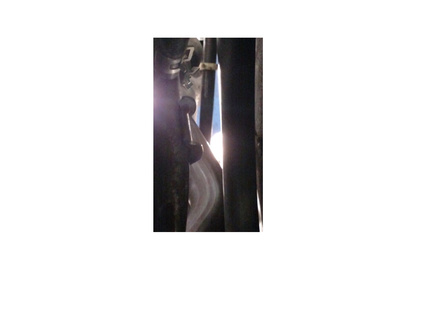

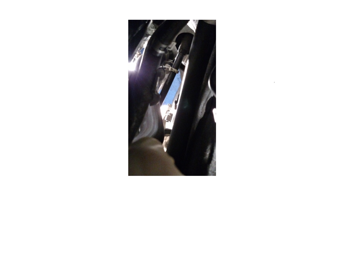

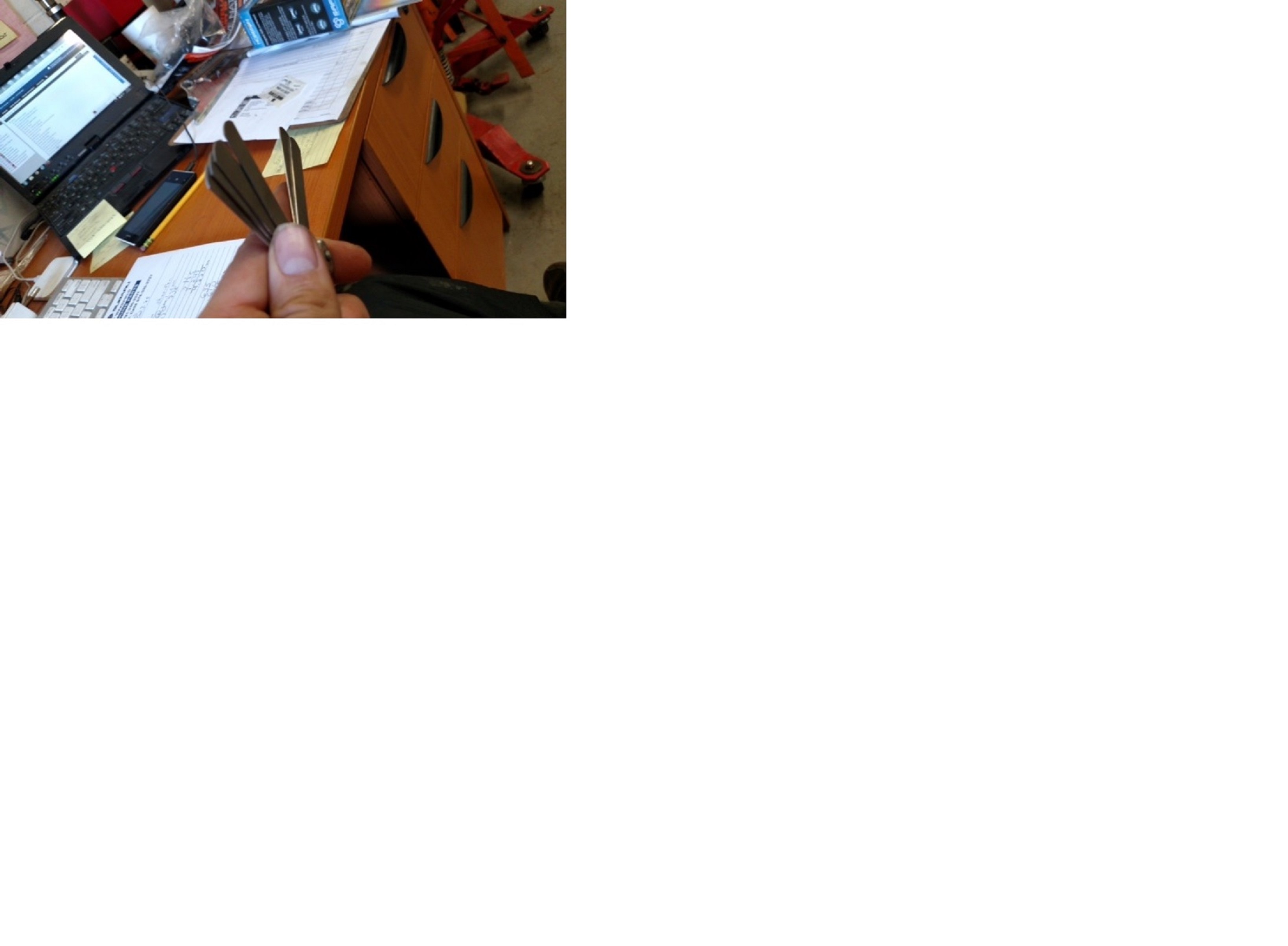

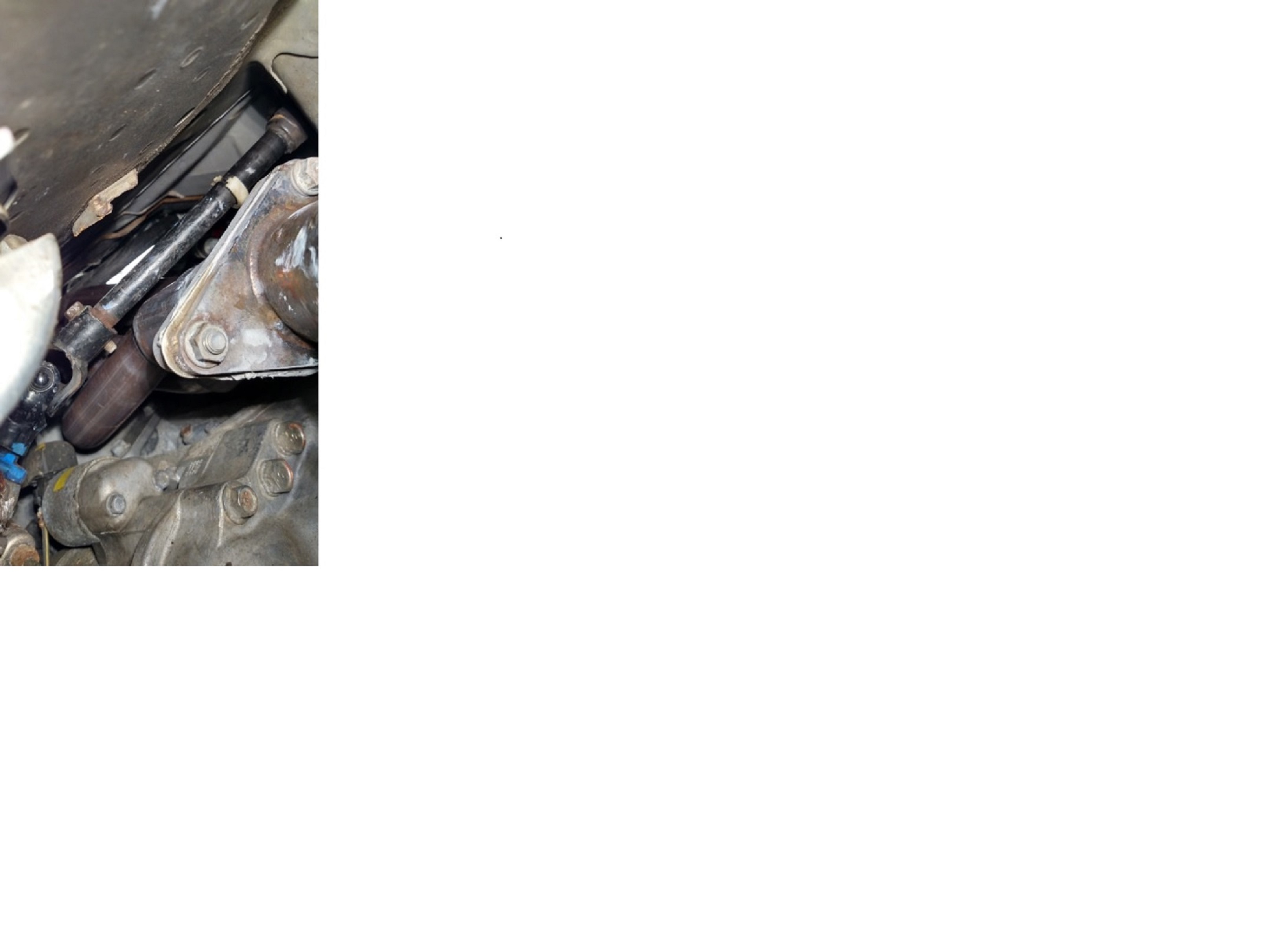

So here is the tech's break down, BTW MUCH PROPS to Jason @ Motive!!
This is the email he sent me:
I wanted to take this time to email you the information I was able to get for you today. I will be breaking this down with the math on how close this header is to the steering shaft. Take a look at here Before anything was touched. ( PICS are in order in from the email)
Just 3.175mm in space! ( From the headers to the steering shaft.
After the mounts and a little adjustment on the rear mounting bolt for the exhaust yielded a gain of 1.245mm.... Adding the two blades to the right into our new total of 4.220mm
Attached Thumbnails Stillen Headers-stillen-header.space.jpg   Stillen Headers-stillen-header.space.2.jpg   Stillen Headers-stillen-header.space.blades.jpg
