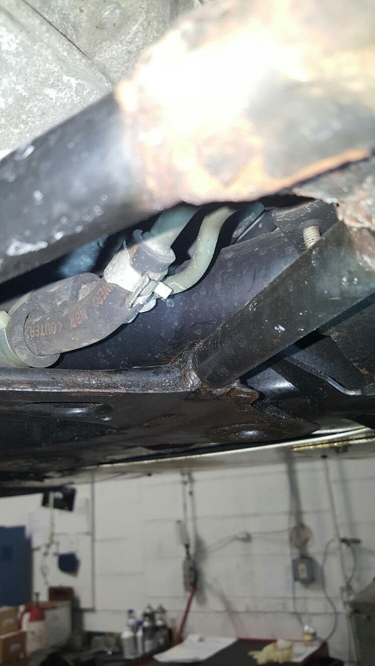

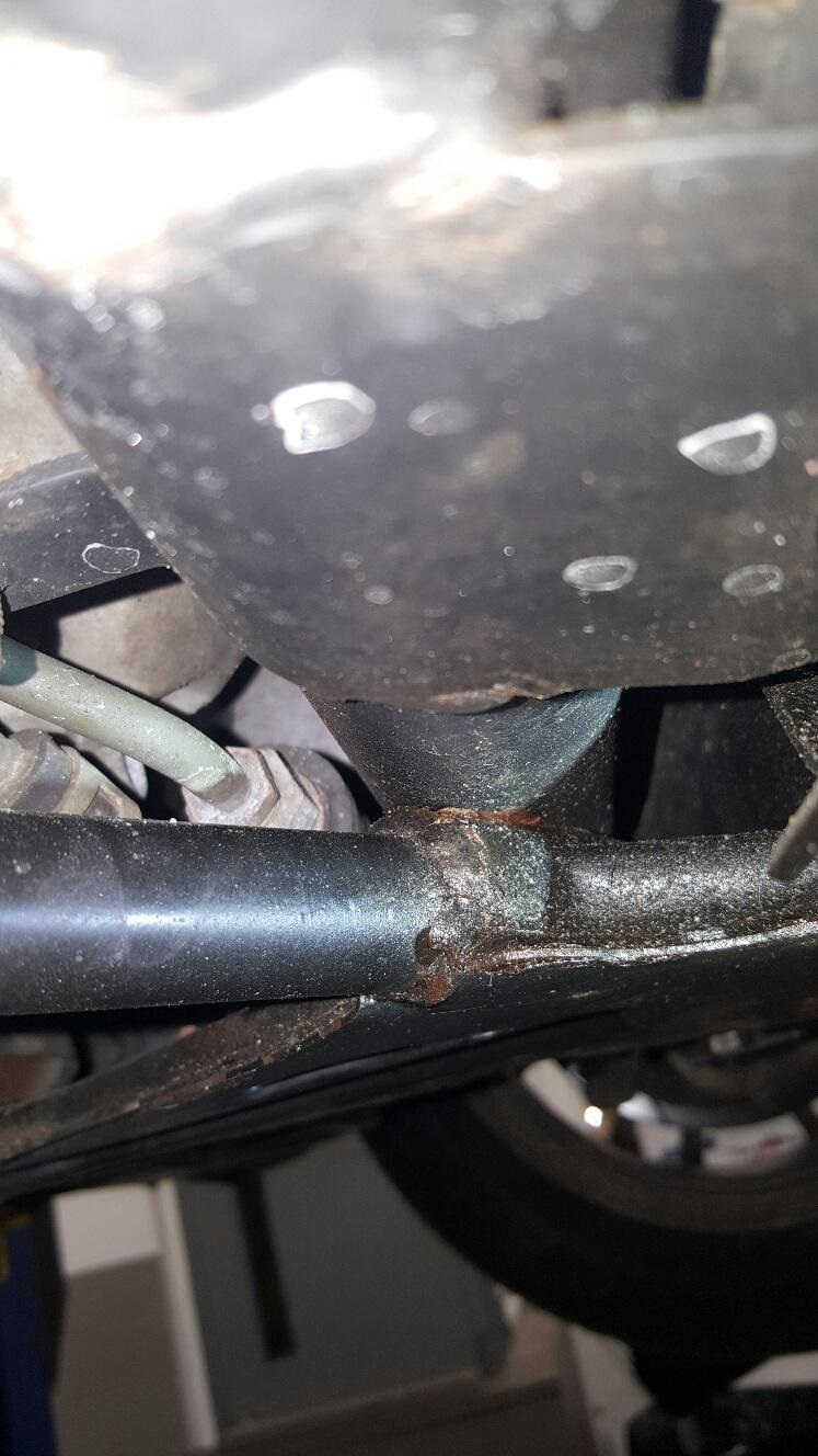

Hey Guys, I haven't removed anything as of yet, I Still have the Stillen headers on the car. I'm thinking going forward , what happens when the mounts settle if wear a bit and it starts touching again? I want to be sure the drivers side is correct and wont touch, It's shouldn't have touch with the stock mounts and they were in very good shape. The only reason the Z1's work is we have them adjusted one side up the other down to create enough space so it wont hit :/.
Right now I'm dealing with the alignment I got done 10 days ago that has the rack sitting on the sub frame :/

What caused the steering rack to hit the subframe? did one of the steering rack mounts fail?

Don't know yet, cars at Motive again.
All I know is i went in( NTB) for alignment and 2 days later I notices a knock in the front end.

So the rack was a dumb loose bolt, DAMN dealer wouldn't even check them.
Motive fixed in in like 10 mins!! An cleaned all the OIL the dealer spilled everywhere!!! Don't think I'm going back to that dealer of my oil changes, there was like a 1/4 qrt all over the place!!

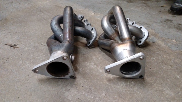

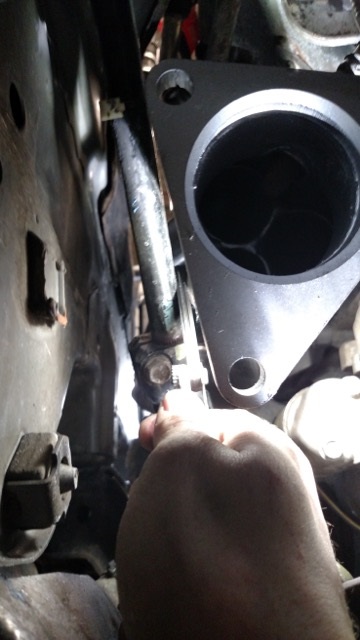

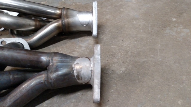

I don't have be pics and measurments yet but the shop said the header was DRASTICLY different, there is much more space away from the steering shaft, Like double!! the two pics he showed me on his phone you could tell the header that came off the car was bent and the flange was even clocked in a differnt manner. I'll have pics sometime Monday from him
Old Feb 24, 2016 | 12:46 PM
  #89
ANMVQ's Avatar
ANMVQ
Joined: Dec 2009
Posts: 6,098
Likes: 396
From: Framingham Ma,

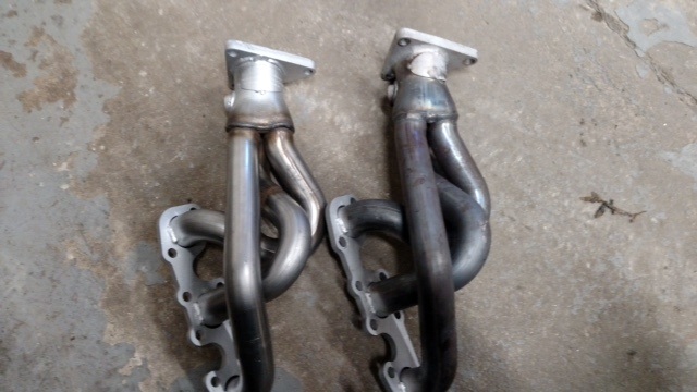

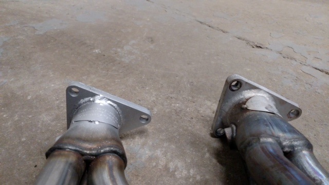

So I have the pics and measurements to show the header I had was defective( Yes Stillen agreed)
The old space was 4.220mm now with the new header installed is 6.8MM. You can see by the pics that the old headers collector has a different size and the placement of the the flange was even clocked in a different direction :/, width of the flange looks thicker too. The overall size/ length looks different also, The length thing may be correct as a caught a look at my exhaust tips the other day and I could have swore the drivers side looked tucked on more( Shorter)? this is because the new header looks to be shorter than the old one. I know they hand make these but gess!!

geeze.. their hack quality strikes again..
really sucks cause i can get a discount on their brand..
