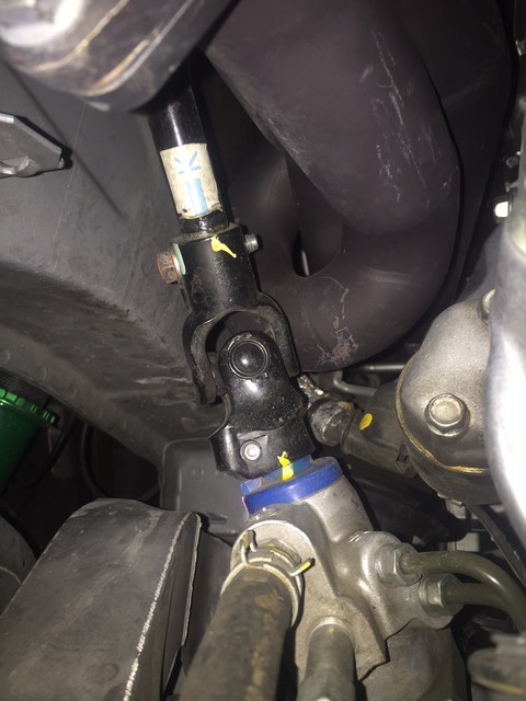

I have less clearance than that between my headers and steering shaft
Originally Posted by ANMVQ
Oh sorry man didn't mean when turning the wheel all the way I meant "hard" as in body roll high MPH like taking the off ramp at 65-70 mph I turn right the body leans left and I can feel the motor vibrate through the steering wheel. I looked user the car today at the alignment shop and there's only like a half of inch of clearance between the headers and the steering shaft

its a tight fit but i have 0 issues..

I Just took pics to I can see where it's rubbing on the shaft. Everything was tight maybe I need new motor motors my cars got almost 86k ? I've also sent pics to Stillen ) talked to them this morning ).
Yours looks there more room on yours than mine tho?

there is barley any room next to the shaft and header.. ill see if i can get a closer pic of it when i get home..
but even when my motor mounts where collapsed i still didn't any have issue with clearance
