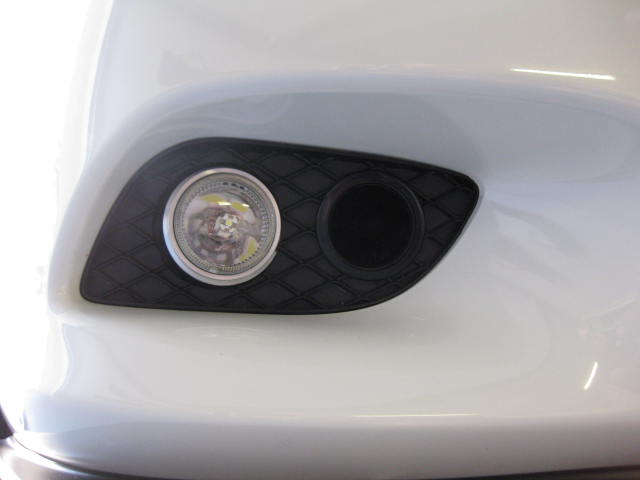

[quote=Q8y_drifter;2955700]Actually the sides are sealed off to divert air towards the radiator and P/S cooler. take a look into the lower grille in the middle and look inside towards the left and right side. There's a plastic piece on each side that blocks air from entering the sides, since there's nothing to cool anyway. I actually took them off, redyno'd and made another 4whp. That's before I even drilled holes into the fake mesh on the journey bumper. I dunno how accurate that is but I made several runs before and after and that was the difference between each average. I have the Injen CAI btw.
EDIT: Look at the pics voltic posted on post #18. The first pic shows the 2 plastic i dunno what you call them on each side. When the bumper is reinstalled, those pieces block a lot of the air that is meant to go thru from the bottom center grille.[/quote
True that!! Thanks for posting this... it was my experence too

yogregb, that looks really clean! great job. I didn't do much to mine as the journey bumper I have is only a temp until I get a sport bumper. I simply drilled out all the fake holes with a 6mm drill tip and removed those plastic pieces. I was planning on doing the same thing you did with the sport bumper and add fine mesh from the inside to protect it from debris.
