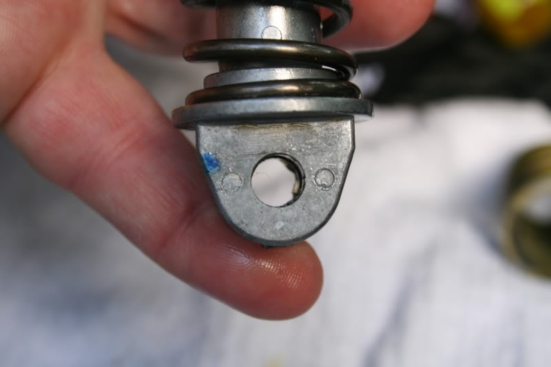

Done. Took about 10-15 minutes to install and definitely makes a HUGE difference!! I still can't fully feel the engagement points when shifting but I am shifting so much smoother now so I'm very happy with the product. Definitely worth the $20 spent.
One question I have though are the 2 indent impressions shown here:
Do they really have to be facing to the right towards the clutch pedal? I don't remember which way it was facing when I took it apart and realized that they are now facing left (away from the clutch pedal) but I read on some posts that they should be facing right? Does it affect the setup or anything when facing right?
Thank you Jsolo for the fast shipping and great product!!
Do they really have to be facing to the right towards the clutch pedal?...
Unless that whole end is not centered on the axis of the spring, or the eye hole is tapered, it wouldn't make the slightest bit of difference.
EDIT: OK, I see what's going on. The OP referred to those dots being significant in post#86, but that was only for the BOTTOM clevis mounting point, since there are two holes and they are slightly different diameters (or essentially like a taper). On the top mount, those dots, which are simply casting marks, should be irrelevant.

@sLADe781, on my own car, I found that when the dimpled side was facing towards the driver door, removal of the pin required more effort. I doubt it's tapered, but the hole may be machined differently. No idea if this applies to the top clevis. I swore never to touch it again after losing the pin somewhere behind the fuse box then wasting hours trying to fish it out.
