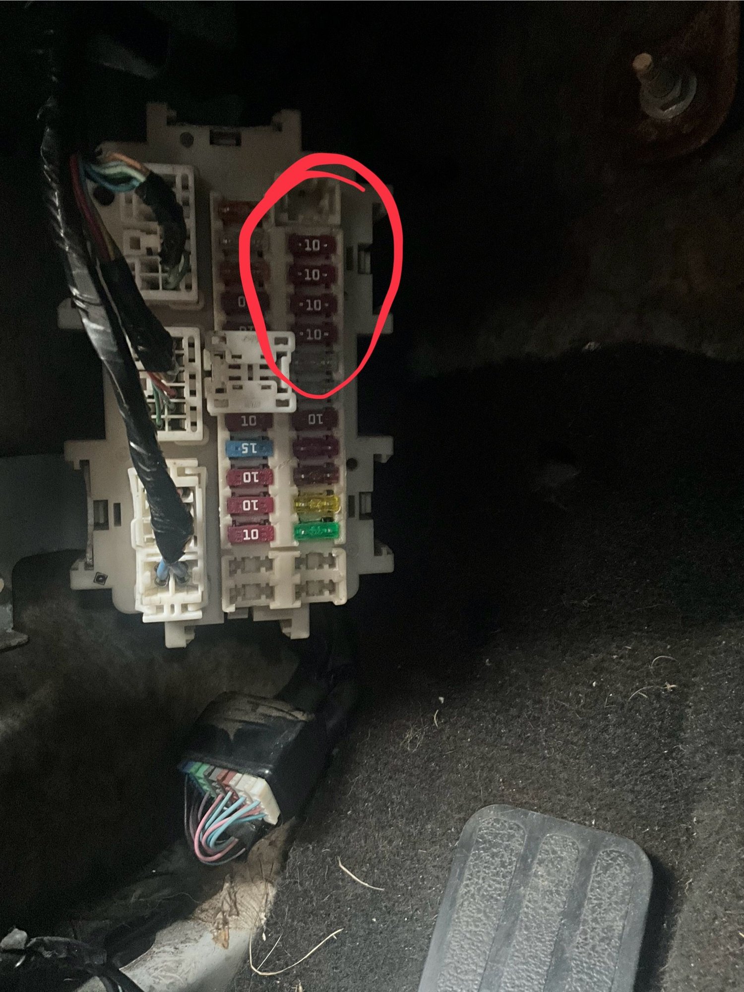

  • The top four 10A fuses on the driver-side interior fuse panel (circled in the photo) are not getting any power, even though the fuses themselves are good.

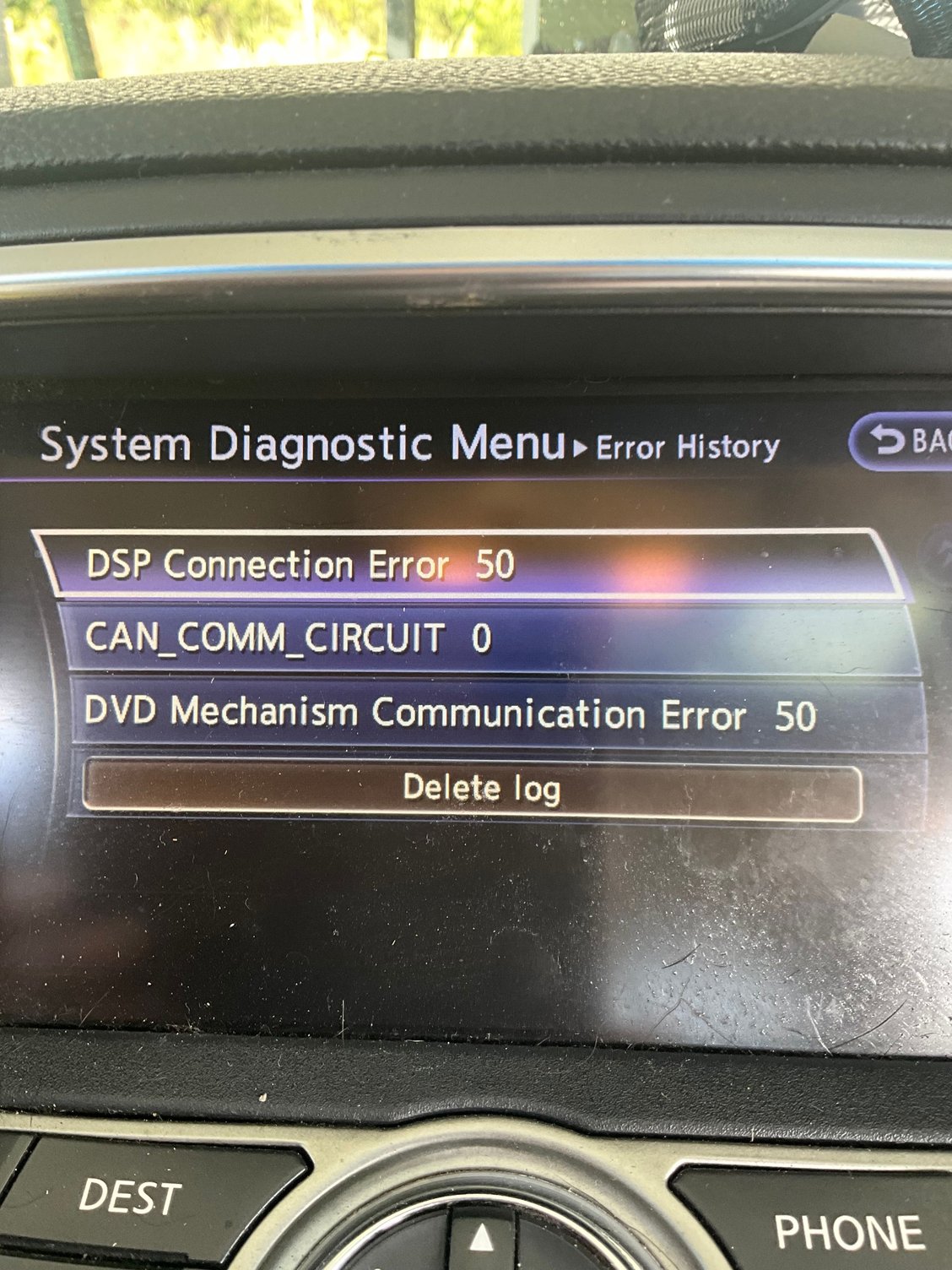

  • I ran the system diagnostic on the infotainment screen, and it came back with:
    • DSP Connection Error 50
    • CAN_COMM_CIRCUIT 0
    • DVD Mechanism Communication Error 50

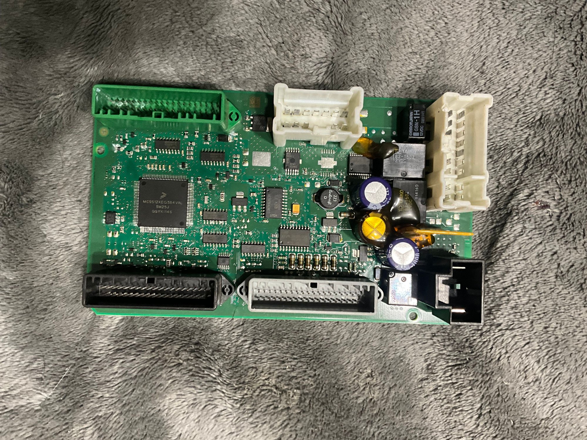

  • Pulled and inspected the BCM — no water damage found. Cleaned it and reinstalled it.

  • Verified the interior fuses themselves are good.

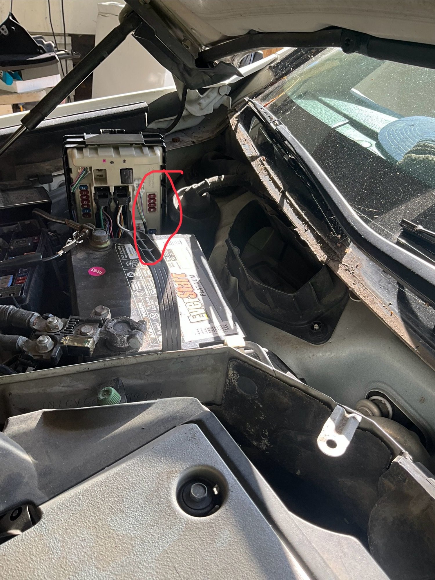

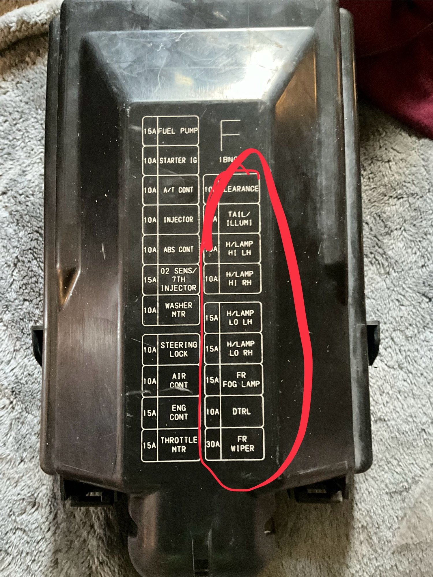

  • Also checked the fuse box beside the battery (under the hood) — and noticed that none of the fuses on the left side of that box are getting power either.
I’m starting to think the issue might be upstream, maybe a blown battery fuse link or a faulty ignition relay that’s not supplying power to those circuits.
Has anyone had something similar happen — no dash, A/C, or accessory power, plus ignition weirdness like the push start not shutting the engine off? Could a battery fuse link or IPDM fault cause all this?

Did you miss the "Fusible Link" box hanging off the + terminal of the battery? These are like the Main breakers for everything and could explain why you've lost power to 1/2 of your systems. Here's an illustration:

In either case (sedan or coupe) Fuse D on the Fusible Link is what sends power to pin-2 of your IPDM. And Fuse E sends power to fuses 5-11 of your inside fuse block...
It's not easy to test because it's all sealed up, but the fusible link has several fuses - maybe even one on the underside right next to the battery+ terminal - and you should be able to confirm that all is well just by looking closely at each of them. These are big fuses and when they go there is an obvious burnt look.
If your IPDM is not getting + voltage on Pin-2 then you're getting very close to finding the fault. Check out the manual and let us know what you find.
