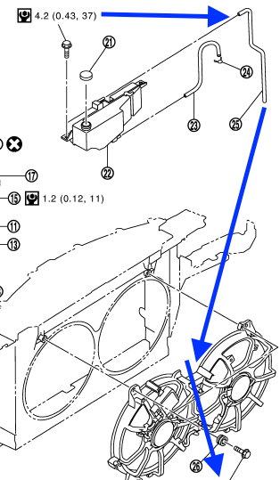

Hello, I had to replace the grille today and in doing so I had to remove the 2 bolts holding the coolant reservoir tank. After getting the grille in somehow the top hose on the tank lost its connection to where ever it connects to and I can't find it. The bottom hose connects to a nozzle next to the radiator cap but where does the top hose connect to? Can someone show me a picture to easily find this I feel very dumb and lost right now.

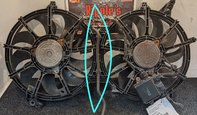

That is the overflow tube. It drains to the ground. There should be a "channel" between the two fans that this hose pops into.
Like this:

Ahhhhhh! Thank You so much! I just put the hose in place and shut the hood. I saw those clips when I was trying to figure it out and now that makes sense. Those clips are not easy to wiggle the hose into, I used a screwdriver to pry one open a bit, and in the cold weather the plastic was brittle and it snapped but I go the bottom one in and it's snug.
Thanks, again!
