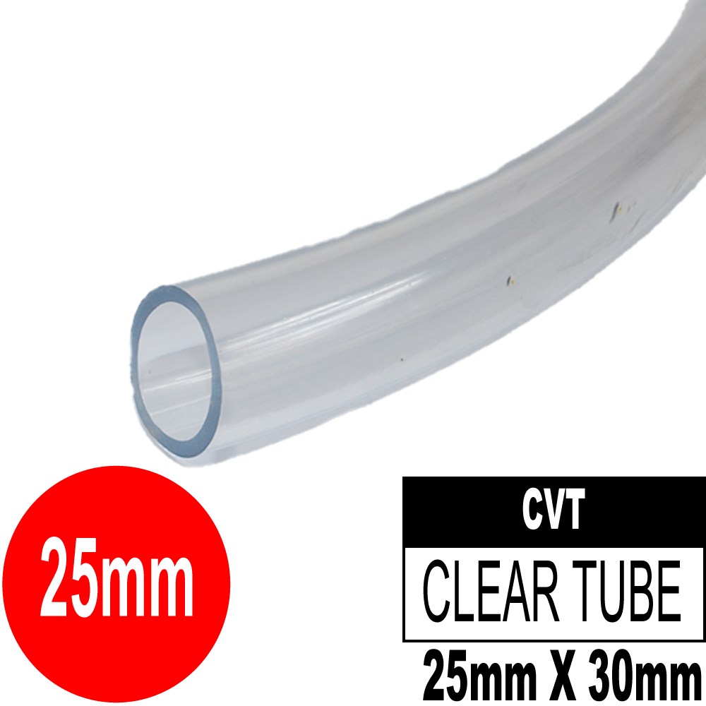

When I put the baster in, it seems to hit some kind of plastic wall about 1 inch in that's blocking it from going further.

I just used a short length of vinyl tubing slipped over the end of the baster to make an extension that I could drop down through the hole in the top of the reservoir.
