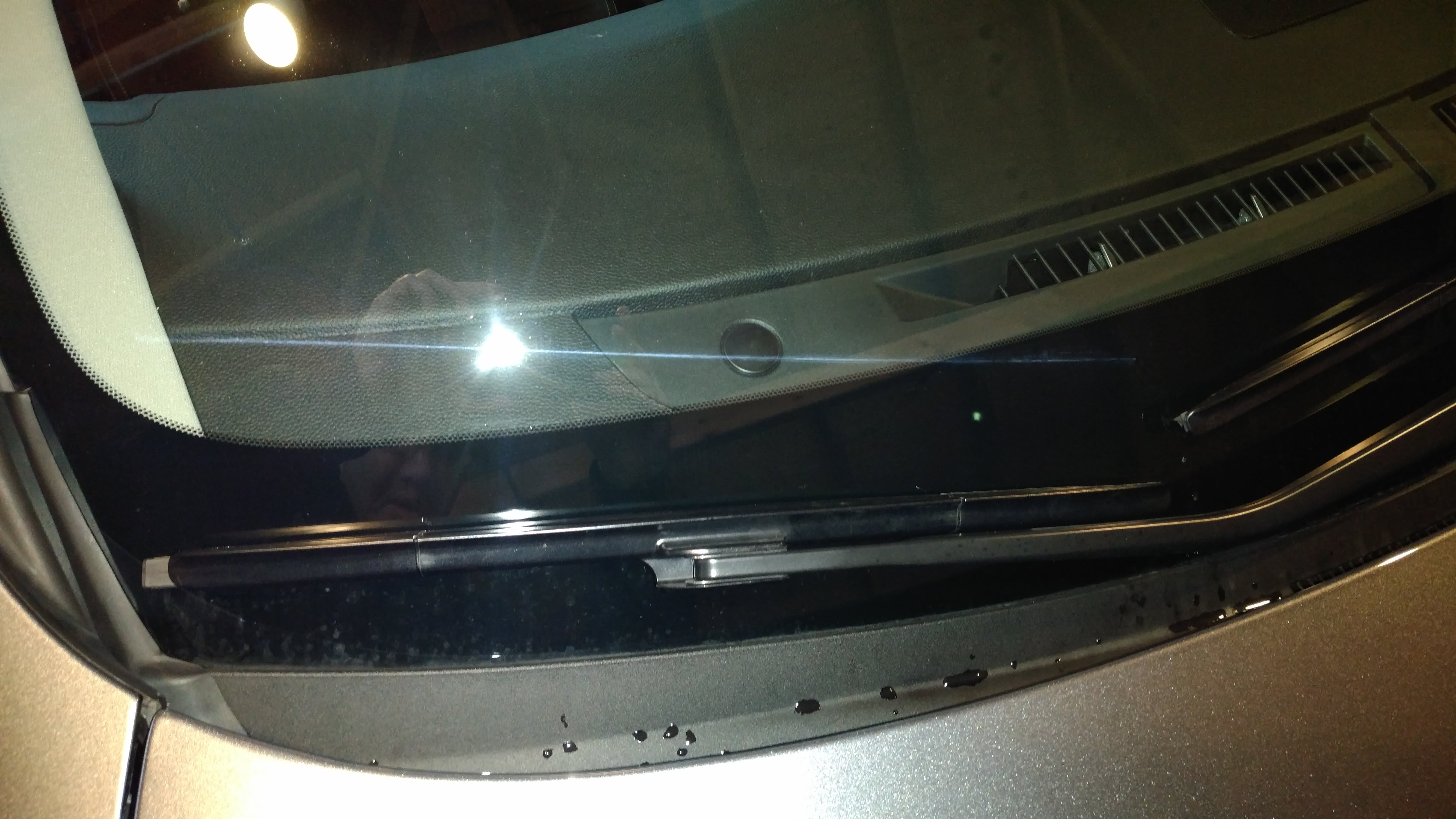

Received 28895JK65A (driver side) and 28895JK66A (pass side). Although numbers didn't match, driver side fit fine. Passenger side has the lock off by about 1/2" so it's sticking out and looks like this.
We'll see how this gets resolved. It is functional but looks tacky. The whole idea of going oem is to avoid this.

You know the really messed up part, what's stamped on the new refill is the same as what's on the old, yet the lock portion of it is in a different place, about 1/2" closer to the end.
I don't know why nissan complicates this so much. I can see a coupe possibly being different from the sedan because of different windshields, but aside from that, not sure what else could be different.
The seller did respond offering to refund for both, but that still doesn't solve this. Maybe next time I'll buy a full passenger blade from the dealer and bring both of these refills in for comparison.
Too much hassle to deal with shipping back and ordering another set. The refill spaced such that all the groove guides are used so good support. They work well without streaking or skipping.
