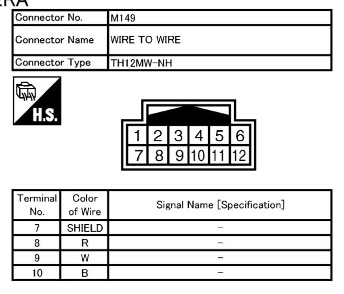

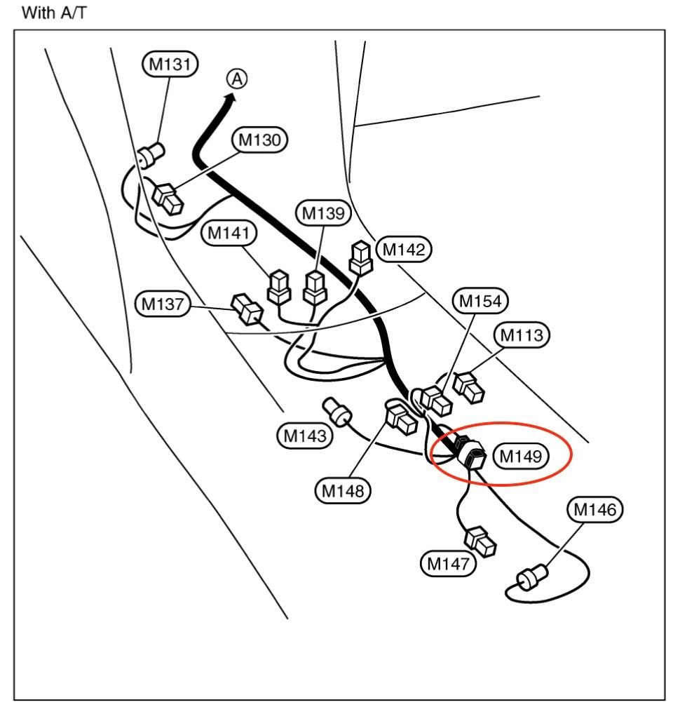

Yeah, the books are pretty hard to wade through... The wiring path from the rear camera appears to first go to the driver's side of the trunk, then crosses over to passenger's side, runs along the floor towards the front of the car, but there is a branch that turns left and runs to the center console.
There, connector B221 (from the camera) should be connected to connector M149 (which looks like it's on the passenger's side of the floor console). Even though the connector has 12 pins, it may only have 4 wires.
I hope that's the answer!

Thank you so much! That looks like it’s definitely the answer.
