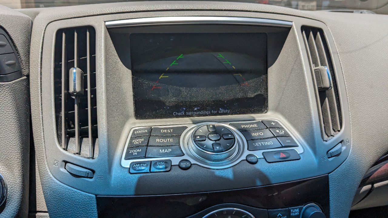

My 2010 rear camera view always appears dark--any sunlight in the cabin, and the view becomes unreadable. Has anyone else had this issue? I thought maybe the problem is the age of the technology and a newer camera would fix it? Suggestions?
In the garage--all shaded
In the sun in the driveway

I have a 2011 and it's the same. Can't see the screen in the sun

probably a problem with the camera lens

Replacing the camera or the display for something "newer" will not solve this issue. The dash design is such that the angle of the screen combined with limited overhang contributes to this glare from the sun. There is not much you can do short of adjusting the backlighting to a brighter setting. You can try any number of "anti-glare" display overlays but those results will be mixed. I bought one from Amazon a few years ago and while it helped some it is not perfect.
